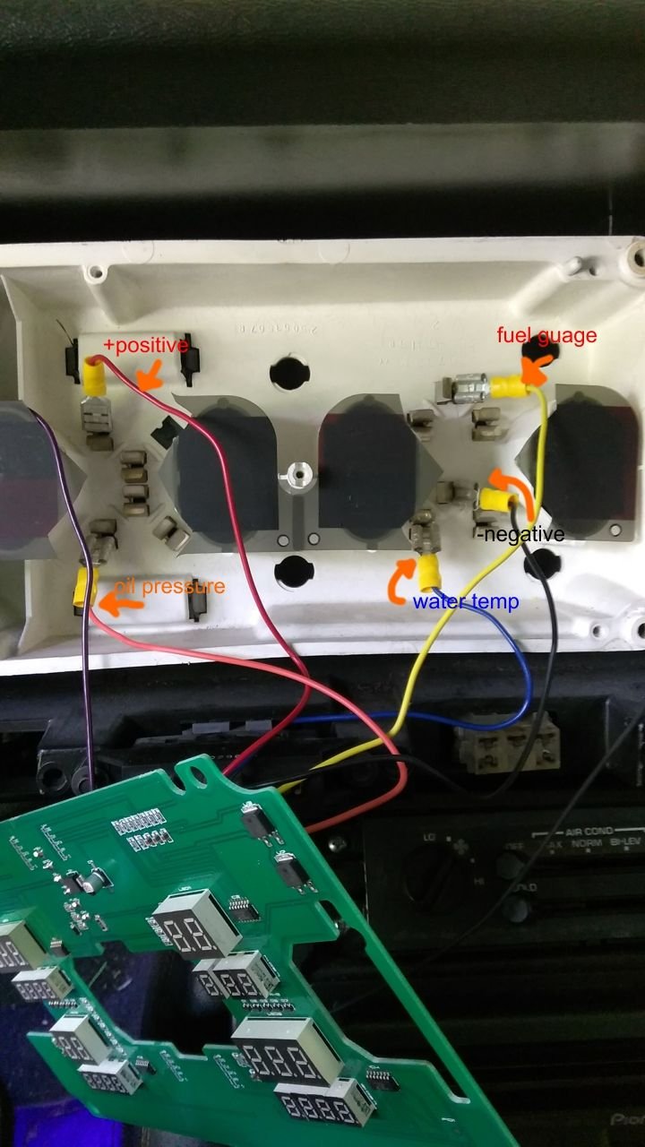

Hello everyone,
I recently installed the Intellitronix Digital Dash part # DP3001 into my 1984 trans Am. Not sure if I did something wrong but the fuel gauge does not seem to be working. It just reads "00". Right now I have a 1/2 tank. If you did one of these installs your input will be greatly appreciated. My original is broken wont read. I also went to Autozone and got a GM aftermarket fuel gauge to test. It is reading a little above empty. But I know I have at least 1/2 tank. I connected a ohm meter to the yellow post is reading 15 ohms.
Intellitronix digital dash connections on a 1984 trans am.

You have to remove fuel sender wire from that top lug and plug it into the one just to the left of it, the one you have it connected to in the picture is the gauge ground.

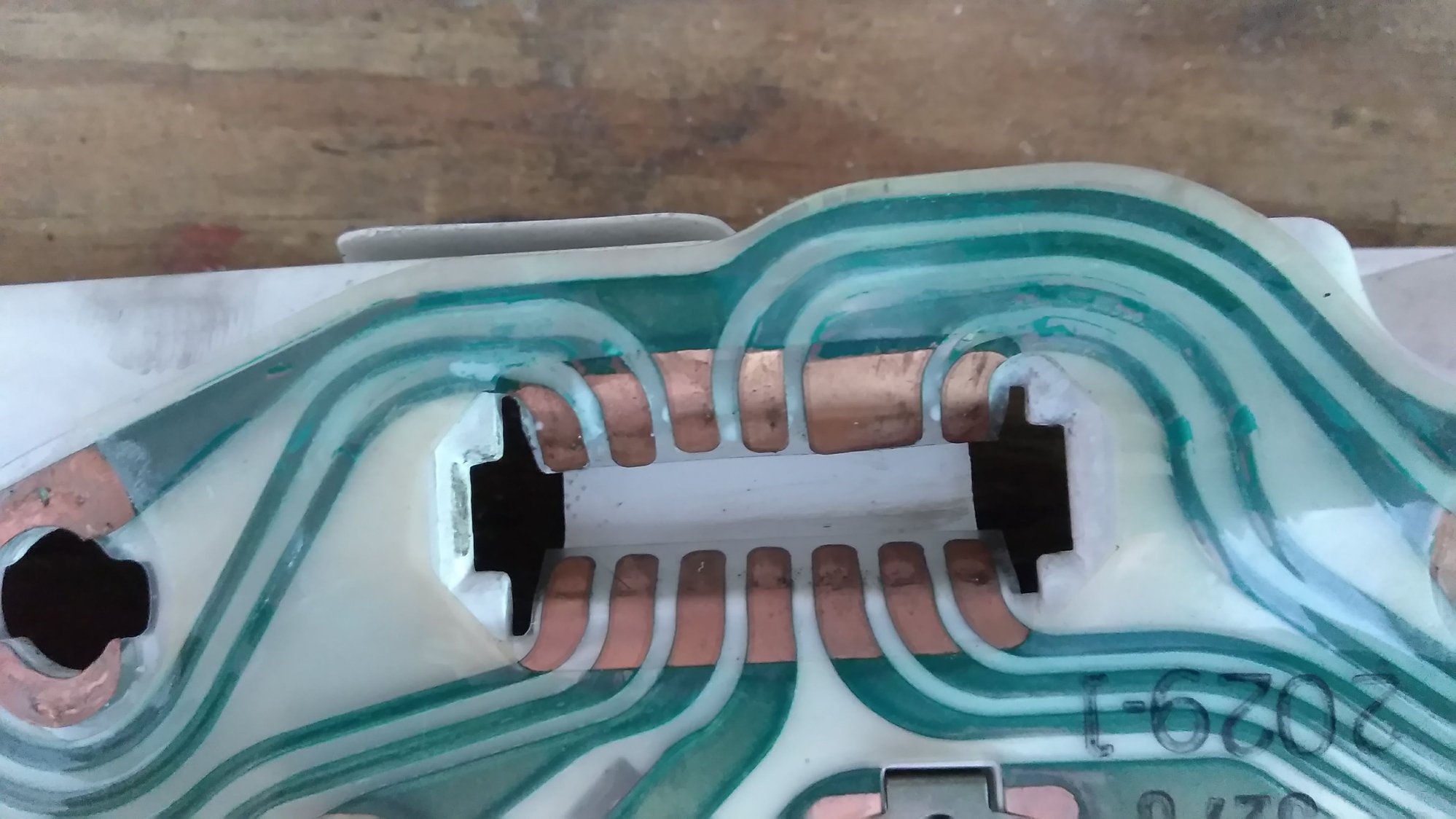

ok guys... everything is fixed an working! I moved the Yellow wire to the left post. Originally i was reading the top post for OHM reading. The top post was reading OHM's which is the reason for putting the wire there. The left post is infidelity fuel sender, top is negative - , right is + positive. I read the responses and started at the beginning to troubleshoot. I removed the gauge cluster and quickly found the contacts were not sitting correctly to the male connectors in the dash. The connections were crossed and giving a false reading. I did not take a picture of the messed up wires. See pictures as they when fixed. Thanks for all your help. I'
m so glad my fuel sender is working. got a quote for 10 hours to drop tank, rear end etc. almost a grand if bad sender.
Left digital dash - Tach, Speedo
Cluster after fix.
Working Fuel.
Right gauge all correct except Yellow (fuel) should be on left post.
