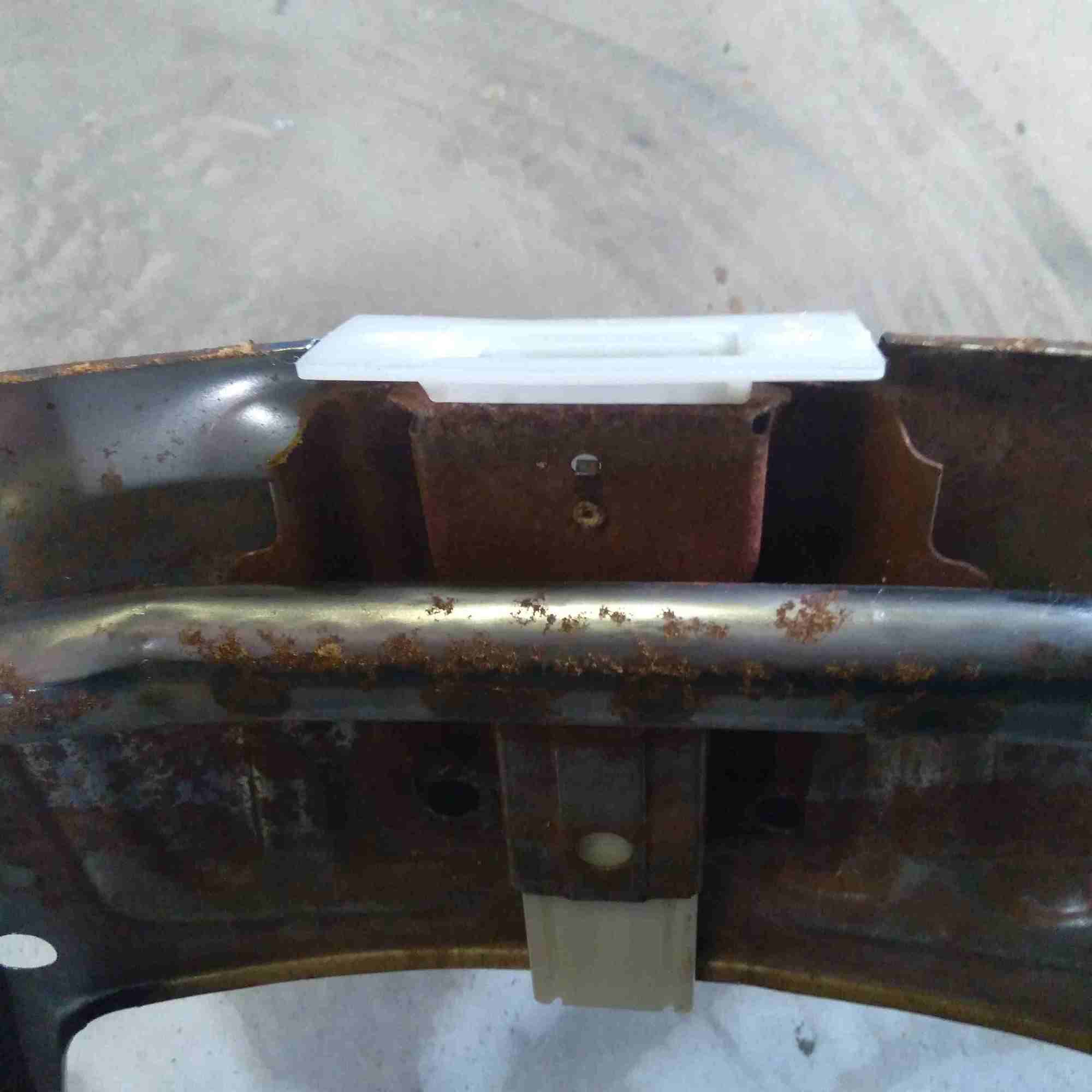

Old Sep 12, 2022 | 09:29 AM

A hacksaw blade can slip off to the side of the tab. You might have to try a couple times. I used a piece of metal strapping. I don't think the upholstery people could have damaged it. And yes you have to take the seat pan off of the foam/cover to get at the tab.

Thanks for the photo above. I take it the perspective is from the inside of the seat looking back toward the rear of the car and if so, I see where the seat foam would have to be removed to get to it.
