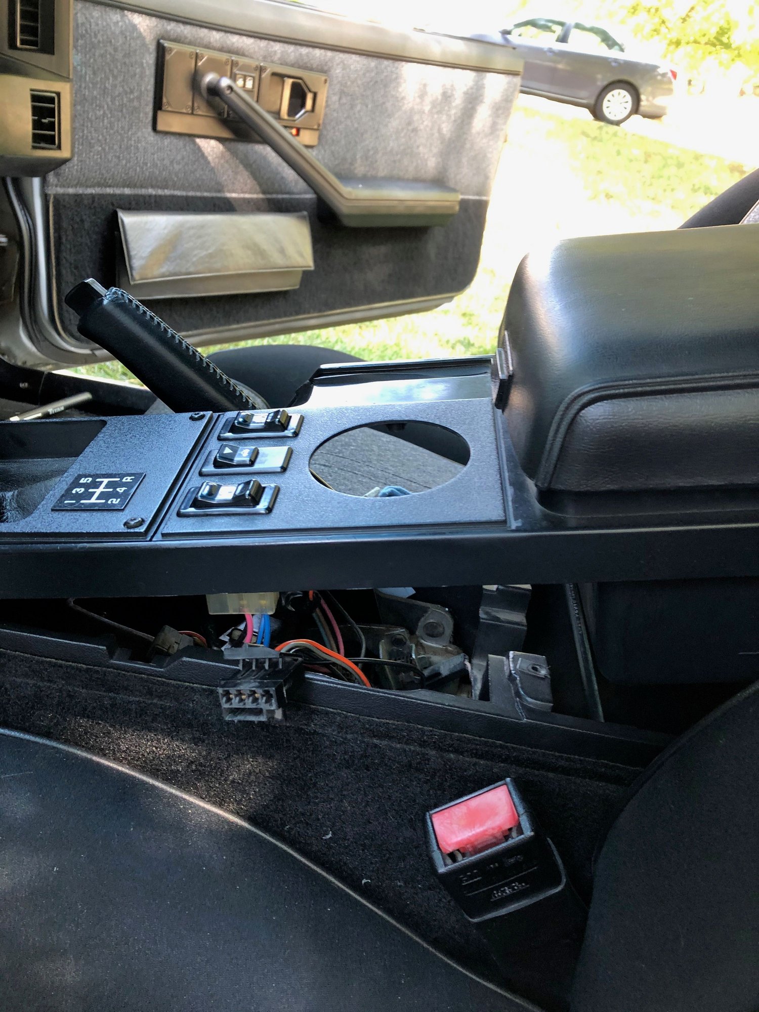

Upper console:
1. With the console lid open, remove the two storage-area fasteners with a 10mm socket.
2. Remove the two Philips screws at the front lip of the storage area.
3. Engage the parking brake to allow the upper console to be raised.
4. Lift the upper console a few inches and support it. I used a long extension.
Removing the clock:
1. Unscrew the three 7mm fasteners that secure the clock to the upper console. I strongly suggest covering the area below so that when a fastener or tool is dropped it won't be lost.
2. Slide the clock toward the shifter to free the clock's long crown (used to set the time). Then jockey the clock through the space between the upper and lower consoles. With the clock free, removing the harness is much easier.

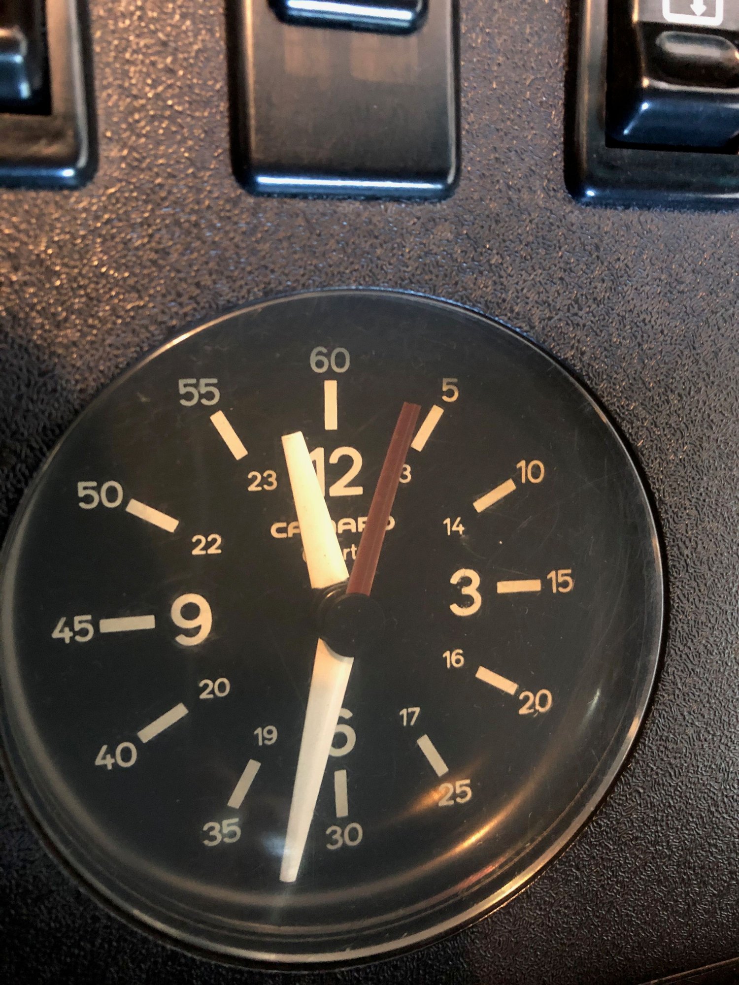

Before restoring the clock to the console, I plugged it in for a few hours to see that all was well. No issues several days later.
Considerations:
If the lens is scarred, as it probably is, now is the time to consider a polishing of some sort. (I used toothpaste this time as I went all out in 1998 with wet sanding and so on.) If the bulb(s) are burned out, replace. The hands are plastic, of course, and with age susceptible to breaking. Personally I wouldn't touch them.

The console clock is one of the coolest options IMO.Ive installed them in both my 86 and 89 irocs.I have also acquired a pretty good collection of them throughout the years and in my experience they pretty much always work although some take a bit of coaxing.Your lens looks very clear.Whats the best way to polish these?

Your lens looks very clear. What's the best way to polish these?
Years ago I used the wet sanding method with various grades of paper, a polish and a buffing wheel. Nowadays, a headlight restoration kit might be the ticket.
