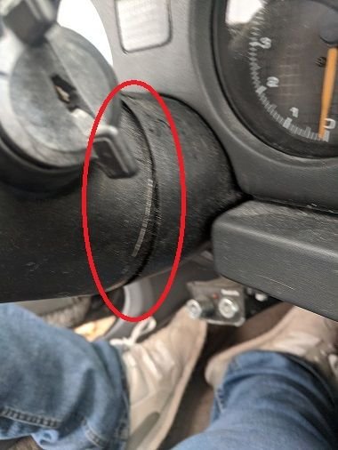

Took my Formula 350 on nice 2 hour round trip today, it was GREAT!! Howver as I came home I noticed my steering column is loose. Right where the adjustable steering joint is. See pic below. Anyway I can grab the steering wheel and make it move around freely in any direction, and its getting a bit worse when I play with it. Something is either loose or worn out. Before I tear it down just wanted some input. I have rebuilt this same column back in 1990 but I dont remember all the parts, etc. thanks.
The red circle is the area where its loose.

So this is called the steering wheel wobble. I just order a pin pulling tool so I can get in there and tighten the 4 bolts. Found info here and in a google search.

Yes, common problem and not that hard to fix. It's been a while since I've done one as well, but if I recall correctly, the only special tools you need are a steering wheel puller, lock ring compressor and pivot pin puller. Use some locktite on the 4 bolts so they don't back out again.

Well its pretty much done. The big connector at the bottom of the column got wedged up and i have to pull it out. But the wobbling has been fixed. used Red loctite. My 4 screws were mail torx, not female torx. I had 3/8" sockets but it was to wide to fit. So I used a small 1/4" hex socket and that did the trick.
I noticed I dont have the black plastic cover that go over the metal lock ring. Do I need that and if so anyone have one? thanks

Holy crap, there is no need for red on this. Purple, Blue, or even Green would have sufficed.

I agree , since red needs heat to release it for removal , and it'd be pretty hard to heat these bolts given their location , it's together forever now ....
