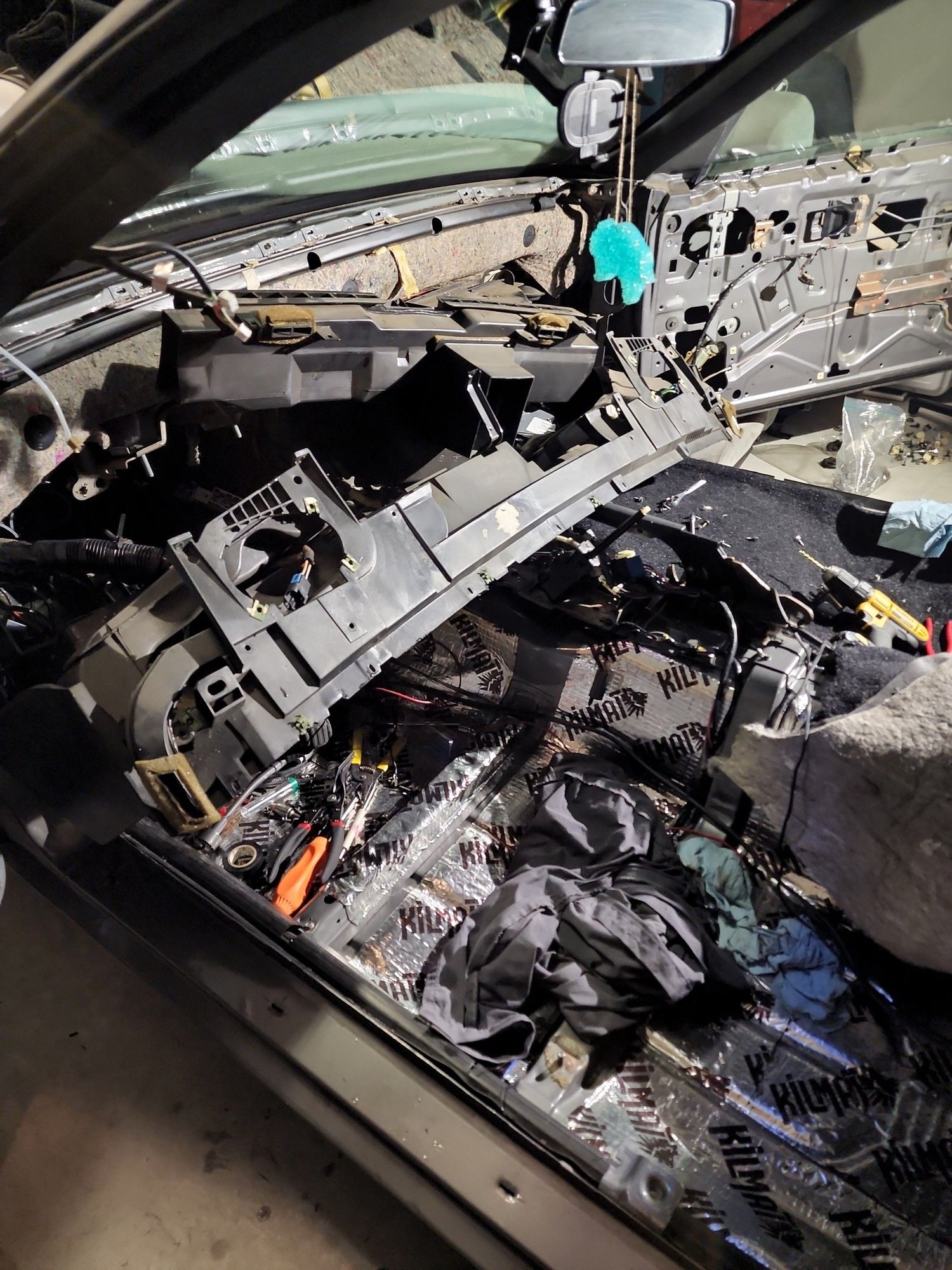

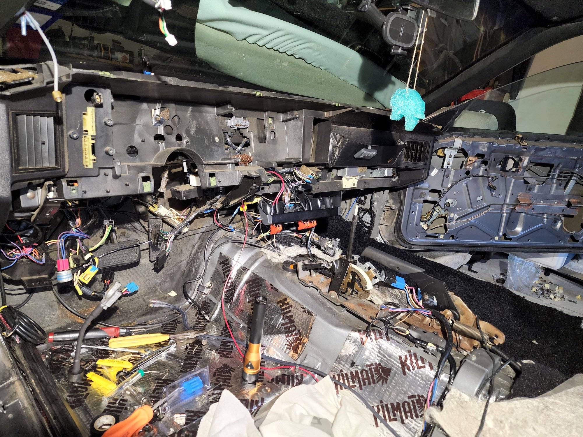

Maybe I'm spoiled...
I have been a professional automotive technician for 22 years. I worked for GM dealerships and have been with Mopar the last decade. All the vehicles I have worked on, the dashes come apart as an entire unit and have large connectors to separate the dash wiring that snakes through the dash frame from the rest of the body harness so you can pull the entire thing out. The steering columns are simple, and easy to take apart and replace. Window regulators are also smooth in operation and in removal and replacement.
Our cars are the absolute opposite. I fought putting the dash back in for hours and ended up cutting the right side rear speaker wire in order to separate the harness on at LEAST the right side so I can snake the wiring in between the dash frame and HVAC box that has to be bolted up to the dash before putting it in. I have massive bear paws for hands and they do NOT lend themselves well to these types of jobs...
I went to rebuild my steering column as well as I have worn pivot pins and I have the column from my 1992 Convertible Firebird I parted out years ago. So I was going to take them both apart and make one good column from two broken ones. (the 1992 column had broken ignition lock and plastic from an attempted vehicle theft but has good pivot pins) and I just CANNOT get the damn high beam switch to work properly... I suspect the rod is not bent properly and I am tweaking it trying to get it to work adequately when it is all assembled. But that requires me to disassemble it and reassemble it partially every time I try it...
This is the part of these cars I DESPISE.
I'd love to find some sort of aftermarket column that fits our cars correctly. I already have VATS bypassed (Aftermarket ECM and Starter relay bypassed) so I literally have no need to run the OE steering column.
