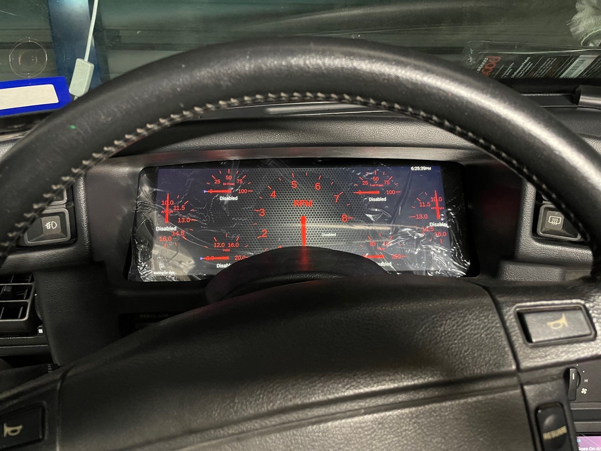

I've got a beautiful, 28,200 mile, 1987 IROC that I'm currently LS7/570, Tremec T56 Magnum F swapping along with a Holley Dominator and a Holley 12.3" ProDash. This is not my first swap as I did almost the exact same thing with my 1991 Foxbody Mustang coupe. The coupe got a LS376/480 and a regular, non-F body T56 Magnum. I had to do a lot of fabrication to mount the 12.3" ProDash and it turned out wonderful. I love the 12.3 ProDash so much in my Fox coupe that I knew I had to have one for my IROC. Here is a picture of it in my Fox:
The plastic protective wrap was still on the ProDash in this picture.
The plastic protective wrap was still on the ProDash in this picture and it wasn't yet connected to the Dominator.

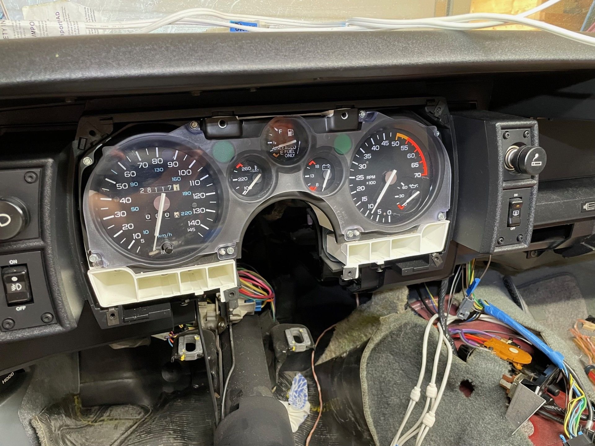

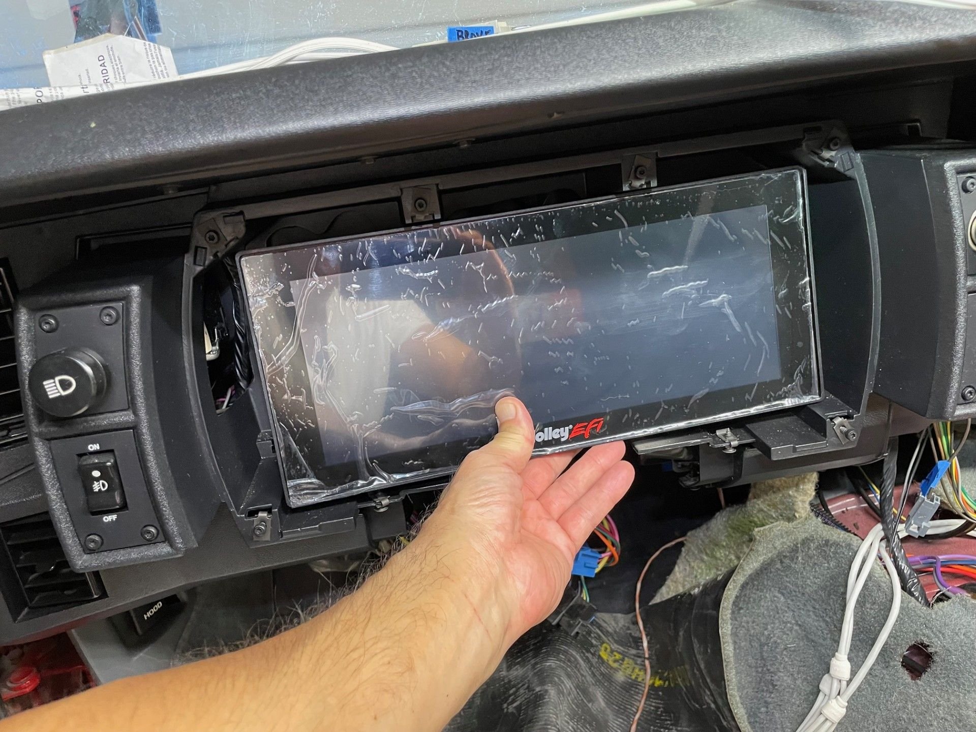

Here are a couple of pictures of my car's dash with the instrument cluster removed:
This big,12.3
This big,12.3" ProDash will have to be raised up and the steering column dropped down to physically fit. You can see plastic dash tabs that the PD's top is touching. I could very carefully cut them and move the digital screen up at least 1/2".
So again, my question is are the later model plastic dashes different from my 1987? Maybe there is a lot more clearance with a 90-92 dash.

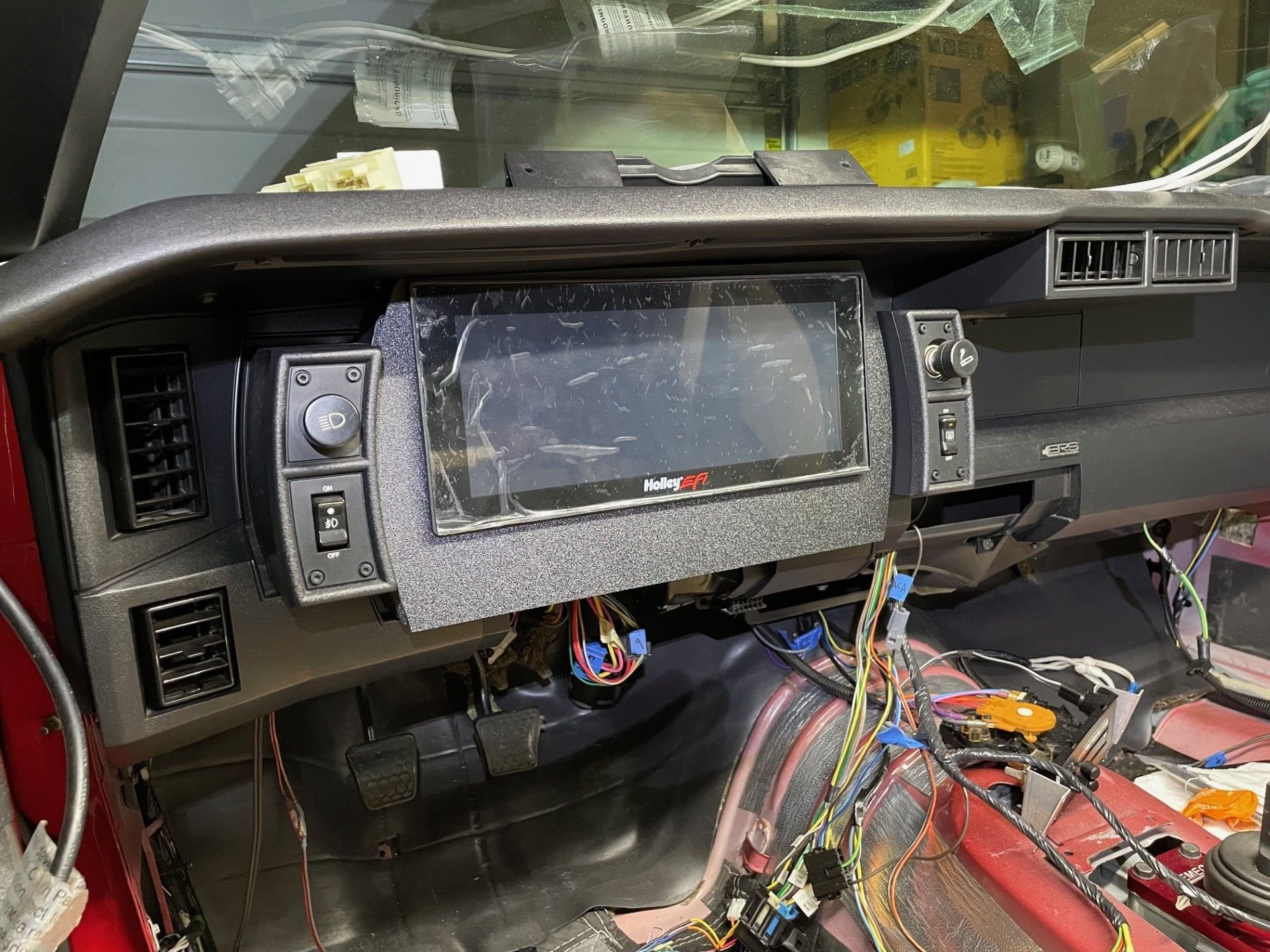

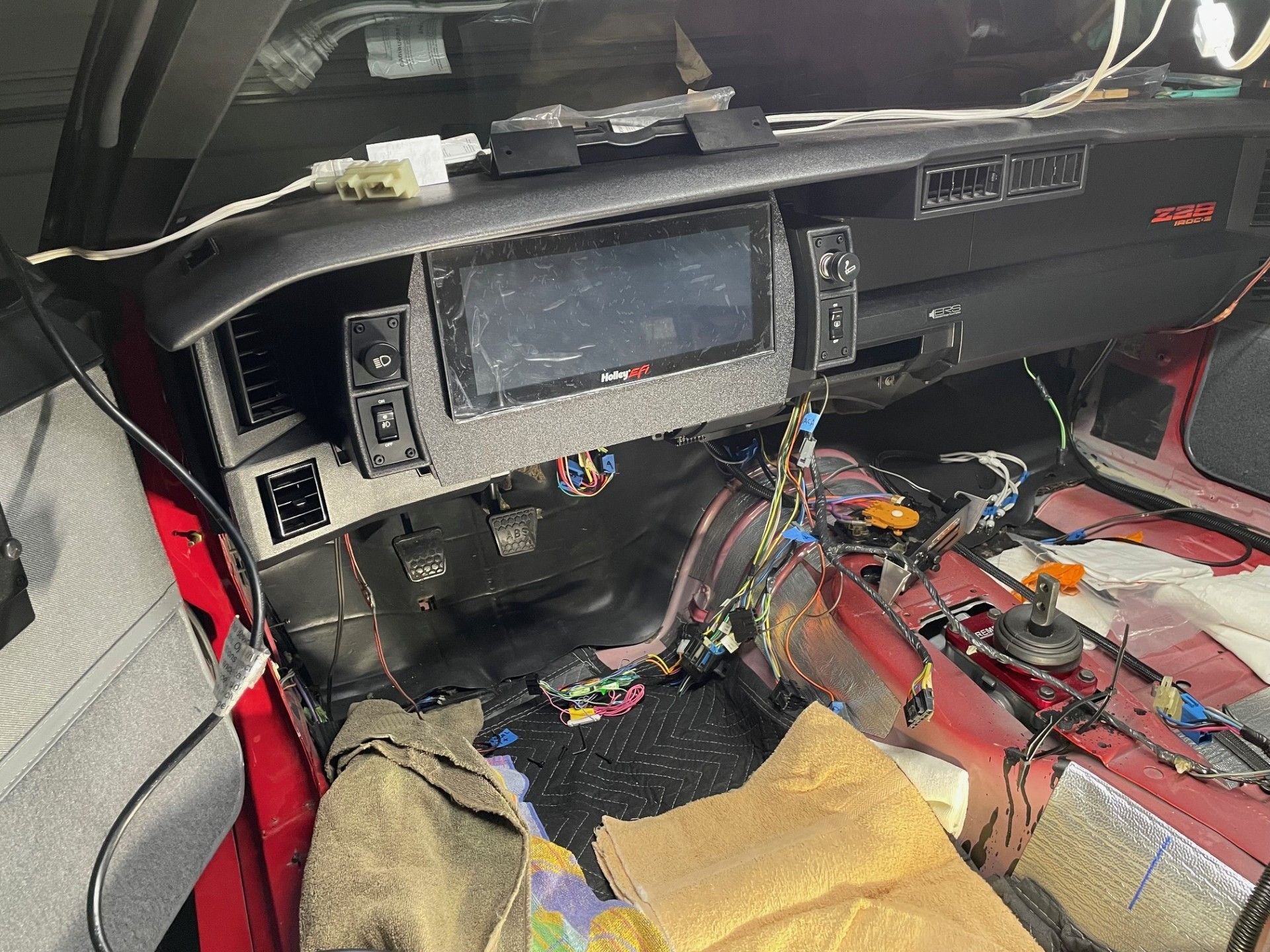

I've spent a good part of the last 3 days working on trying to get my ProDash into this earlier model, 3rd gen dash. A ton of work and I'm not real happy with the look.

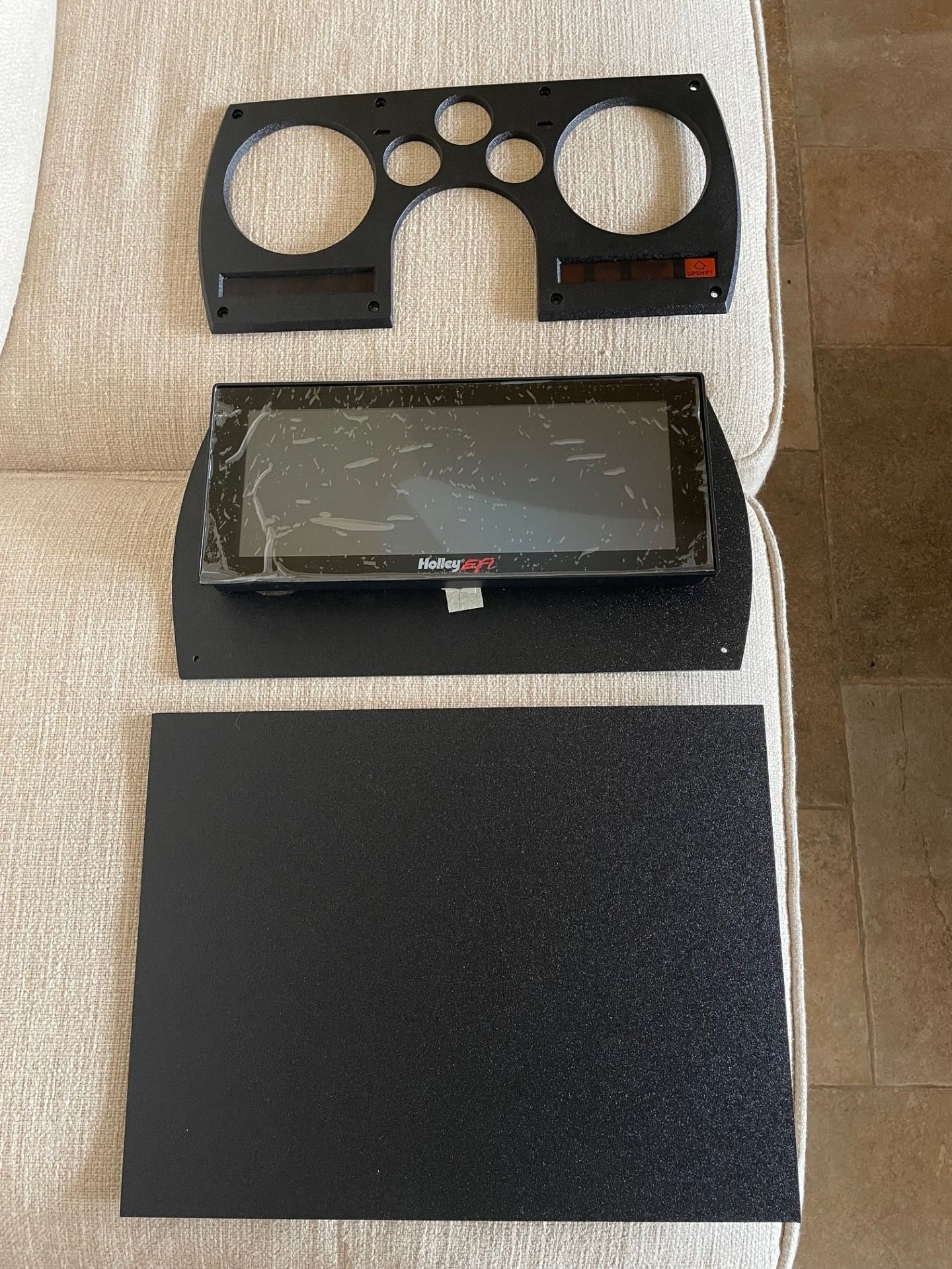

Bought some textured, 1/8
Bought some textured, 1/8" thick ABS plastic from Amazon. Inexpensive, looks good, and easy to work with. You can see that one of the pieces is already cut out to the proper shape and is under the ProDash. This piece of ABS mounts the ProDash to the dashboard. I call it the inner piece.
Here is a picture of the outer ABS piece.  The plastic is black but it looks grey in the picture.
Here is a picture of the outer ABS piece. The plastic is black but it looks grey in the picture. You can see that I've got the ProDash up about as high as possible without cutting into the dash pad area.
Another picture and it still looks grey.
Obviously I've still got to cut out the portion where the steering column will go. I just wanted to see if this had a chance of working and it does. That being said, I'm not super happy with it. My wife thinks that I should just procede with the work and get everything installed and see how I like it with the steering column in place.
Without an OEM bezel around the Holley ProDash, the look just isn't what I'm looking for. If you look back at my first post with the picture of the ProDash in my Foxbody Mustang coupe, you can see how the Ford OEM instrument cluster bezel really makes it look like a factory installation.

Honestly, what you've got so far doesn't look too bad to me. Due to how the earlier dash and bezel is done, I don't think you can make it much cleaner without swapping to the later dash.
The later dash has smoother contours and looks more modern anyway.
