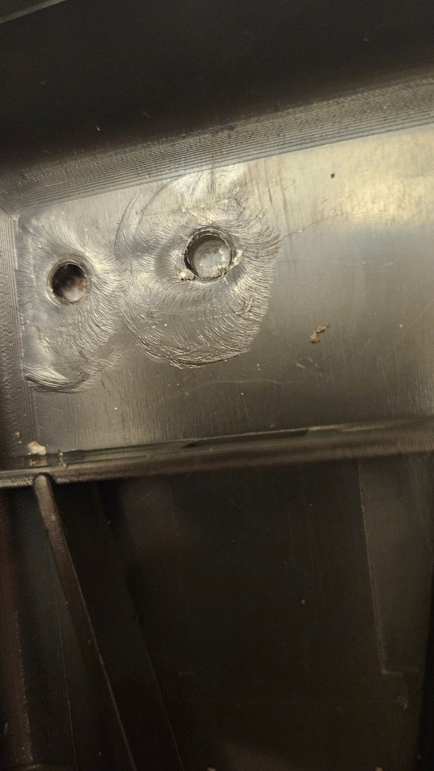

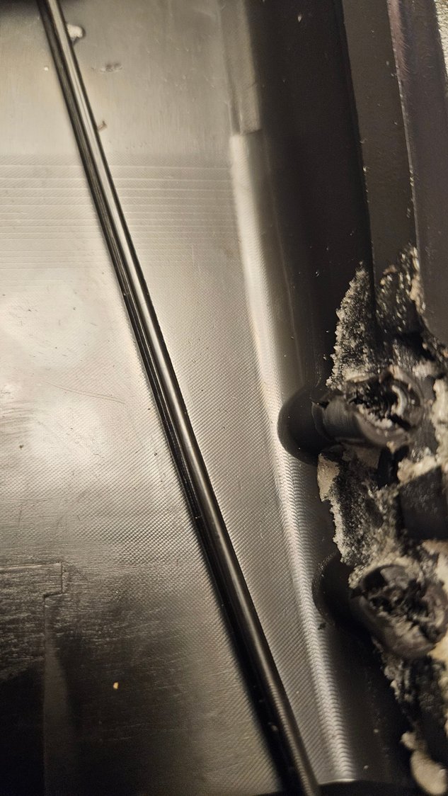

I installed the lid from Classic Industries this Winter and it is really poorly made. The spring arm is held in with two pop rivets and pulled out and the hinge screws broke the plastic. It seems all the materials are very brittle. I ended up creating new hinge mounting points with an entire tube of two part epoxy where the original screws were. I made two rectangular molds around the area and filled them with epoxy. I am not going to use the spring and arm and will use a magnet to keep it closed. The spring produces too much force and there is no reinforcement to handle the forces.
Hinge mounting point
spring arm
spring arm

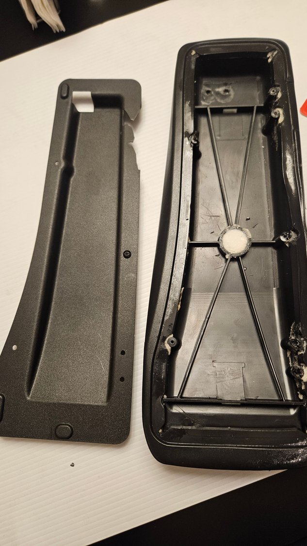

Just take the inner cover off and pour some epoxy around the screw mounting studs to reinforce them and don't connect the spring. I added a magnet to the bottom of the lid and a metal plate from Amazon on the top of the console.
Amazon Amazon
Keeps it from bouncing around
