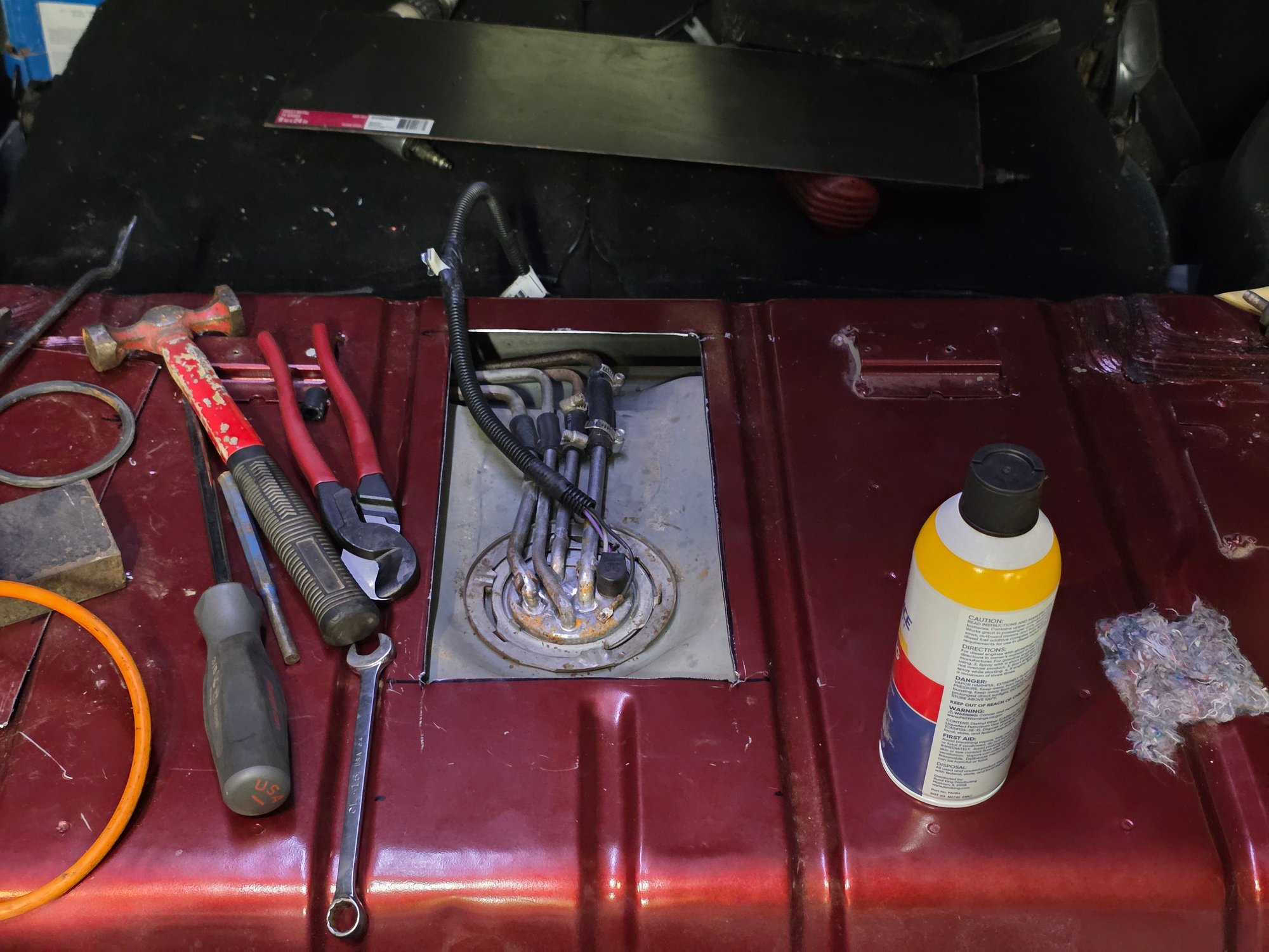

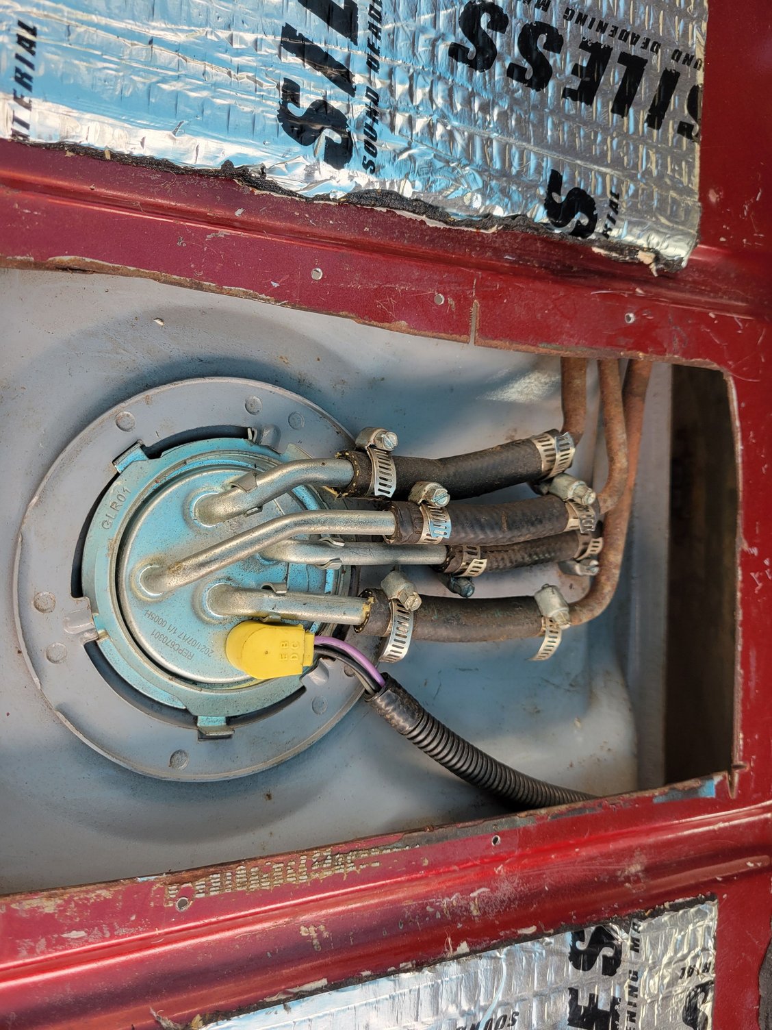

Here's a hole that I recently cut:

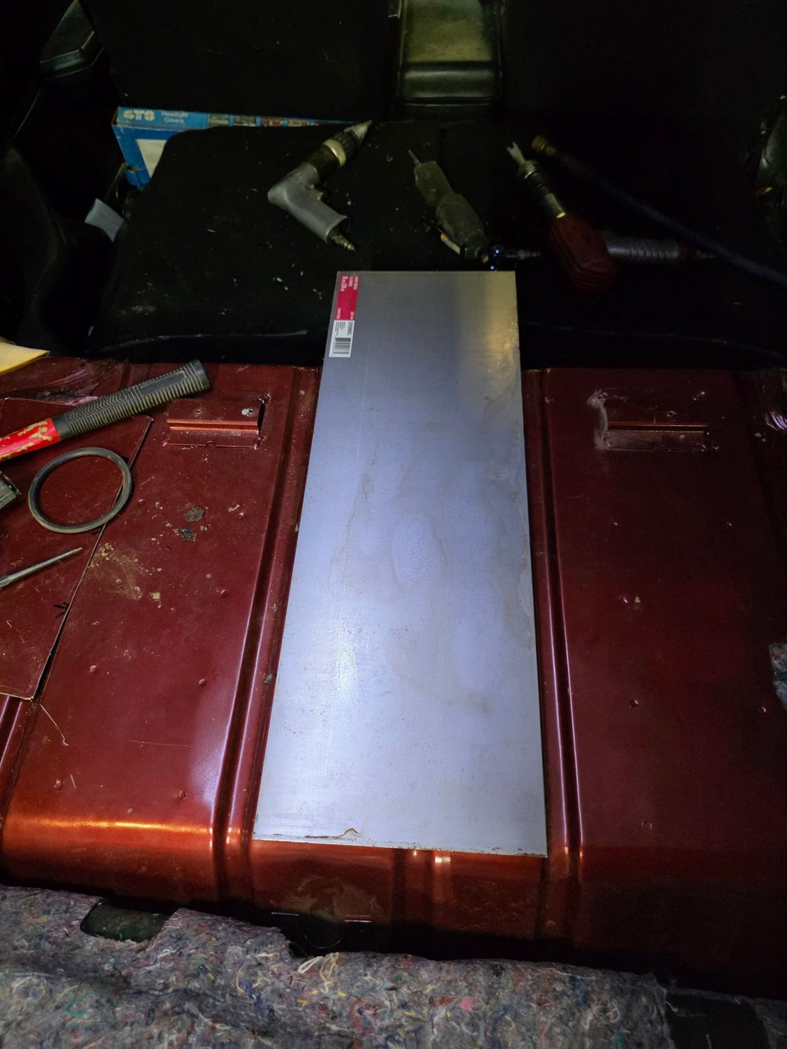

It will get covered with this:
That panel was purchased from my local hardware store. It's just 16ga sheet steel and that's the size it was purchased in. It only needs cut shorter.
To attach it, I will NOT use self tapping screws. I will drill holes and use j-clips (aka blind nuts) in the body, with short, blunt-tipped button headed bolts to hold the panel down. Blunt tips are needed so the tank won't likely be punctured by them in a bad wreck. And there will be a thin, closed cell foam gasket applied to the cover.
