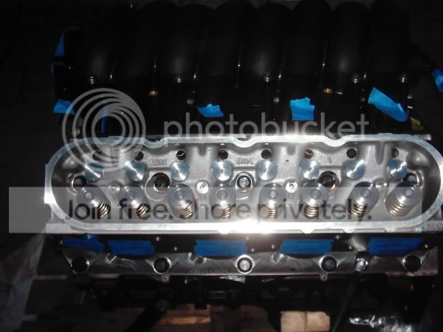

I started out by cleaning, inspecting, and prepping the short block for my new, shiny, super pimp, L92 heads. The Cometics I chose are 4.030 x .030 to give me ~9.6:1 SCR and a DCR of ~8.3 with the LS7 cam advanced 4*(depends on if i get an adjustable timing set). I decided to stick with the stock lifters for the time being as I am not going to rev the **** out of this setup. In the future the Katech CTS-V.R lifters will be used because they are good to over 8500 RPM. The valve train setup still needs to be completed.. Go figure that advances in the internal combustion engine make certain tools obsolete.. more importantly… spring compressors. I had to buy a new compressor because the offset rockers will not allow safe use of the Crane compressor. Oh well, huh?
Here’s a picture of the heads torqued down in their new home(85ft/lbs for the big bolts, 29ft/lbs for the small bolts):

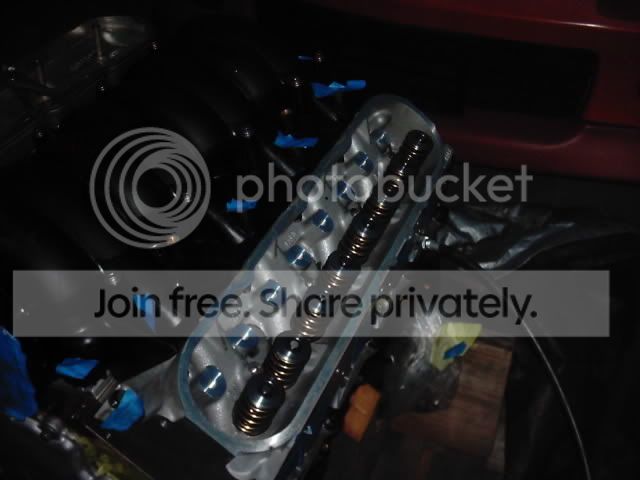

o look, an update:
i finally finished off installing the springs and such. it got a little too dark and chilly to find a way to put the cam in. heres a couple pictures.
