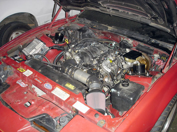

Just wondering if anyone had put their pcm here (see photos below)? I am thinking that I'll need a heat/splash shield to protect it from any spray/debris from the serp belt. I know the pcm can live under the hood, in the 4th gen it live right where my HVAC system sits, so that shouldn't be too much of a problem.
The reason I even thoought to put it here is that I was going to put it in the spot where the evap canister was (the battery location on Camaros). However, when we laid the wire harness on the motor the harness reached all the way up to the coolant tank (amazingly!!!), so I said "What if????".
So, anyone done this or will this cause me unimaginable headaches. BTW, this also eliminates the need to do ~90 wire extentions, 180 splices in total, which will cut down on labor time dramatically.

I got mine to fit in the stock location with a stock length painless harness

I'm using the stock ls1 harness and will be adding in the needed 3rd gen wires/connectors as needed. The stock fender pass through only has 40 something wires going through it, so the close to 90 wires needed for the pcm don't have a weather-proof way to get to the stock location, otherwise that's where I'd put it.

I fabricated a new grommet to seal it up, did some other changes to make it look right. to be honest , I have seen a few ecm's mounted where you did yours and i think it would be more in the way then anything.

they sure charge alot for harnesses don't they. i put mine under the dash as well.

Another vote for under the dash. I had mine pretty close to where you are talking about but more up on the fender. Looked horrible, best to take you time and do it right. Check this thread for pics where I put mine..
edit, well everytime I post a link to the thread it breaks it so here's a copy and paste from that post. (Will my PCM bake this close to the header?? )
Here are some pics I took of where I mounted mine.. It definitely looks much better with the PCM inside and hidden away.

I kept mine in close proximity to OE. I used a 3/4" square tube that bolts to the non-AC heater box and strut tower. The wires come close to the headers, but not close enough to melt anything.

make a hole under the HVAC box over the "framerail" area... pass the PCM connectors thru, and put a weathertight grommet on it.
that'll let you mount it under the dash, and have a nice clean looking install.

Ok guys, you've convinced me to put it inside. Did you need to lengthen all the wires for it to reach under the dash like that??
Where's a good place to get a weathertight grommet?? Would any auto parts stores have them?? Its all these little things that keep tripping me up!!

you dont need to extend any of the LS1 harness wires.
you may want to extend other wires from your thirdgen harness to the LS1. harness.... but overall, theres not much extending.
there is alot of shortening of the stock thirdgen stuff...
i found a ton of grommets at my local hydraulic supply store.

thanks, I was hoping that going under the dash wouldn't require extending the harness. I figured there would be some extending of the 3rd gen harness, but there's far less of that than the 4th gen harness.
I'll have to see if I can find a hydraulic supply store around here, none spring to mind.

Mine has worked for over 3k miles so far including sitting through the 101 traffic jams in the san fernando valley here in Los Angeles (100+ degree weather). works fine...

Glad to see that you made it work! Where you have it is a little farther away from the headers and is probably ok. What are you using for an overflow tank since the pcm is sitting there??
I see that you put the battery on the pass side, why did you do that? Using a camaro harness?
EDIT: Could you take some close ups of how the pcm is mounted to the strut tower?
I had to cut the washer pump off of my windshield wiper motor to fit in my car. My car is an '84 model and it has a different style winshield wiper motor/ washer pump. (I think they switched styles in '87) Since I wasn't using the washer motor it allowed me to easily convert my washer fluid tank into a radiator overflow tank. I drilled and glued a fitting into the bottom of the tank and it works fine.
As for the battery that is the factory location for my model year car.
I'll get some pics in a bit of the mounting but to describe it I just found the flattest spot on the fender and drilled 3 holes and used rubber grommets/ washers to give a little vibration absorbtion when I mounted the black plastic pcm holder.

Cool, I didn't realize the battery location was changed side to side in the Firebirds. Guess thats my thing to learn for the day .
Hmm, I don't have a pcm holder, just the pcm/harness. Any shots of that would help too if you could. Thanks a lot.
