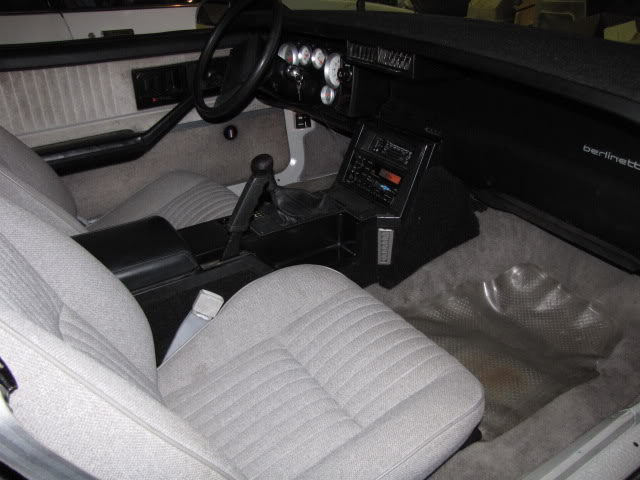

Interior shots:
Seat upholstery:
Front seats, dash, console:
The stance with V6 front springs. I had backed it out onto the driveway to wash it off, backed it onto the street before pulling it back into the garage:
Seat upholstery:
