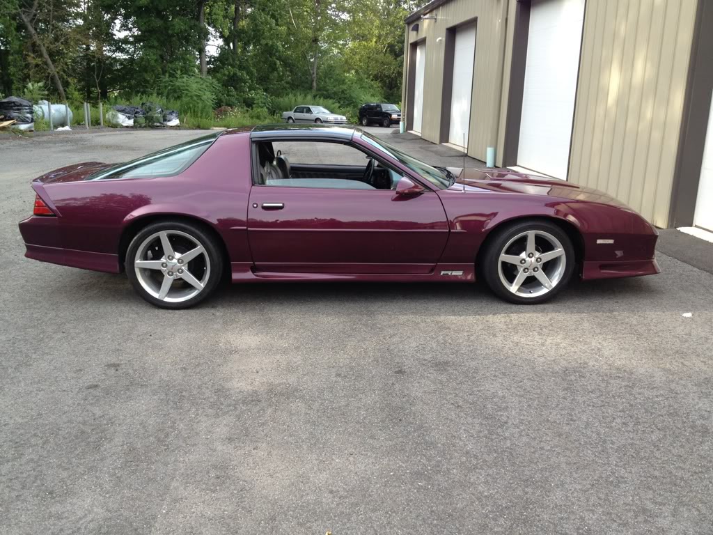

Old Aug 8, 2012 | 10:39 PM
88blackiroc's Avatar
Joined: Aug 2010
Posts: 486
From: MD
Car: 88 Iroc-z
Engine: ls1
Transmission: t56
Re: front spring
This is how mine sits with one whole coil cut off
A inch or so drop in the rear would look good imo, but its fine for now.

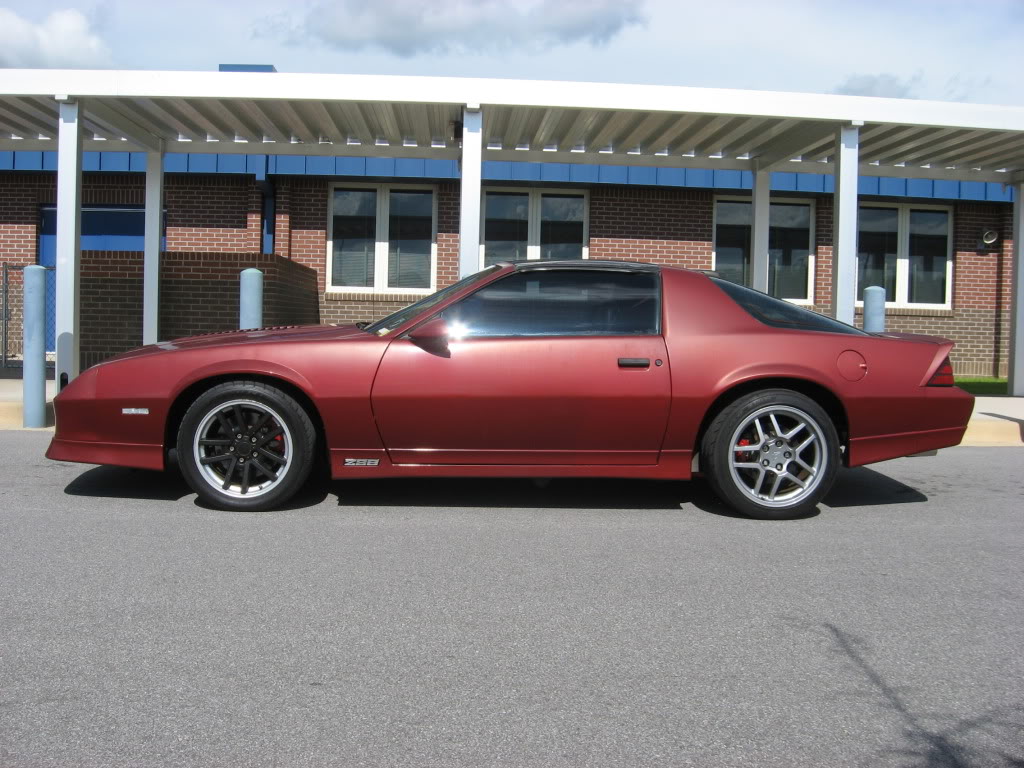

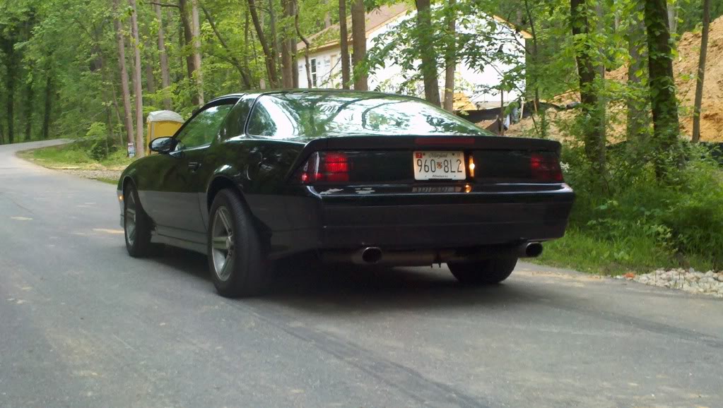

Old Aug 9, 2012 | 06:20 AM
jimmy92rs's Avatar
Joined: Feb 2007
Posts: 232
Car: 1992 RS
Engine: 01' LS1
Axle/Gears: 10 bolt auburn pro posi, 4.10 gears
Re: front spring
So I ended up cut a coil off the front and 1&1/2 off the rear. These are new spring btw.
