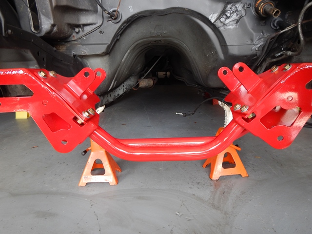

Purchased a new K-member from UMI so oil pan, windage tray, & pickup tube had to be changed.
86' IROC-Z Engine Swap To LS376/480 - 4L70E-umi.jpg86' IROC-Z Engine Swap To LS376/480 - 4L70E-engine1.jpg86' IROC-Z Engine Swap To LS376/480 - 4L70E-engine2.jpg86' IROC-Z Engine Swap To LS376/480 - 4L70E-engine-3.jpg
