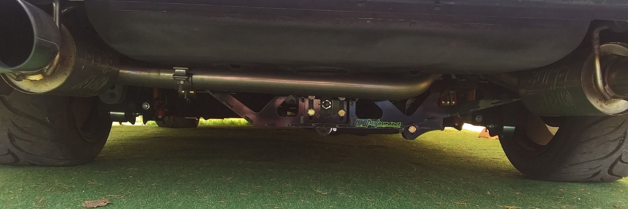

Guess I could add that the hooker dual exhaust didnt sound to hot so I cut out the mufflers and swapped in 5th gen camaro borla atak for a much better driving experience.

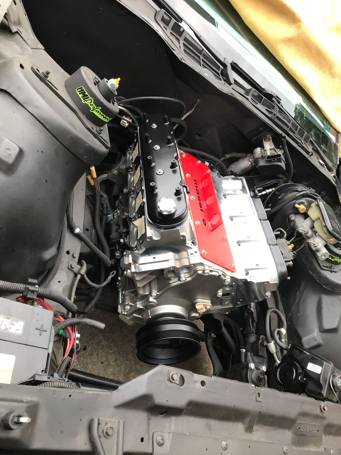

Block got here this morning. Hope to have this thing built by the end of next weekend.

Wow very nice. Did you send texas speed the block? That seems super expensive unless you live by them?

No its a new block but I did ask about sending in a used block and it only took off $400 so not worth the shipping headache.

Another long day but so worth it. Went with ported heads from TSP there two week turn around vs AI’s two months seemed like a winner.

How many quarts does that Moroso pan hold? The kick-outs are a slick idea. I've been considering going to a high volume pump but would need a larger sump like the fabricated pans have.
Noticed that you used a washer as the 2nd hold down for the oil pick-up tube. Guessing the washer is only loaded on the one side? If so, then I would highly discourage that. It's not a structural washer and the joint most certainly will relax and the bolt could fall out. I'm not a bolted joint "expert" per say, but I have easy access to a true expert that has taught me a few things, and I've done a few bolted joint analysis in my time. Improved Racing sells a hold-down bracket that provides a full, flat surface for the bolt head to clamp against.

7qt pan part #20143 went with there matching pick-up tube and windage tray everything fit perfect. The extra hold down came from saccitycorvette the washer is stepped to fit just right.

Oh boy, didn't even have a clue from the picture that's what was on there!
Let me know where that pan sits relative to bottom of k-member. I'm definitely interested in that.

And a few pics of the oil pan looks like a winner has a touch more clearance then my old custom pan. Also don’t forget this is with Hooker motor/Trans mounts so might have different clearance with other mounts.
