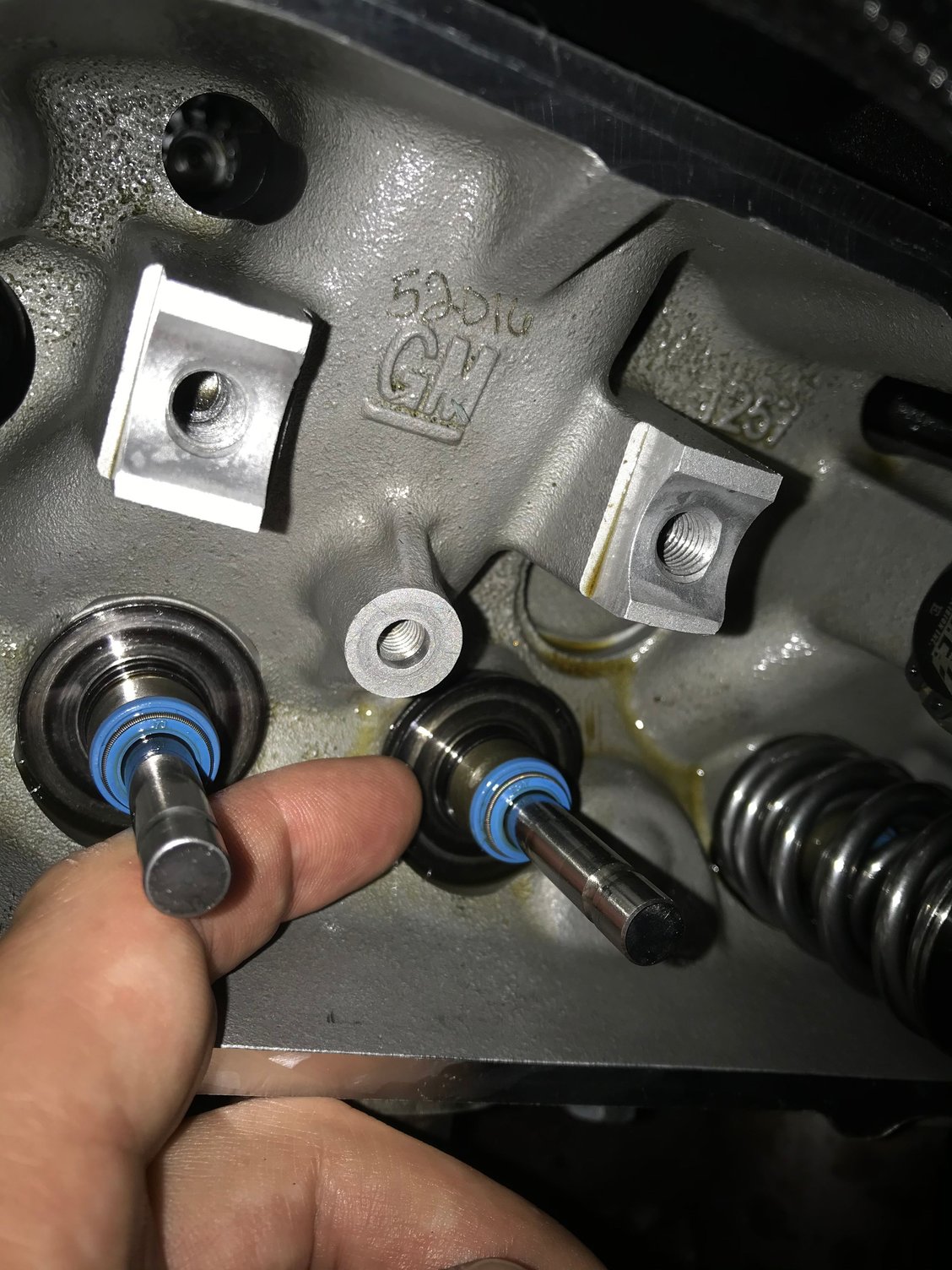

Pulled all the plugs and did a compression test everything was good so pulled valve covers and everything looks good. Tuner says it’s pushrod length that’s wrong so I pull the rockers and measure and they come up good so now I’m thinking it’s all in the tune cause before I took it in for the tune the car would easily blow the tires off in second gear under a nice part throttle rollin and now it won’t?

Did you actually remeasure for pushrod length? What did the tuner say that lead them to believe pushrods were the wrong length?

Yes I measured with a comp cam pr checker. The pushrods are btr 7.8 stock length
He said the way the hp flatlined up top made him think it was a pr length issue.

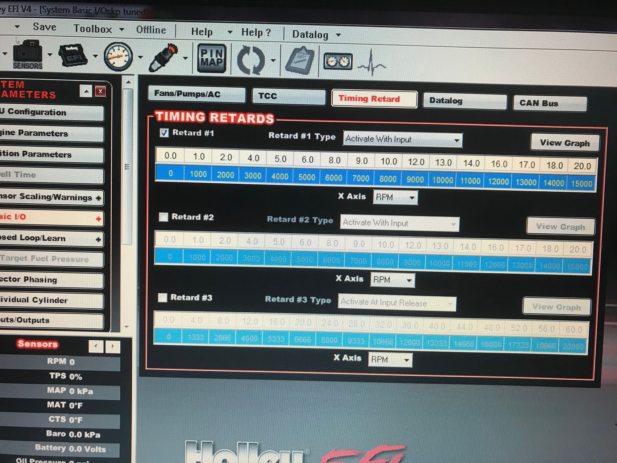

As it looks right now I got a crap tune cause I made up a new base start-up tune and the car is faster with it. Did a stop watch test pull from 60-120 his was 8.0 mine was 7.25 seconds.
QwkTrip could you post up a picture of your base timing table for me on here? Please..

Tune is attached. It is in V4, hopefully you can open it.
One thing you'll probably want to snag from my tune is the 2D custom tables for IEA Low and High. It will build torque off idle to 3000 rpm. Disable the Holley Injector End Angle table and set IEA to 0 degrees in the ECM Parameters.

Yep I got it to open. Wow you got some wild stuff going on going to have to take my time and look over all that. Take a look at some of this he setup cause I’m at a loss why would he even enable the timing retard function?

I can't see a reason to use the timing retard. May have never been a factor if he didn't have a way to trigger it. I guess you could use a clutch switch to cut timing so you can do no-lift shifts.
Might be better to start with my tune and tailor things from there. It looks like I have AC in the tune but I don't. I had to re-assign the AC Compressor +12V relay output to the Boost-A-Pump, but all the other supporting inputs for AC are still there.

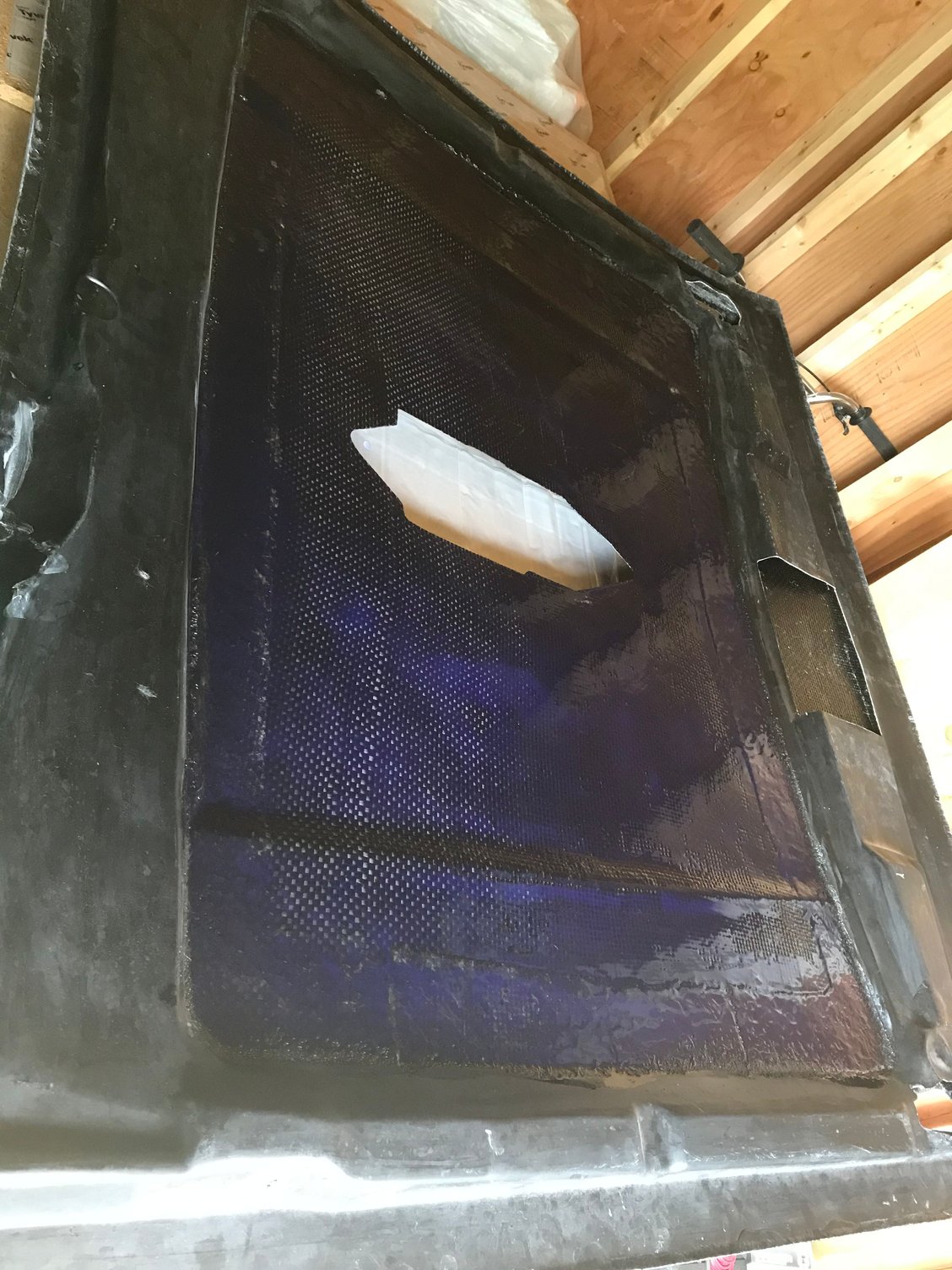

Re: LY6 carnage

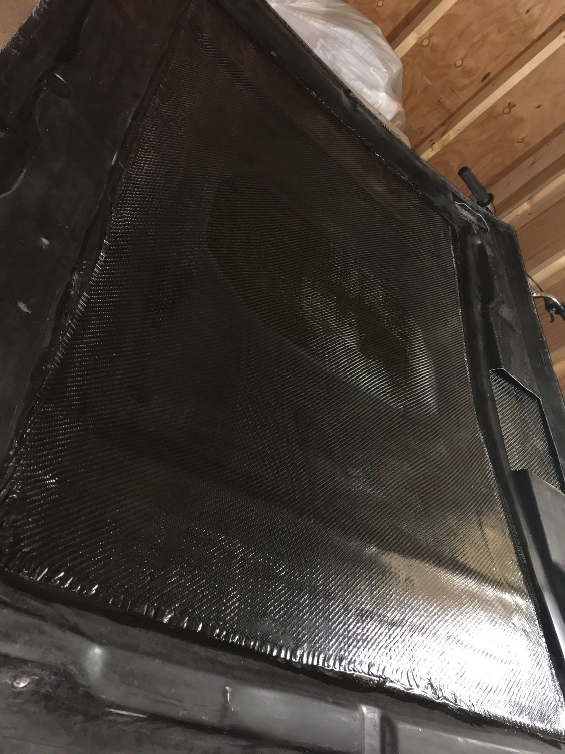

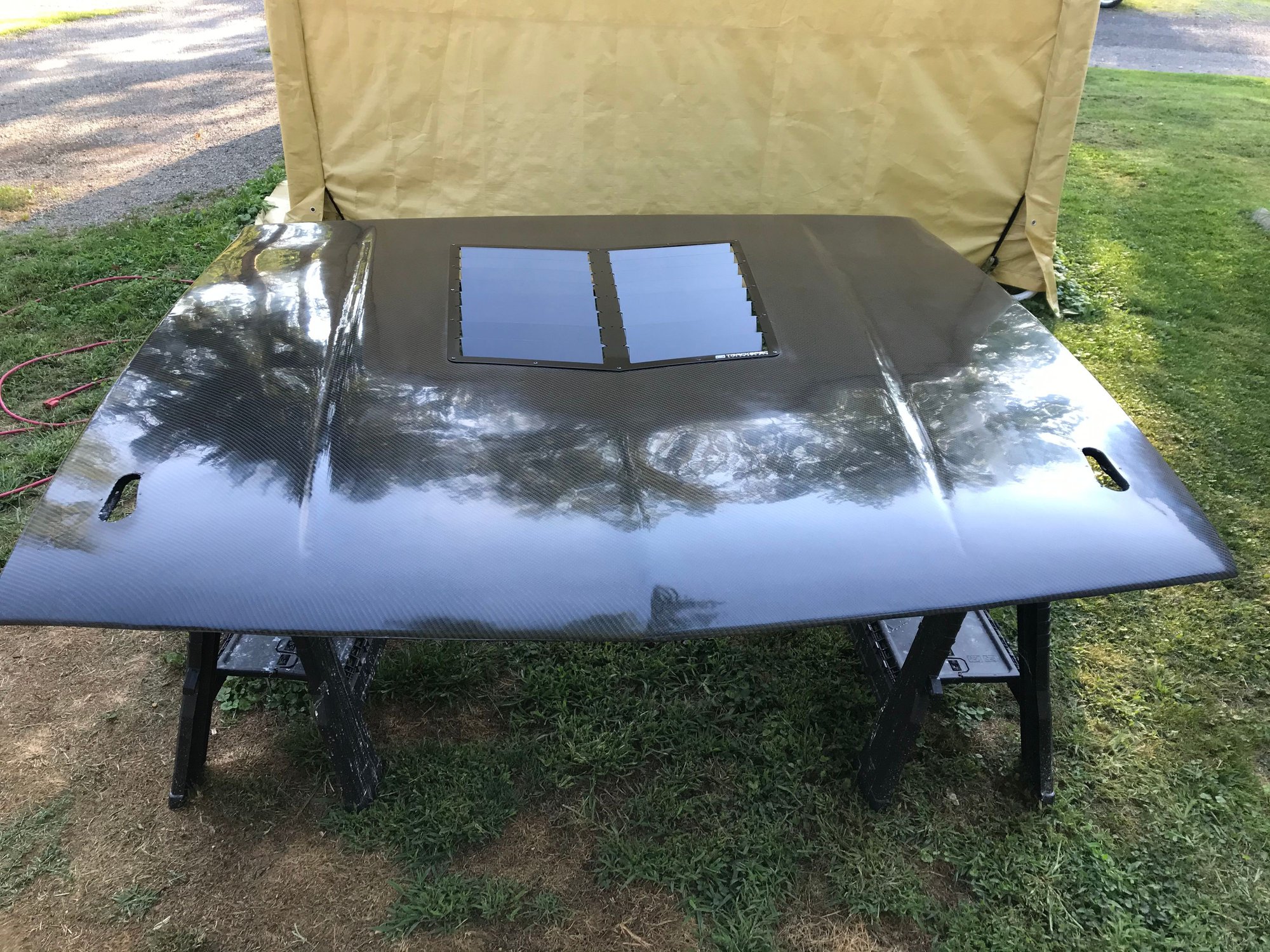

Hood project is just about complete hood pins should be here in a few days then I can get it on the car. And yes I know it’s not perfect by a long shot.

Re: LY6 carnage
Did you hydro dip the hood? If so that is impressive. Large parts like that are hard to dip.
No dip its real I laid the carbon fiber myself.

Re: LY6 carnage
Dang, dude, you're the man! That's impressive.
That looks great! Are those Trackspec vents? If so, what part number? Is that hand laid carbon fiber? You gotta show us how it's done. Really phenomenal! Wonder how those vents would look on a birds 4-vent hood, though there is a bodyline right in the middle...

Re: LY6 carnage
Composite Envisions this the only company I could find that sells it in the 60” width which is just big enough to cover these huge hoods.

This is how I got it with a hole cut out to fit a Holley high ram intake. It’s just a single layer of plain weave carbon fiber with a gel coat super light but to flimsy for my liking so I first added a small piece on the underside for strength.

You made that hood? Wow. I've seen cool stuff on this site, but this might take the cake.

I watched every YouTube vid on carbon fiber I could but only found one hood video of a few guys doing exactly what I wanted to do which helped a lot. Fingers crossed racing is there YouTube carbon fiber restoration is the video. Not a crazy amount of cash for materials but so much sanding but my original idea was to get a factory 83 fiberglass z28 hood and do something similar with it. This pic is after the top layer is hardened up and edges still need trimmed

Then after much wet sanding and clear coat.

Quick test fit and looks like it might just work.

Started digging back into the motor again and found a few bent pushrods as in all of them.
Old Aug 17, 2020 | 03:25 PM
  #139
QwkTrip's Avatar
COTM Editor
iTrader: (22)
Posts: 10,405
Likes: 2,081
Car: '89 Firebird
Engine: 7.0L
Re: LY6 carnage
Wow. Both intake and exhaust?
Old Aug 17, 2020 | 03:40 PM
  #140
obeymybird's Avatar
Posts: 1,125
Likes: 55
From: PA
Car: 92 camaro RS
Engine: LSA
Transmission: Magnum F
Axle/Gears: TNT 8.8 wavetrac 3.31
Re: LY6 carnage
Yep all 16 now im not talk bent like a cheese curl just enough that when you roll them you can see and hear it. There BTR pushrods so idk what to think the tuner did spin the tiress hard in 4th the first pull maybe a over rev? But this does explain why car felt slower after the tune.

Still chasing my tail on this build nothing seems to help. New pushrods didn’t do anything so I ordered a new B3 cam and put that in and made no change to the power. Next up is a valve spring change and if that don’t work then time to pull a head and see if the cylinders are glazed. Picked up this tool from Lingenfelter it is the only one I found that works on all LS heads.
Old Sep 11, 2020 | 01:39 PM
  #146
obeymybird's Avatar
Posts: 1,125
Likes: 55
From: PA
Car: 92 camaro RS
Engine: LSA
Re: LY6 carnage
I did check to make sure TSP shimmed the valve springs looks like they did going to be throwing in BTR .685 springs soon as they show up.

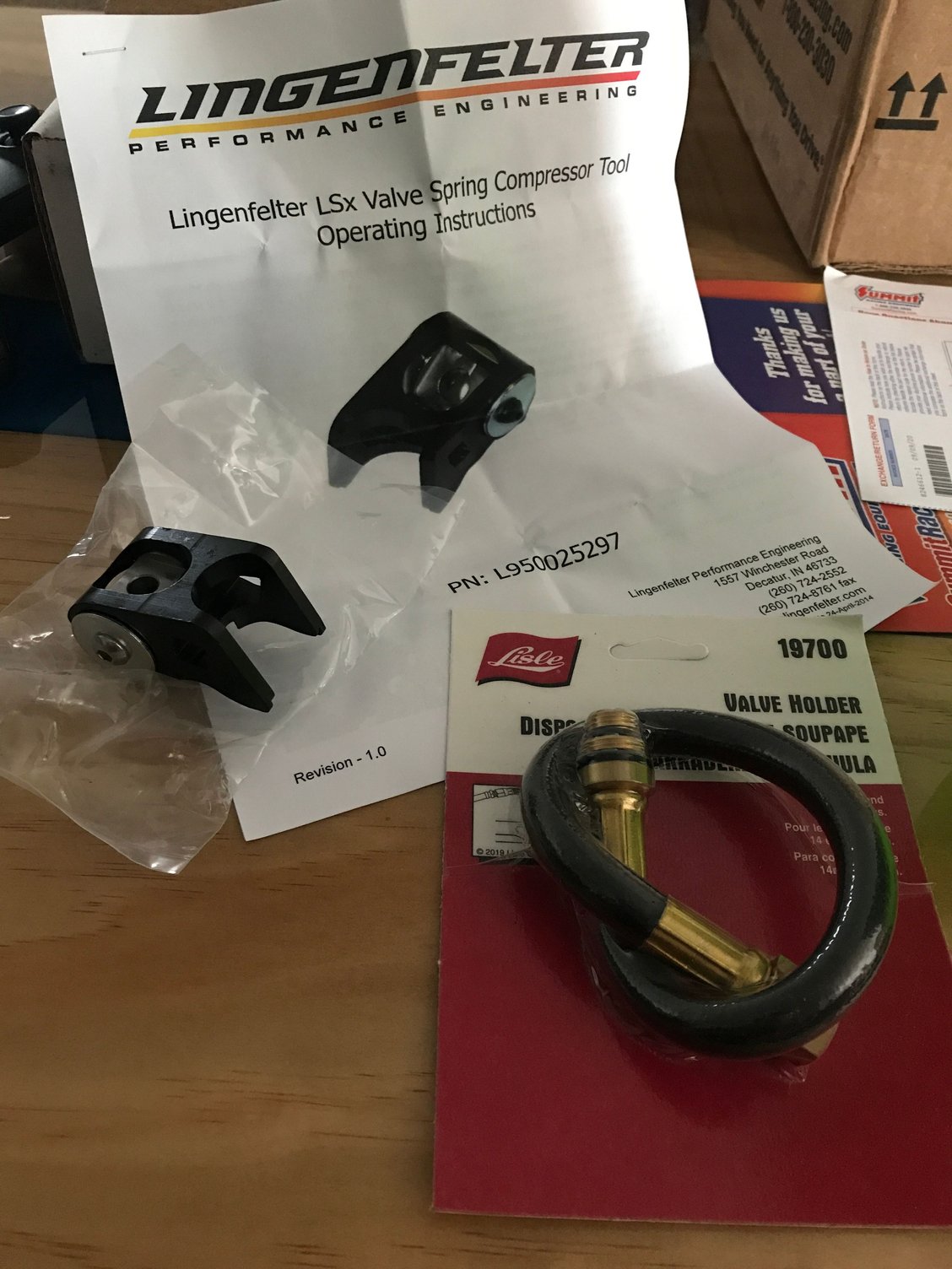

New springs are in but no test drive yet. While it was apart I weighted the springs and retainers and the new BTR .685 are 3 grams lighter per spring then the TSP .660 set. The spring tool worked great for removal but install was slow and painful.
Old Sep 13, 2020 | 07:18 PM
  #148
QwkTrip's Avatar
COTM Editor
iTrader: (22)
Posts: 10,405
Likes: 2,081
Car: '89 Firebird
Engine: 7.0L
Re: LY6 carnage
Not sure why, but finding spring compressor tools for LS7 heads is not easy. Glad to see another option available. I used a goofy little tool made by somebody on LS1tech. Although it looks like yours requires one hand to be busy with the ratchet, leaving only one hand for placing the keepers. I have both hands free with my tool which is nice.
Old Sep 13, 2020 | 08:47 PM
  #149
obeymybird's Avatar
Posts: 1,125
Likes: 55
From: PA
Car: 92 camaro RS
Engine: LSA
Re: LY6 carnage
I could have used a extra pair of hands thats for sure.
