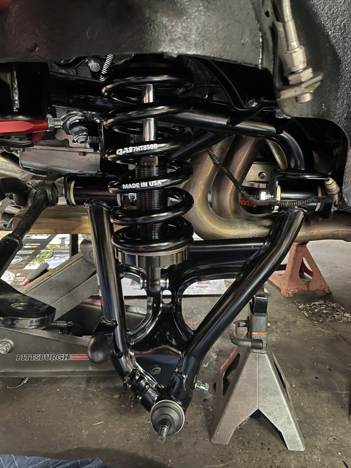

Old Feb 12, 2025 | 03:51 PM
  #355
obeymybird's Avatar
Posts: 1,130
Likes: 59
From: PA
Car: 92 camaro RS
Engine: LSA
Transmission: Magnum F
Axle/Gears: TNT 8.8 wavetrac 3.31
Re: LY6 carnage

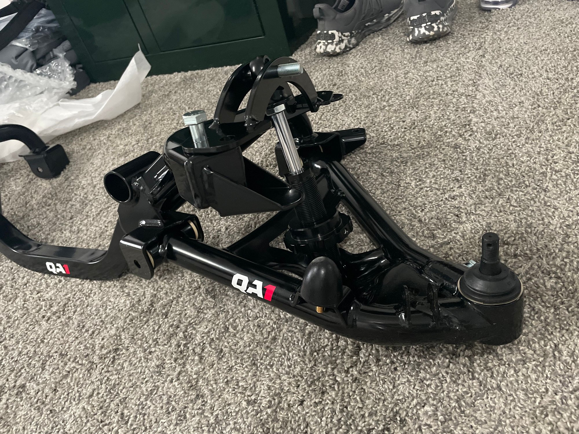

Just a quick little fit n finish check!! Very excited to get this in the car and see how it feels.
Old Feb 12, 2025 | 05:03 PM
  #356
customblackbird's Avatar
iTrader: (15)
Joined: Feb 2007
Posts: 4,770
Likes: 64
From: Trumbull CT
Car: 87 TA clone
Engine: 70/70 Turbo 5.3 LS
Transmission: bullet proof 2004R
Axle/Gears: ford 8.8, 3.55 gears
Re: LY6 carnage
Looks expensive lol. When I did my moly kmember and UMI lower front arms can’t say a huge improvement. A lot of room with the kmember tho. Def shave some weight tho.

They sure look good though. That may be the way I go. Do you think it is better than a coil over set up?
Old Feb 13, 2025 | 08:26 AM
  #358
obeymybird's Avatar
Posts: 1,130
Likes: 59
From: PA
Car: 92 camaro RS
Engine: LSA
Re: LY6 carnage
For how I use my car this should be better than front coil overs. Adjusting ride height doesn't look as simple as the weight jacks but other than that its pretty impressive stuff.
And this k-member is lightweight 21.4 pounds that bare no mounts or bushings installed just straight out of the box.

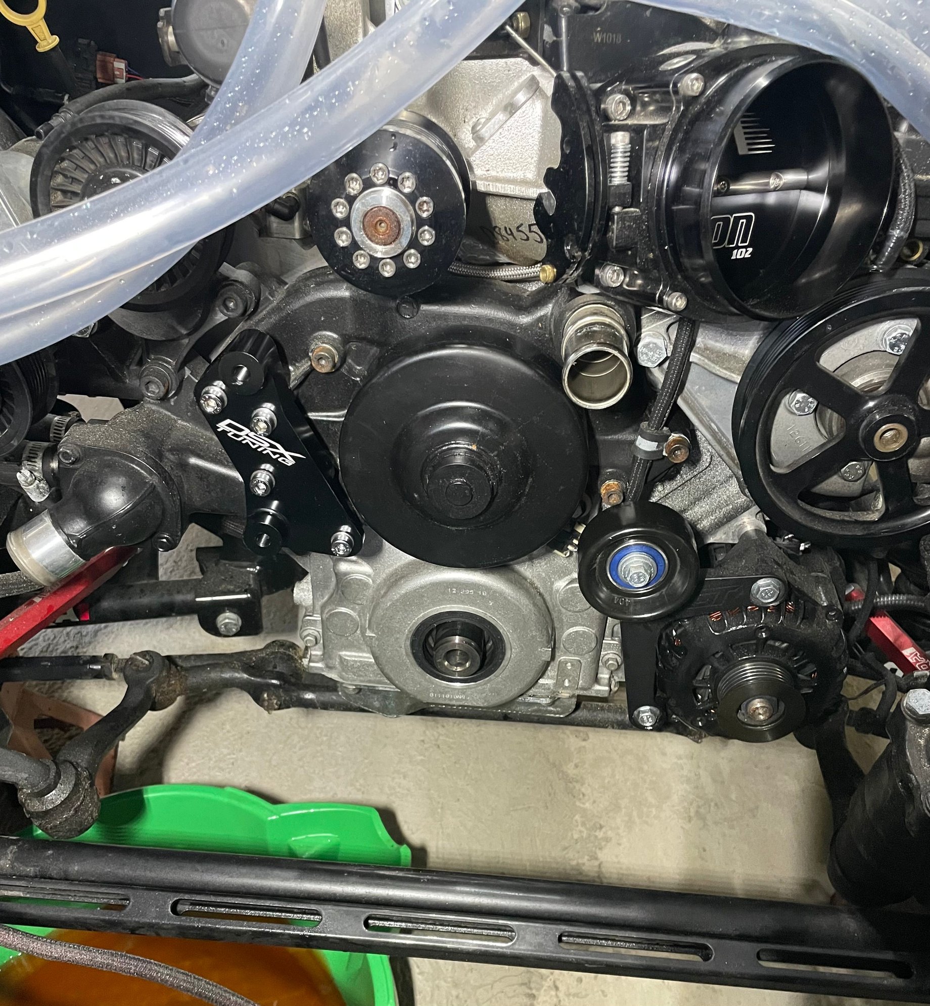

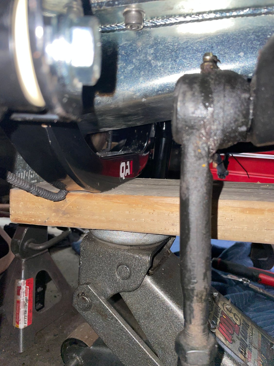

K-member went on without any issues but engine mounts didn’t offer near enough adjustment to keep my motor in the same place best guess the qa1 stuff wants to set the engine back another 1” farther then my hooker mounts. I wasn’t in the mood to mess with all the headaches off moving the engine so I cut the engine plates off the posts at the weld and mounted and fit everything in the car and tacked the mounts back together and removed them to finish weld.
This checks out as the hooker mounts intentionally move the motor forward an inch. Starting to come together...

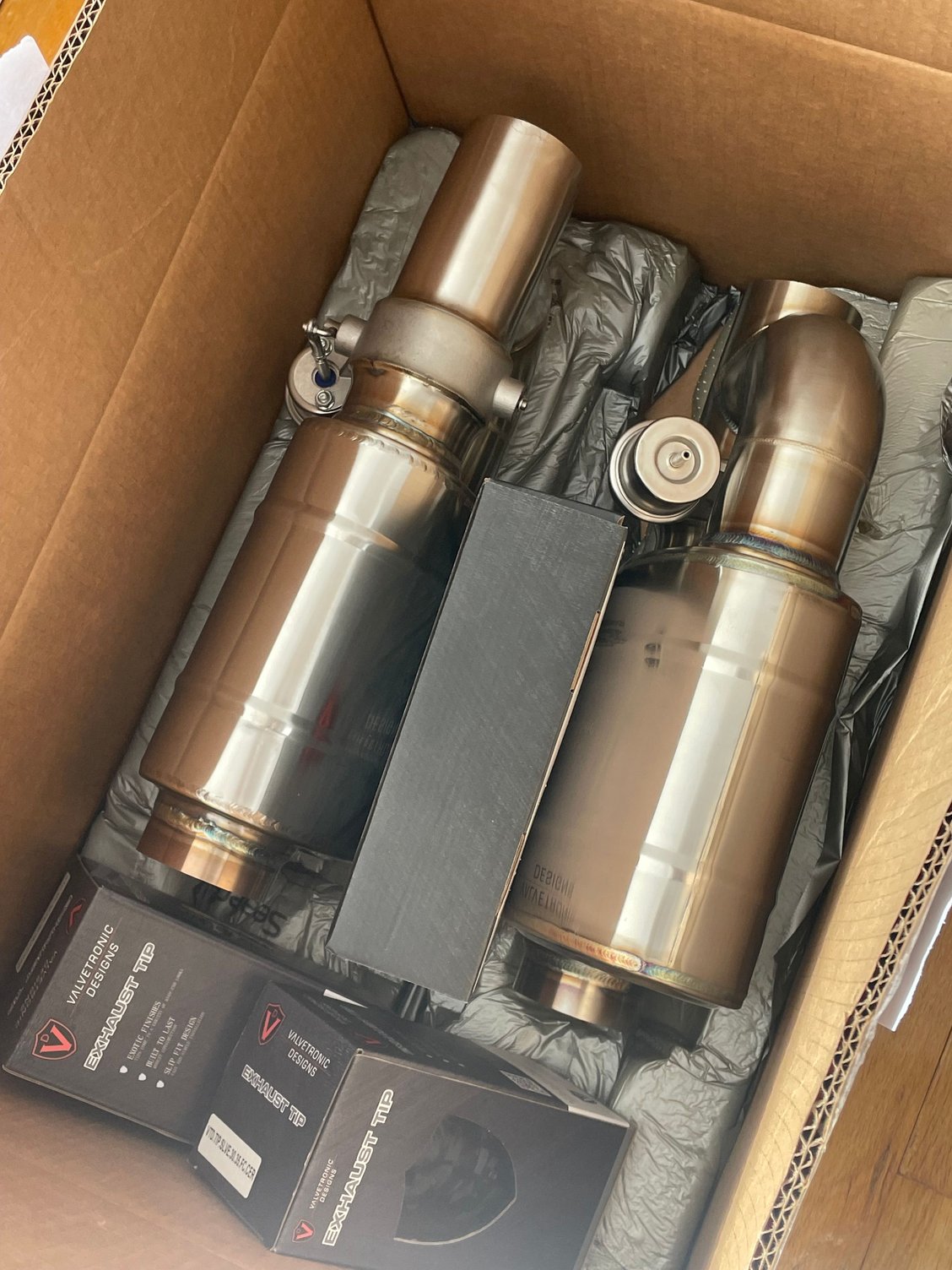

Definitely nice finally having the garage done it needed a floor so got a cement mixer and 10,000 pounds later I have a floor.

Re: LY6 carnage

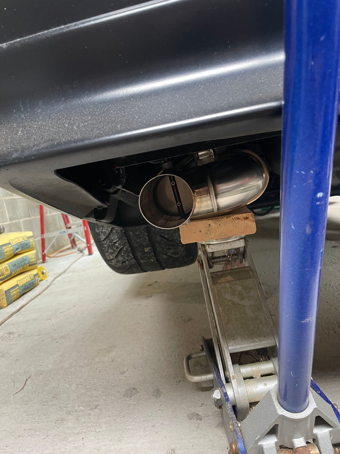

Curious to what your plan is to mount those mufflers. I need something different for my dual 3" and I've though about something along these lines. I've never heard of this company before but these mufflers aren't too terribly large.
Old Jan 30, 2026 | 11:47 AM
  #370
obeymybird's Avatar
Posts: 1,130
Likes: 59
From: PA
Car: 92 camaro RS
Engine: LSA
Re: LY6 carnage

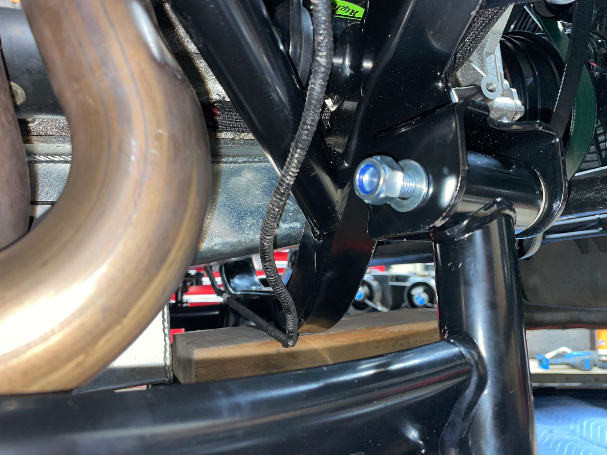

I got a few ideas but most likely I will be doing something similar to my kit car build years ago. Which would involve cutting a few inches out of the bottom of the trunk if need be so they tuck up under the car.

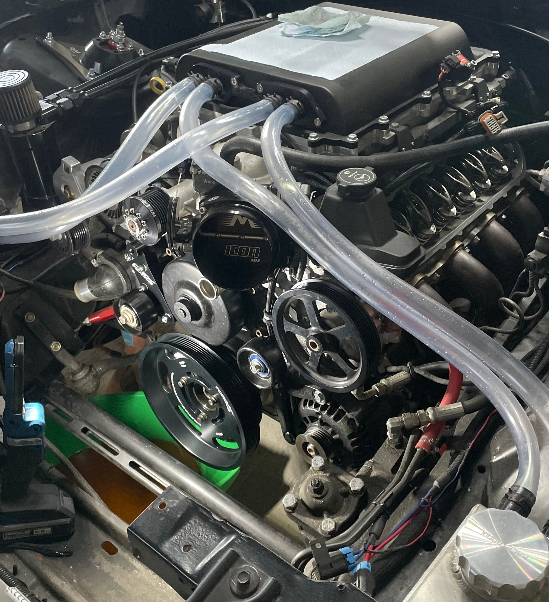

New lower installed just waiting on a new idler pulley and belt.

Just doing some test fitting for now but that driver side fits like a glove but not so much on the passenger side.

Old Feb 5, 2026 | 01:42 PM
  #374
obeymybird's Avatar
Posts: 1,130
Likes: 59
From: PA
Car: 92 camaro RS
Engine: LSA

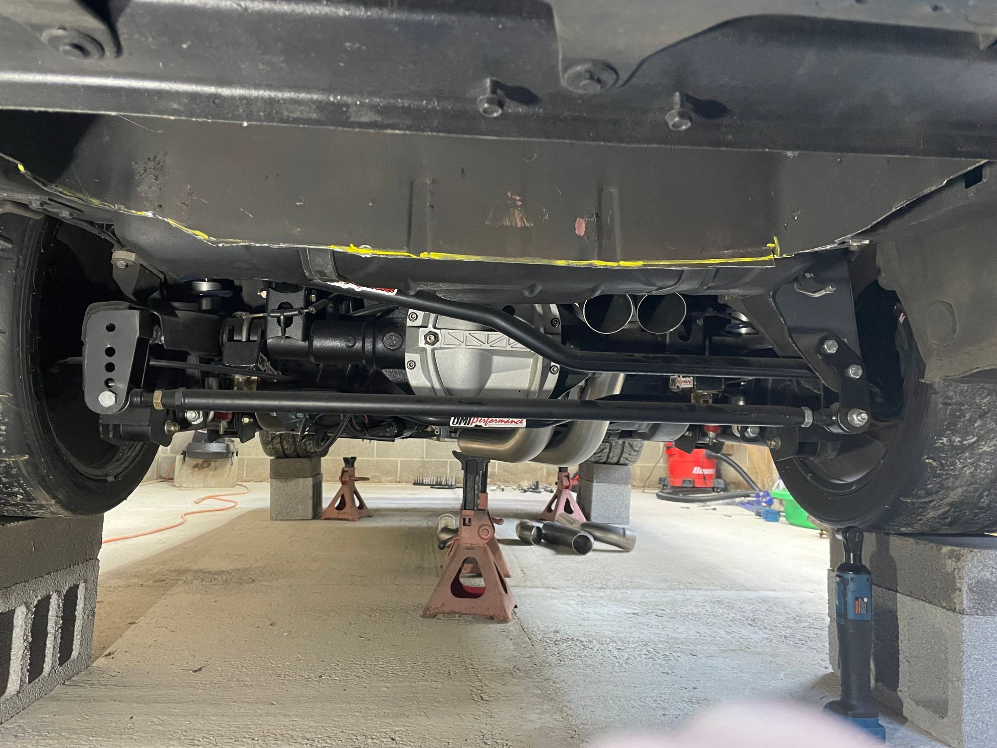

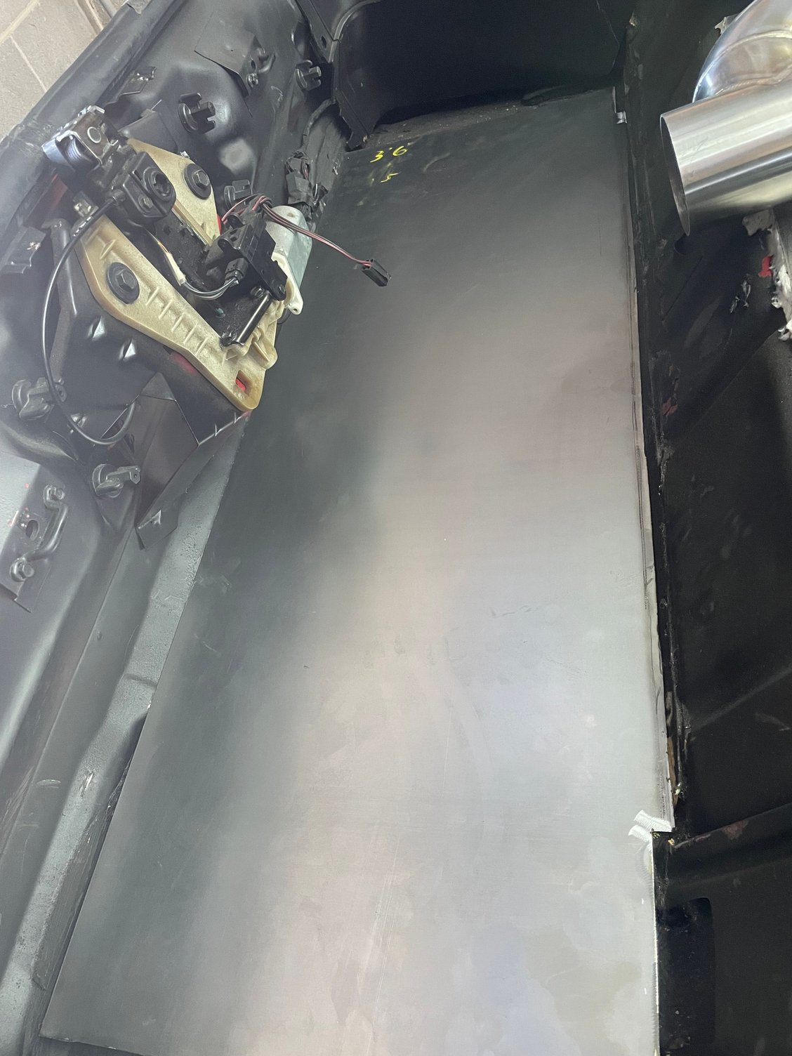

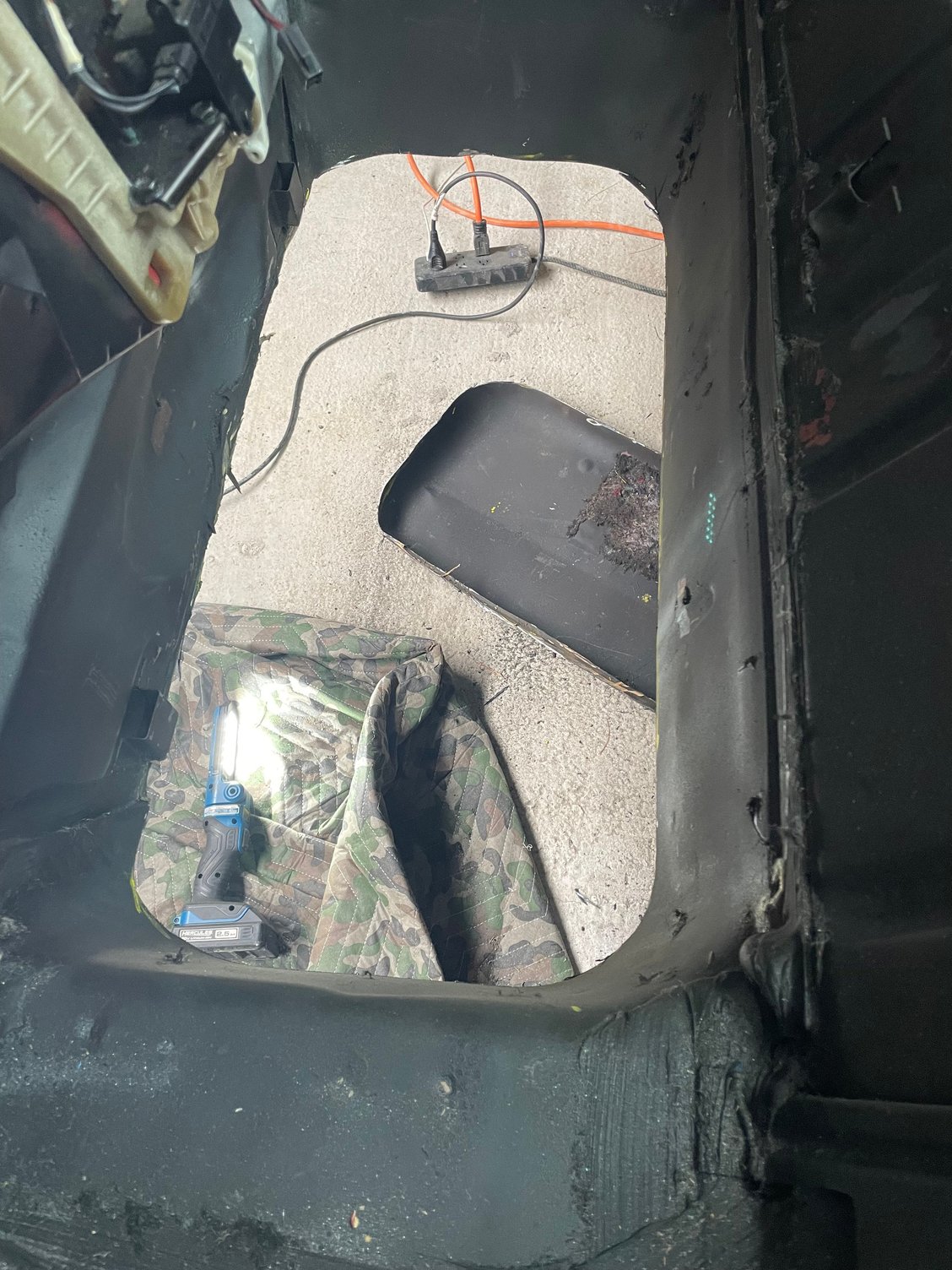

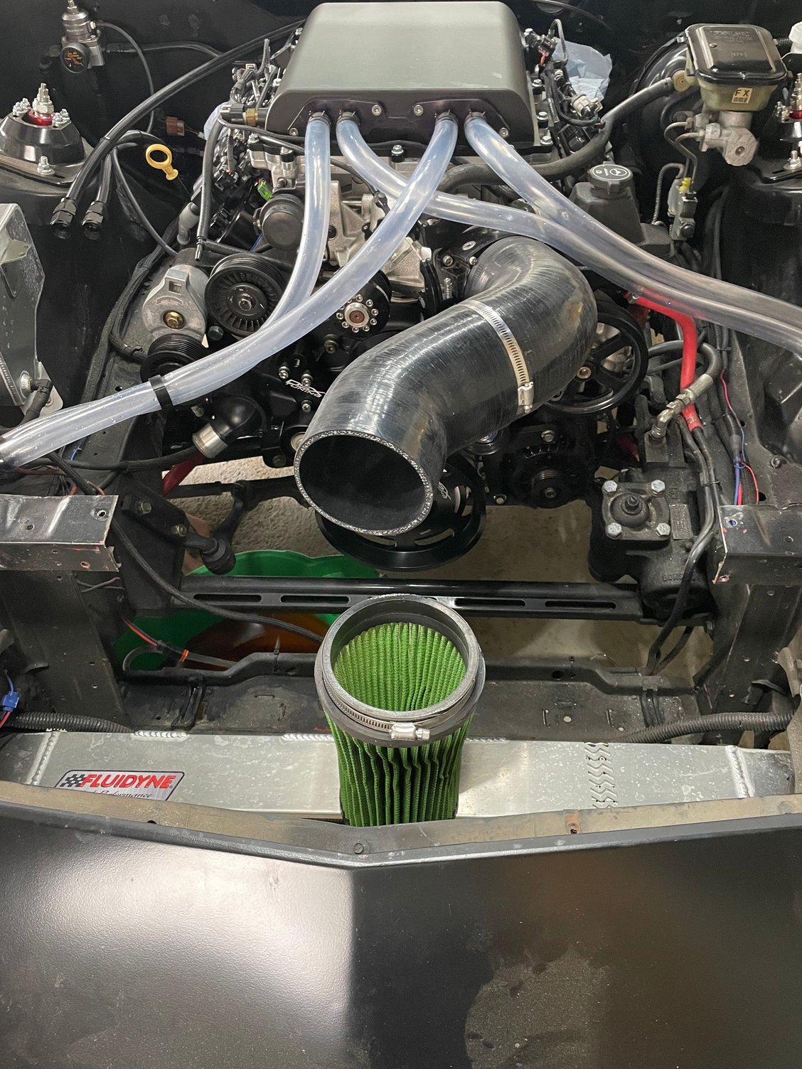

Originally the plan was y-pipe into a 4” single then split it back to dual 3” at the axle but I found a deal yesterday on the speed engineering 4th gen kit. So that’s on the way and I’m heading to NY for the next few days. When I get back I plan to cut the bottom of the trunk out and go from there. Now does it need cut out probably not completely but it would need notched or even notch the passenger side spare tire wheel well area.
Old Feb 5, 2026 | 01:44 PM
  #375
obeymybird's Avatar
Posts: 1,130
Likes: 59
From: PA
Car: 92 camaro RS
Engine: LSA
Re: LY6 carnage
Basic rough idea of what I’m going for but with a different filter design and angle.
Old Feb 6, 2026 | 07:17 PM
  #376
ShiftyCapone's Avatar
Supporter/Moderator
Posts: 13,777
Likes: 567
From: Cincinnati, OH
Car: '90 RS
Engine: 377 LSX
Transmission: Magnum T56
Re: LY6 carnage
You'll for sure need a filter 2X or more the size of that one. I gained 13rwhp by swapping from a similar filter size to a massive K&N.
Old Feb 9, 2026 | 09:01 AM
  #377
obeymybird's Avatar
Posts: 1,130
Likes: 59
From: PA
Car: 92 camaro RS
Engine: LSA
Re: LY6 carnage
13whp gain is huge thats awesome. Just me getting it outside of the engine area should hopefully get me a few extra hp. Goal is 750-800 whp but might be asking to much from the small cam.

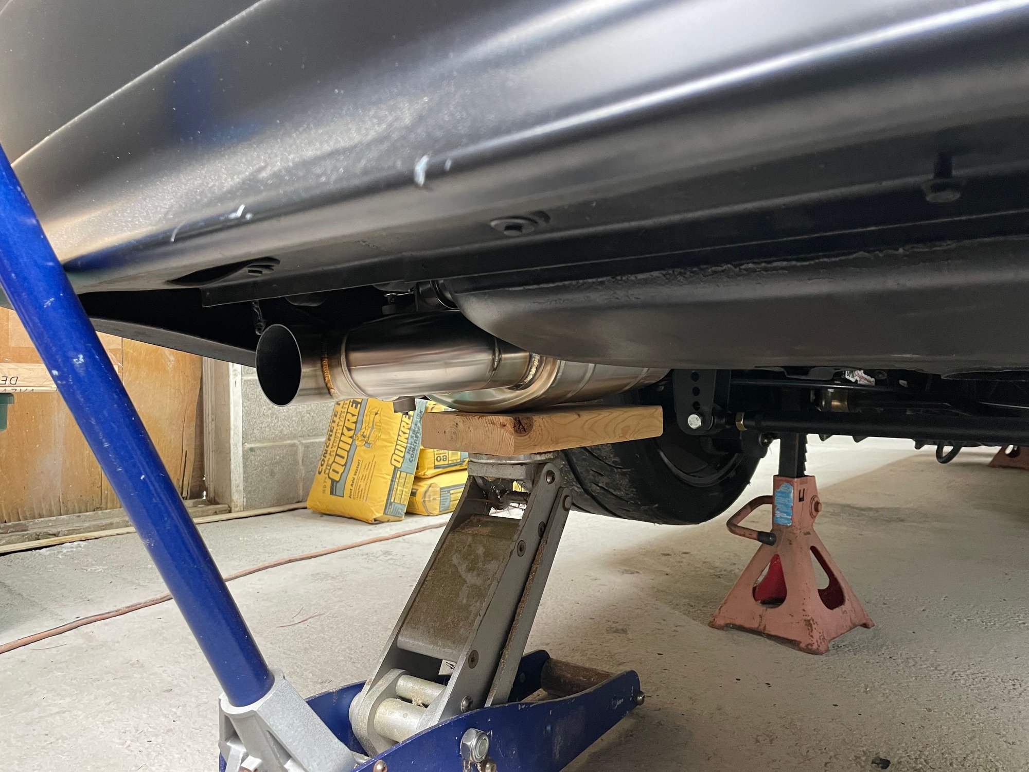

Progress so far has been slow going but getting closer. I need to put in an order for some pipe bends to connect up to the headers. Center mounted exhaust is a serious option at this point.

Finally got to start this up with the new exhaust full installed. Still need to wire up the box to remotely open the valves but with the valves closed I’m extremely happy with the db level at idle so far.

I'd really like to see more of what you did with the Rear Cargo Compartment/ T-Top Compartment that you cut out for Exhaust clearance.

I haven’t done to much else yet with the trunk cause of future plans. About have my air intake sorted out so that’s good news but have bad news also. I was out today for a test drive and smoked the clutch on a wot 3-4 gear hit. It held third perfect at the 60mph hit blew the tires off left a lot of rubber on the road but soon as I hit fourth gear the clutch gave up the ghost.
