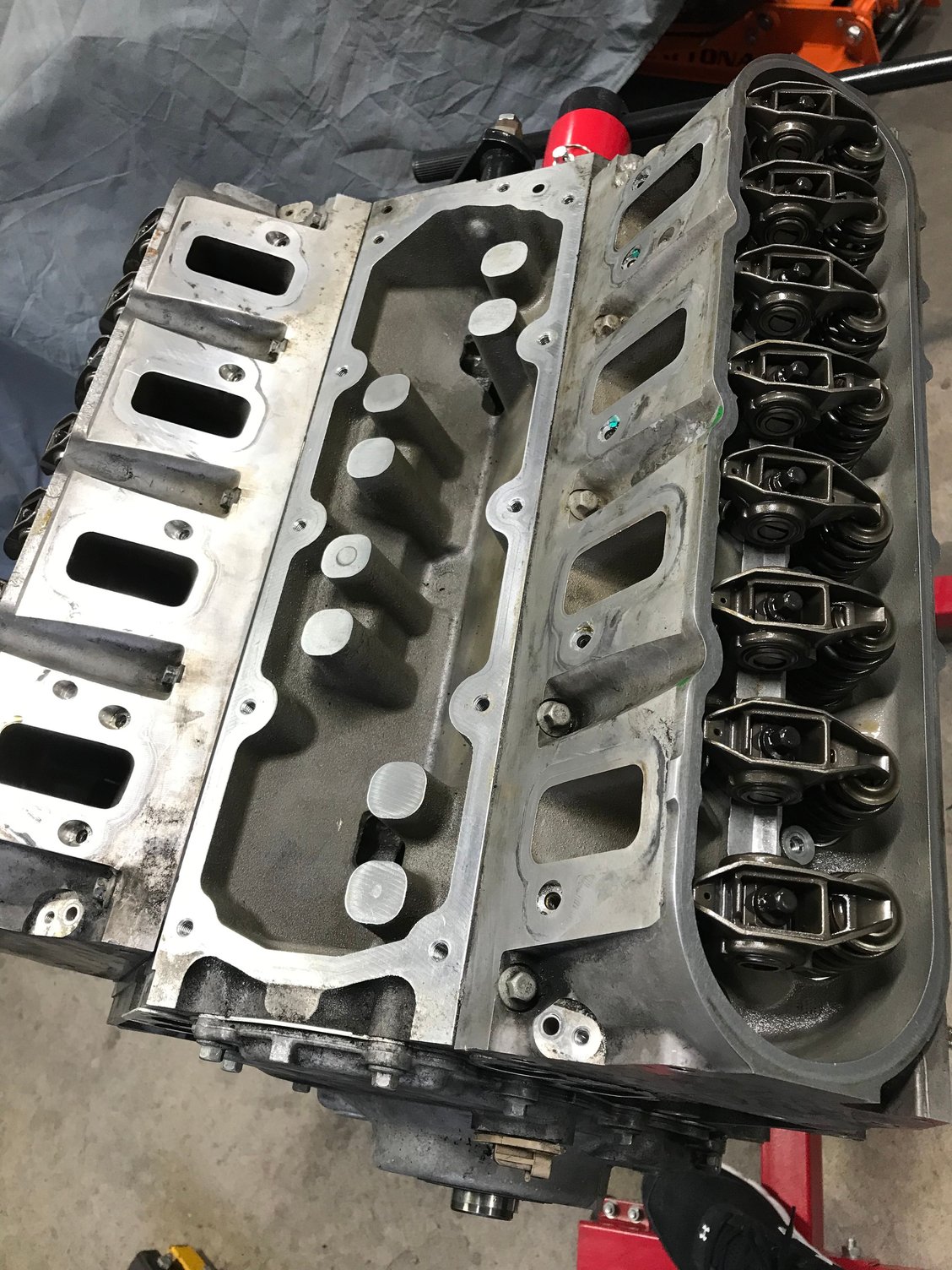

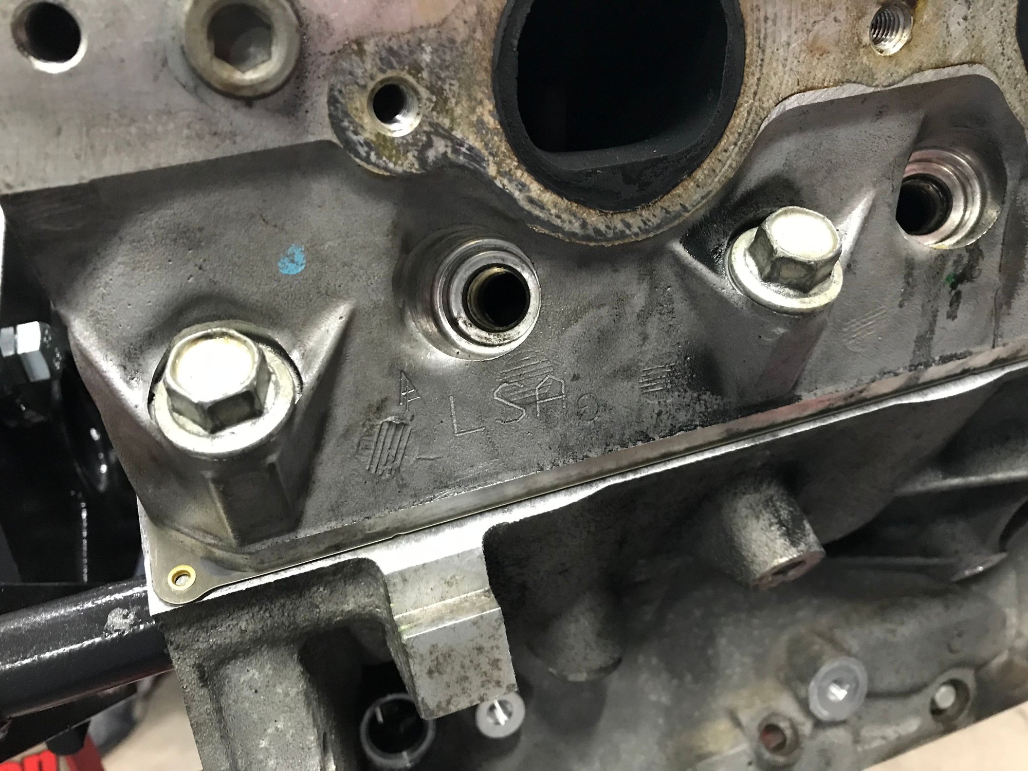

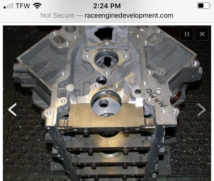

Learned something new over the weekend called crankcase windows. Looks like all the real LS car blocks got them in one way or another but not the gen 4 5.3 truck blocks. So from my understanding my sleeved block is great for boost but takes a power lose for N/A builds. No one seems to know a real world power loss number cause I have heard everything from 20-50+ hp. Few pics I found of a 5.3 getting a extra breathing hole not sure if I want to try this or sell of the block and start over with a LS7 block.

Yes, that's something I learned too when going from truck 6.0L stroker to the LS7. Crank bay windows help with oil drain back and windage losses. None of the trucks have bay windows, but some places will poke out some small holes. All the "LS" engines (car engines) have bay windows and each generation got larger openings than the last with the LS7 being the largest.

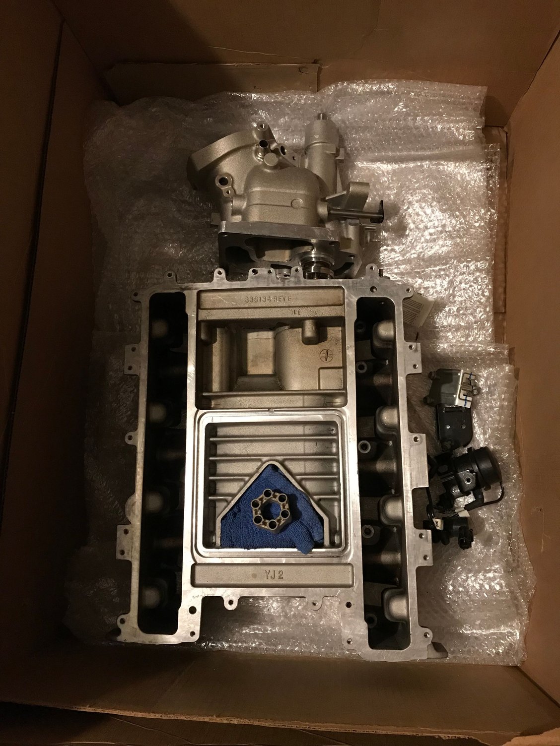

This showed up today got it used for a decent price looks to have some mild porting done so might help me find some missing hp.

Great choice for an intake on an LS7! Nothing touches a properly ported MSD LS7 intake under 7K rpm from what I've seen.

Great choice for an intake on an LS7! Nothing touches a properly ported MSD under 7K rpm from what I've seen.
Fact. The ported MSD for LS7's is unmatched. Read Tony Mamo's thread on this guy. Crazy gains, even over ported fast.

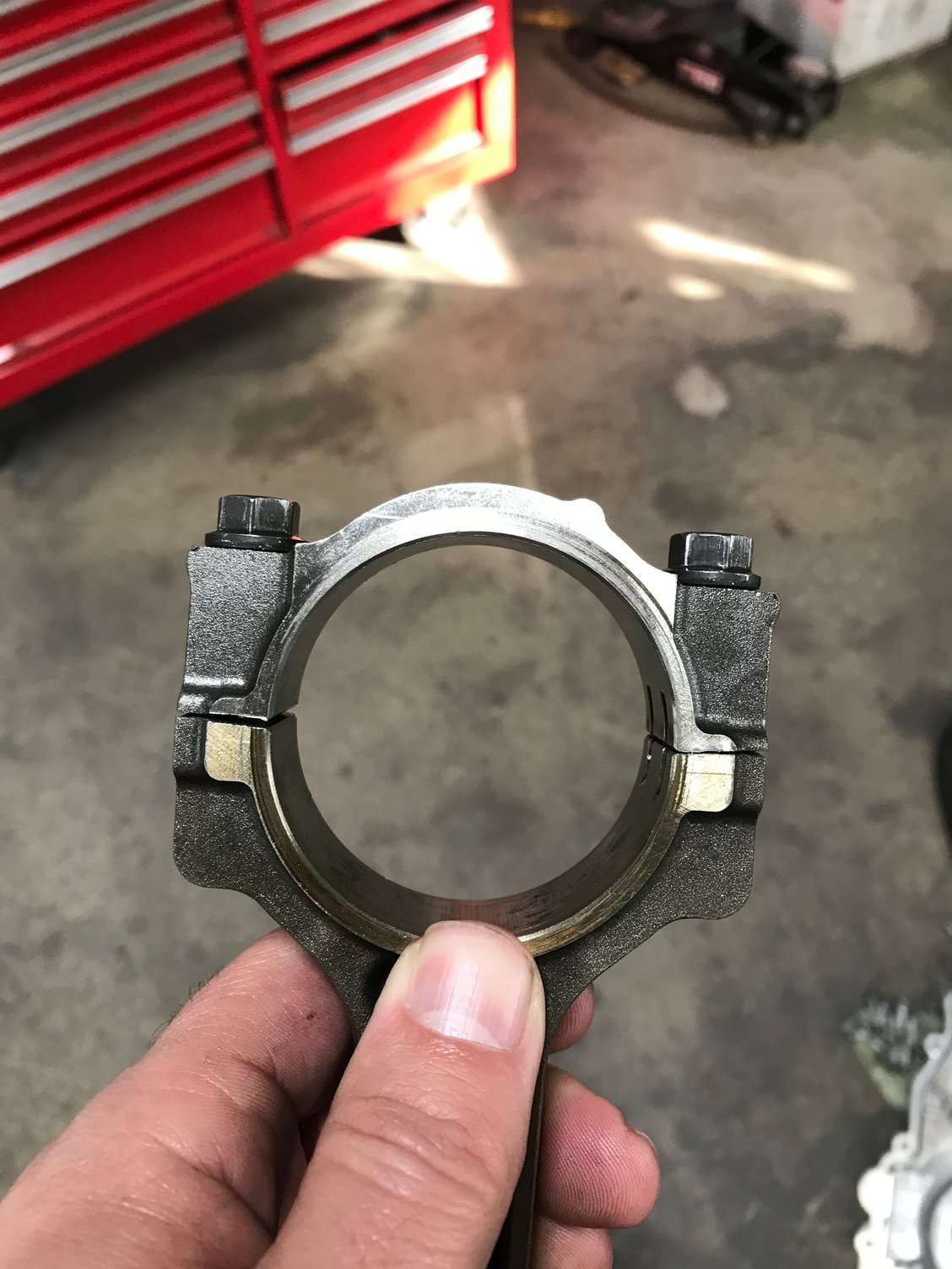

Might want to get new o-rings for the mounting bolts too. The MSD is notorious for vacuum leaks and bolts backing out.
I can't remember for sure, but I think I only had a nut on the front side of the rod, and the back had a threaded insert. But I don't remember for sure.
I know the windows started with the LS6 blocks as early LS1s didnt have them. I would of thought it was standard procedure on all since, see what happens when you assume? I picked up a gen IV 5.3 aluminum block a while back and I never really looked at it it's going to have some new cam bearings along with my sons 6.0 soon so I may have to mod mine like this

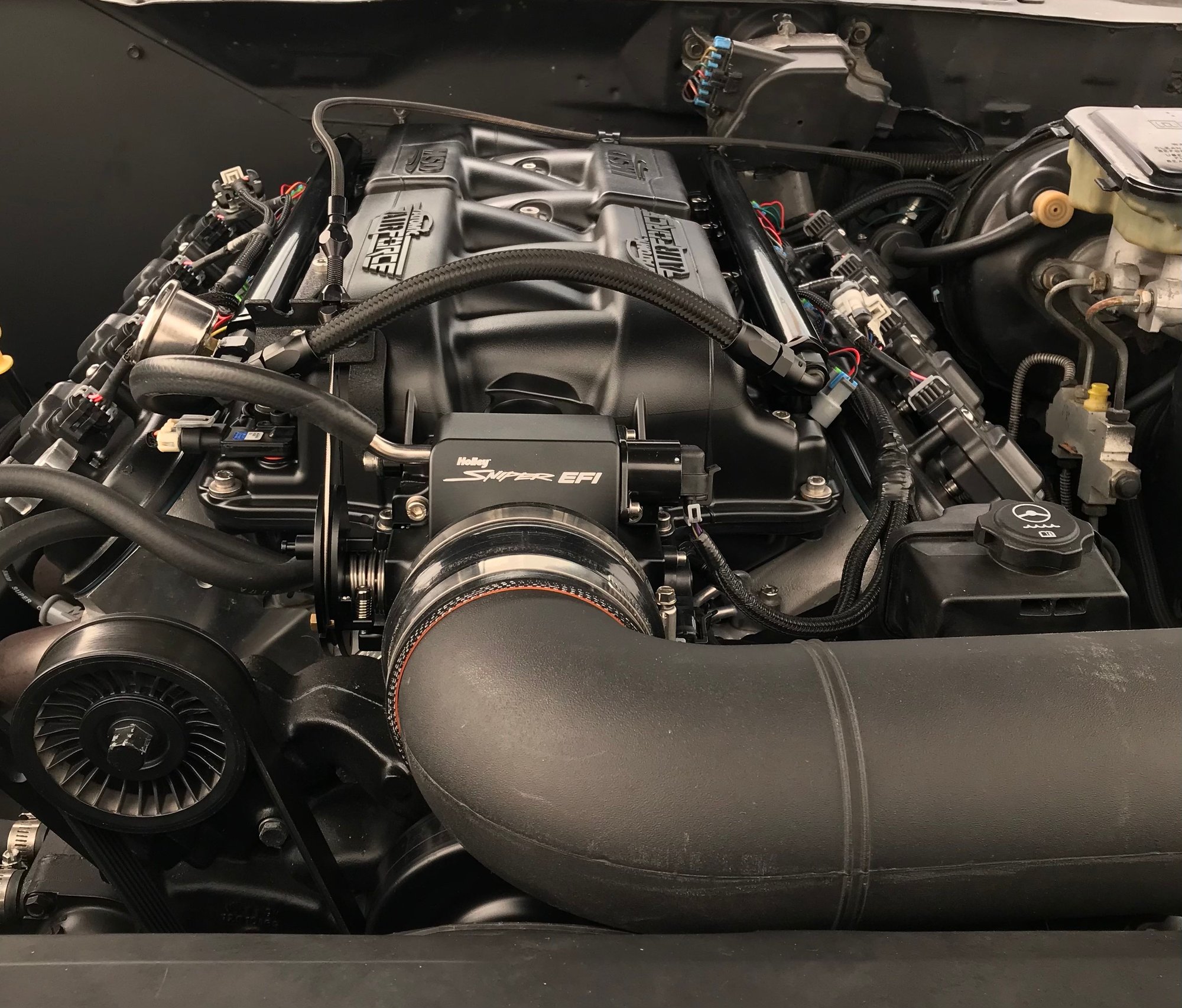

So got it fired up today first thing I notice is the super loud noise from the air being sucked in the t/b hurt my ears loud is this normal for the msd intake or bigger t/b? Also my old air intake will not fit over the new 102mm so going to have to come up with something else it looks.

Looks awesome. The intake noise is normal and should quiet down when you get your tube on. I used the Spectra 4" silicone adapter coupler and although tight, works really well.

Well onto the road of recovery at this point. New oil sender is in and working good gauges are back in also had my valve covers powder coated to add some color contrast. Switched back to the tsp .660 springs.
So either the car is just working better or the msd intake and 102t/b gave it a well need boost was starting to think it was all in my head but I got a run in against my buddies trackhawk which has exhaust cold air box and tuner we did a 60 roll and by the time I topped 4th out I had him by about 4 cars.
Sneak peak of the c7 zr1 wheels coming soon!

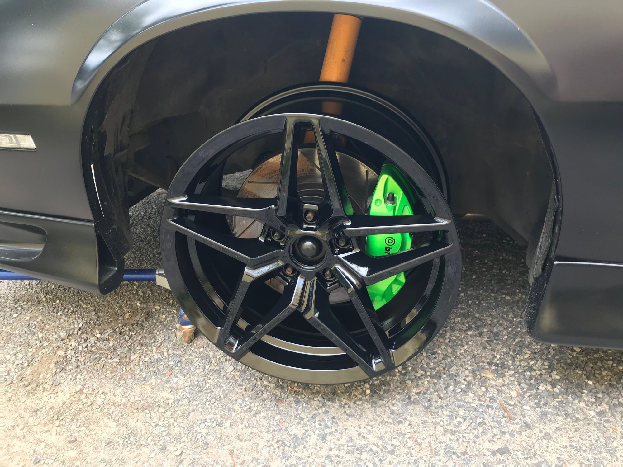

I really didn’t like cutting up the dash to make it fit almost returned it. Wheels are 18x9.5 front and 18x11 rear
Coils are still on the valve covers just didn’t have them in place yet.

Turns out this perfect 6.2 isn’t so perfect can’t trust anyone it seems.
Guy said this was a untouched long block so when I pop off the passenger side head why would a new head gasket fall out? So after that I see #8 piston sitting off center in the hole so now I’m thinking bent rod so I flip it over to find what looks like a miss matched rod and cap no crank damage so thankfully he never got it running again after he was monkeying around inside.

Sorry, that sucks. Buying used engines is a crap shoot. A lot of dishonest people selling engines they don't want to fix or deal with.
I've sold a few engines and I hated it every time. I'm an honest guy and it worried me sick if the next person had any troubles even though I didn't. I probably drove redmaroz nuts asking questions how the 427 is running because I'm just a worrier and want to make sure he got what he paid for.

I always wondered what happened with your old 427 how’s he making out with it?
Overall it could have been worse block and crank look fine and have a new rod and piston with a fresh set of rings on the way. But would still like to know what happened to #8 normally they get hot and pop a rind land which isn’t surprising cause the top ring gap is only .015
The head and valves on #8 showed minor damage not sure if something small was bouncing around inside but my dad seems to think it looked like it was getting water in it.

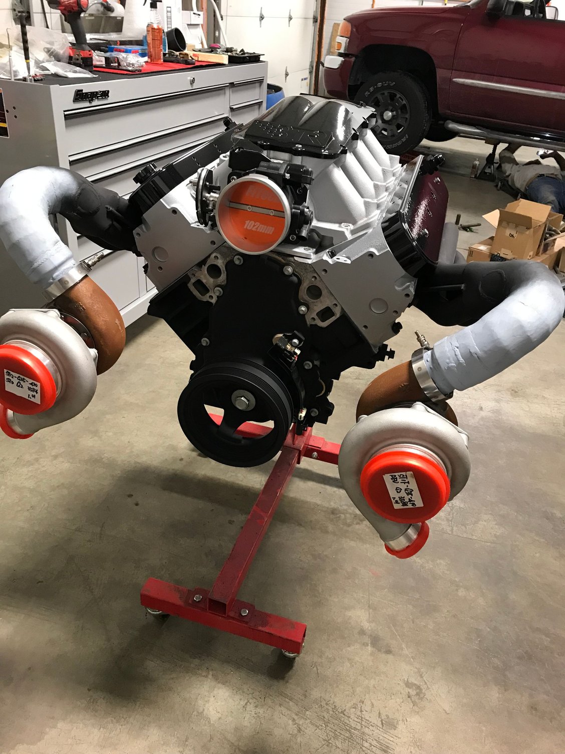

Small little side project I been working for my friend just a small gen 4 5.3 with 799 heads with a BTR stage 1 twin turbo cam with BTR intake and I must say the fitech 102mm t/b is one nice piece.
I feel the Pain of your Header Flanges!
Learn from one of my very early mistakes...
Final Designs/ Installations should never have the Turbocharger supported by the Exhaust System (regardless of how small the Turbocharger is).
Always support the Turbocharger by the Center-Section of the Unit.
