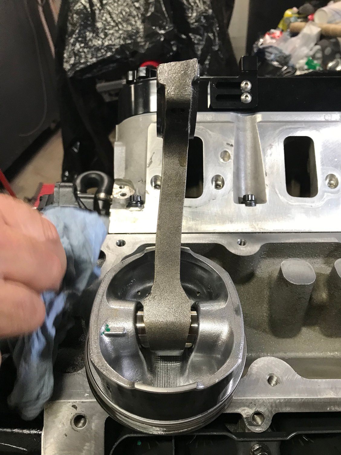

So no easy way to put this but dyno tune was canceled.
Back in January I posted about going to bigger injectors and after I installed them I left something out hoping for no issues. So after the install and first startup the engine hydro locked do to the injector in #1 cylinder being stuck wide open. I pulled all injectors and sent them into ID for cleaning and came back all clean and perfect.
Lastnight was the first startup and it’s knocking very hard barely started and wouldn’t stay running. So expecting one bent rod at the least should be starting the tear down this weekend.

#1 Rod looks to be the only damage.

do you know what's causing this series of issues? is it from something in the computer / tune, bad parts, etc...?

I think he says something about an injector stuck wide open

Forgive me for not recalling...
What is the approximate Power Output, RPM, and Power-Adder (which of the bigger High-Helix Roots Blowers)?
Which Connecting Rods were those OEM Gen-IV)?
Deck Height, Head Gasket, Compressed Thickness, Quench, and PTV Clearances?
We can help you choose some Upgraded Parts.

LSA everything. Lsa rods are even beefy then gen 4s. Stock lsa heads with gaskets and stock compression.

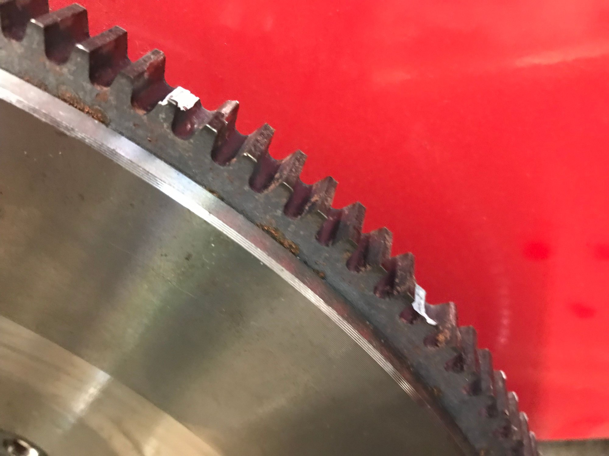

Let me catch everyone up since my last update.
Start off with putting everything back together no issues till it came to the flywheel. Unfortunately when the engine locked up it blew some teeth off the flywheel which I didn’t notice till reassembly. Sent back to Monster and the put a new ring gear on for about $100.

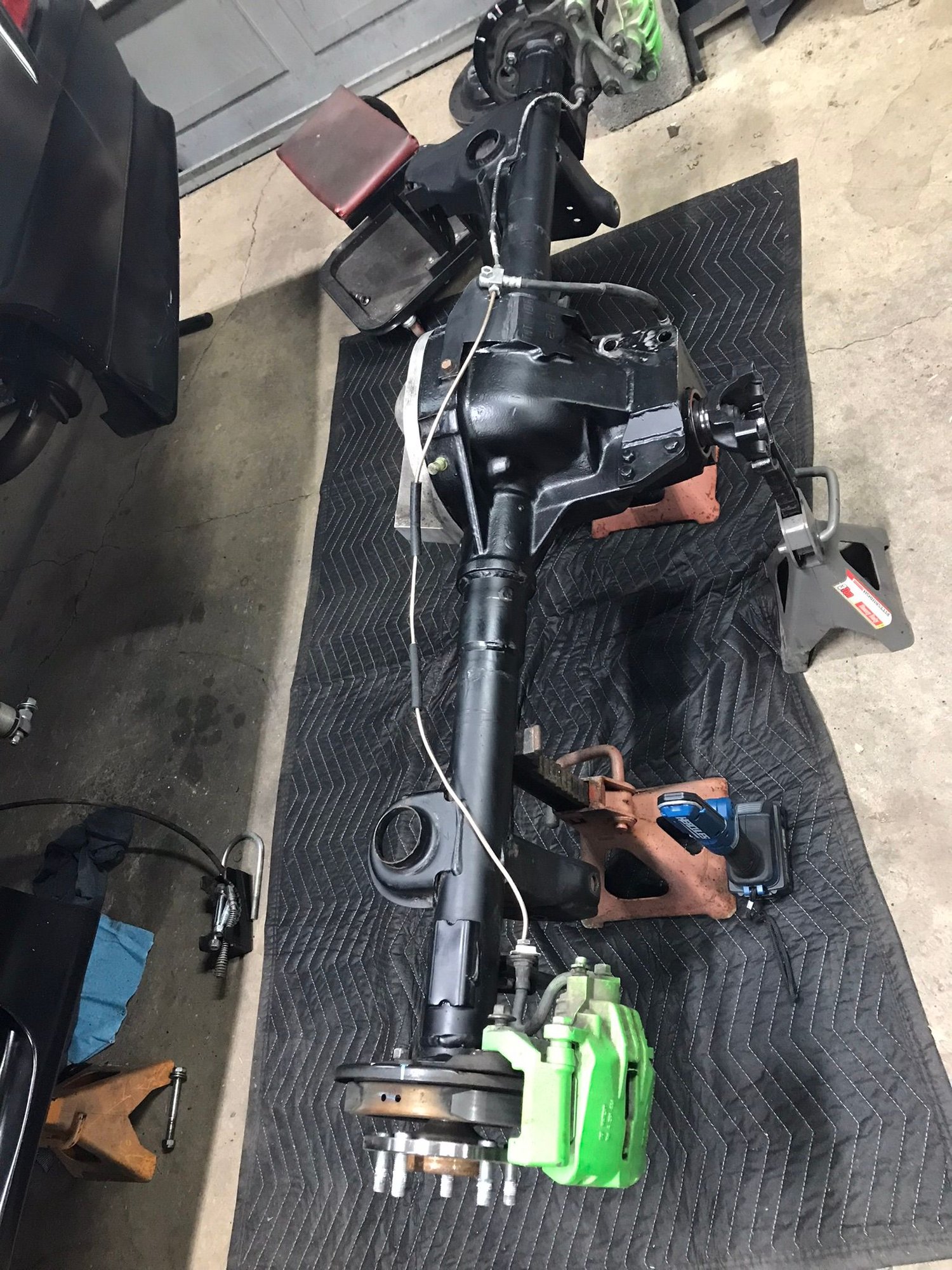

RIP torque arm you will NOT be missed!
Replacing the 3.73 gear for 3.31 while it’s out

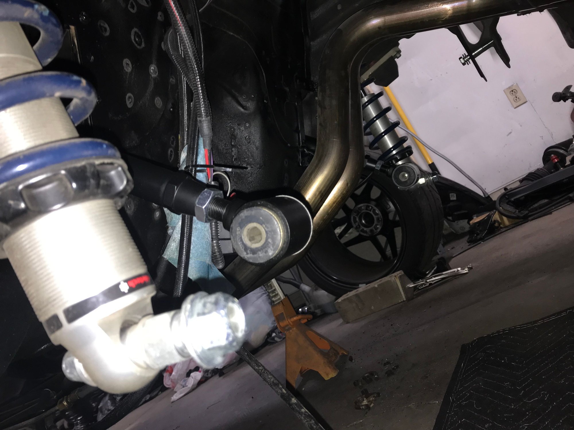

Upper arms are in.

Did you take more Photos of the Installation Process?

DSE has the how to start to finish video on YouTube

I have installed very similar kits in a few Third Gens (Maybe four Cars)...
I believe that they were all Tubbed and without Rear Seats.
The difference in the Strength/ Support of the Rear-Floor and Seat-Back Areas is INCREDIBLE!
It's also just highly interesting to see a Parallel Double-Adjustable Four-Link Rear Suspension in these Cars.
I still prefer the Torque-Arm Design over this Design Suspension, however it is still cool to see!
With all the Aftermarket Rear Suspension Support that has been available for Third Gens...
The Tubular Adjustable Stock Design Rear Suspension is actually great!!!

The torque arm has always been a love and hate thing with me. The factory piece is small and easy to work with until you make more power or they break with stock ls1 engine power. The do work great for straight line stuff or long course along with fun street driving. But the short course the just suck. I didn’t really just have one reason to ditch it so I will just list my issues which some are of my own doing.
The bolts always came loose at rear which then caused noise. Aftermarket arm is bigger and rubbed tunnel. The main issue is with the crossmember mount it just plan sucks fighting with the 4 bolts the hold the clam shell anytime I want to drop the trans it doubles the time.

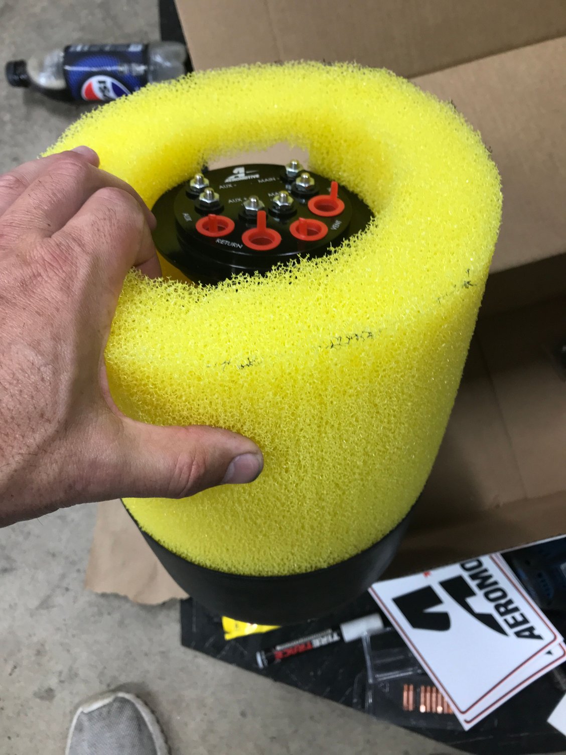

Old May 19, 2024 | 07:48 PM
  #344
obeymybird's Avatar
Posts: 1,130
Likes: 59
From: PA
Car: 92 camaro RS
Engine: LSA
Transmission: Magnum F
Axle/Gears: TNT 8.8 wavetrac 3.31
Re: LY6 carnage

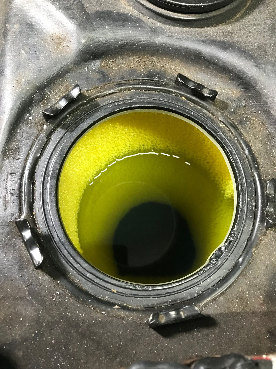

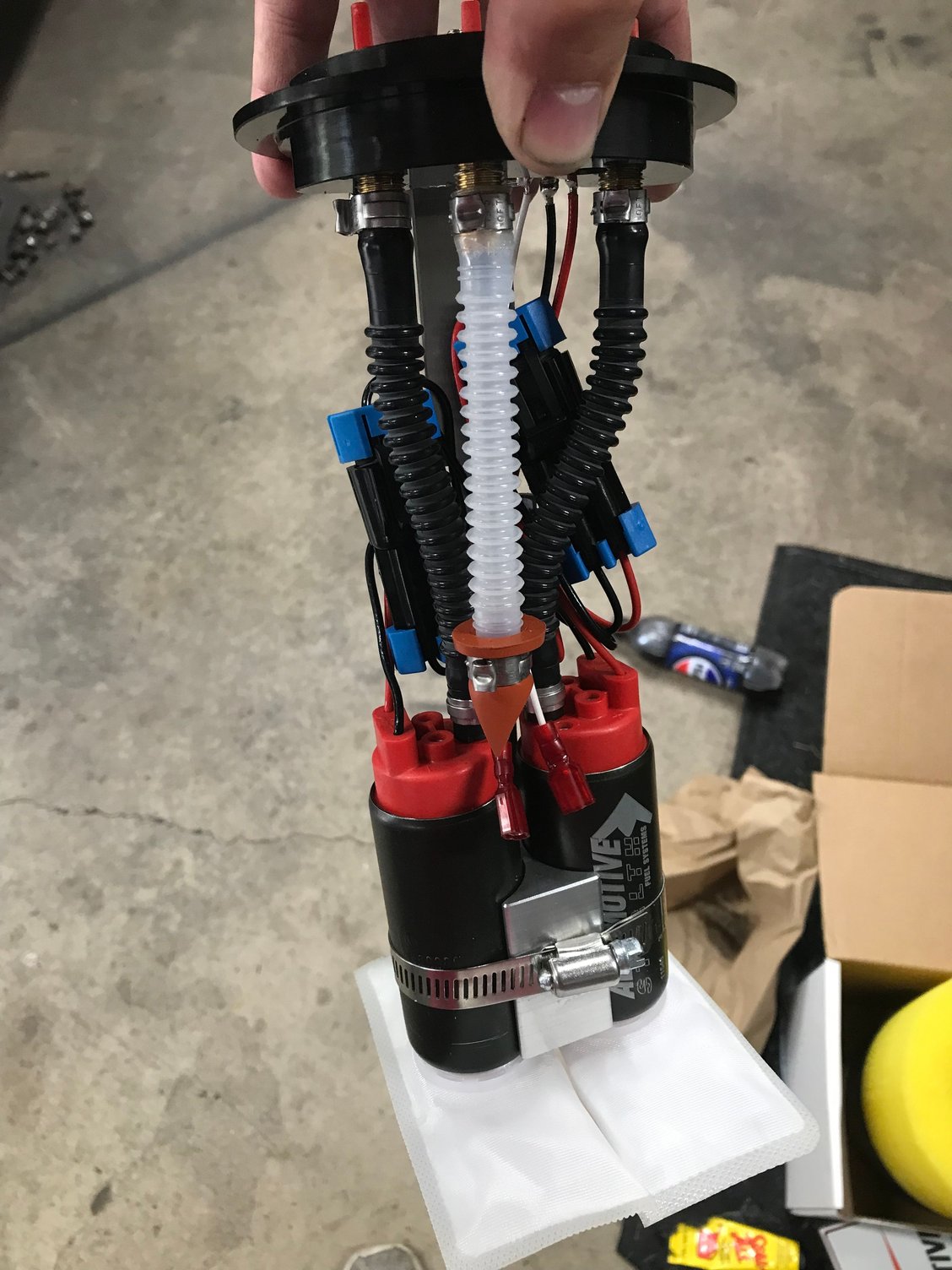

Rearend is back in and buttoned up.
Next I decided to pull the hellcat fuel pump and switch over to a aeromotive dual 340 setup. Need to order fittings as it comes with zero.

Re: LY6 carnage
I would be weary of the yellow foam. I’ve seen lots of posts of that stuff breaking down and clogging filters.
Old Jul 23, 2024 | 11:07 AM
I did see some issues reported about the foam so thanks for the heads up.
