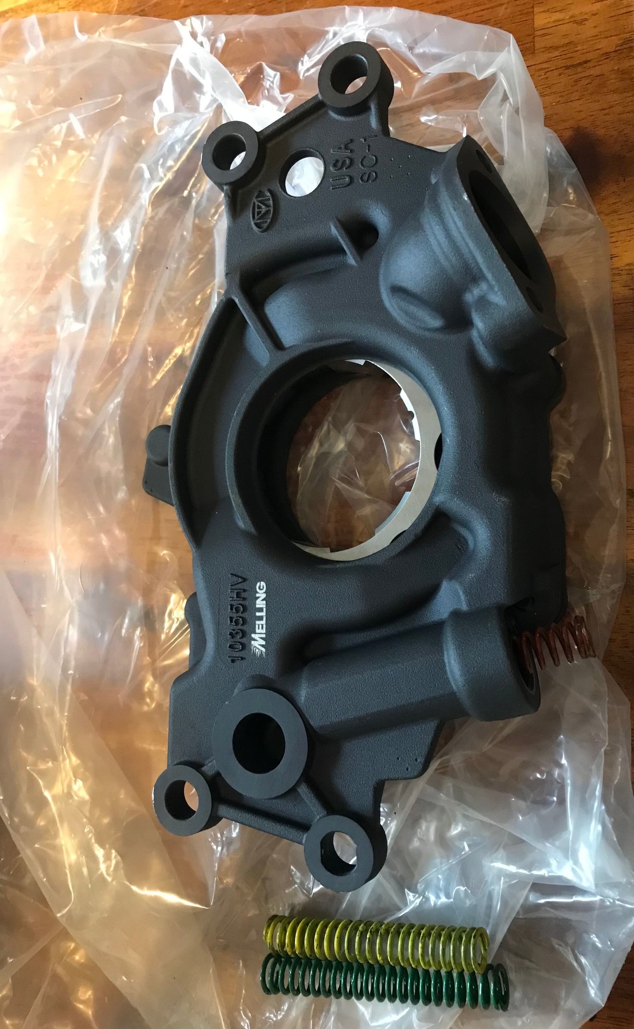

Pump showed up yesterday so going with the green spring for some extra oil pressure.

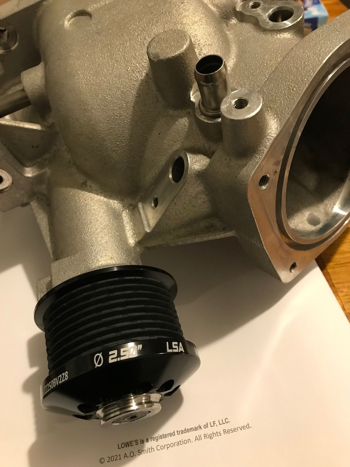

Got fresh oil in the blower today along with getting the new hub pressed on. Was stuck on which upper pulley to go with between 2.55 or 2.45 so split it and got a 2.50.

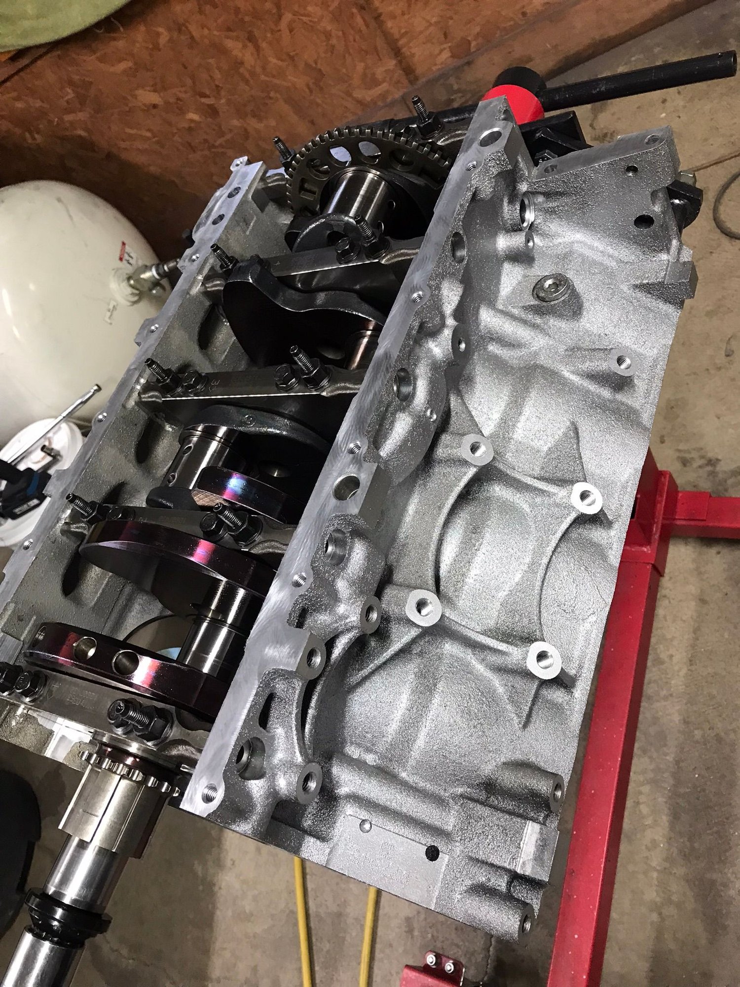

6.2 pulled apart about ready for a fresh hone then hopefully going right back together.

It may be the Image...
But the Main Bearings do not look too good.
Old Apr 2, 2022 | 07:29 AM
  #211
obeymybird's Avatar
Posts: 1,132
Likes: 59
From: PA
Car: 92 camaro RS
Engine: LSA
Transmission: Magnum F
Axle/Gears: TNT 8.8 wavetrac 3.31
Re: LY6 carnage
Yep the LSA engines are very hard on the rod and main bearings. The cts-v forums are full of spun bearing posts and I have new king bearings on stand by.

Did ya spend $30 on a set of Bearings?
Old Apr 17, 2022 | 07:03 AM
  #214
obeymybird's Avatar
Posts: 1,132
Likes: 59
From: PA
Car: 92 camaro RS
Engine: LSA
Re: LY6 carnage
More like $150.
Picking up a pilot bearing and front cover seal today then I can button up the bottom end.

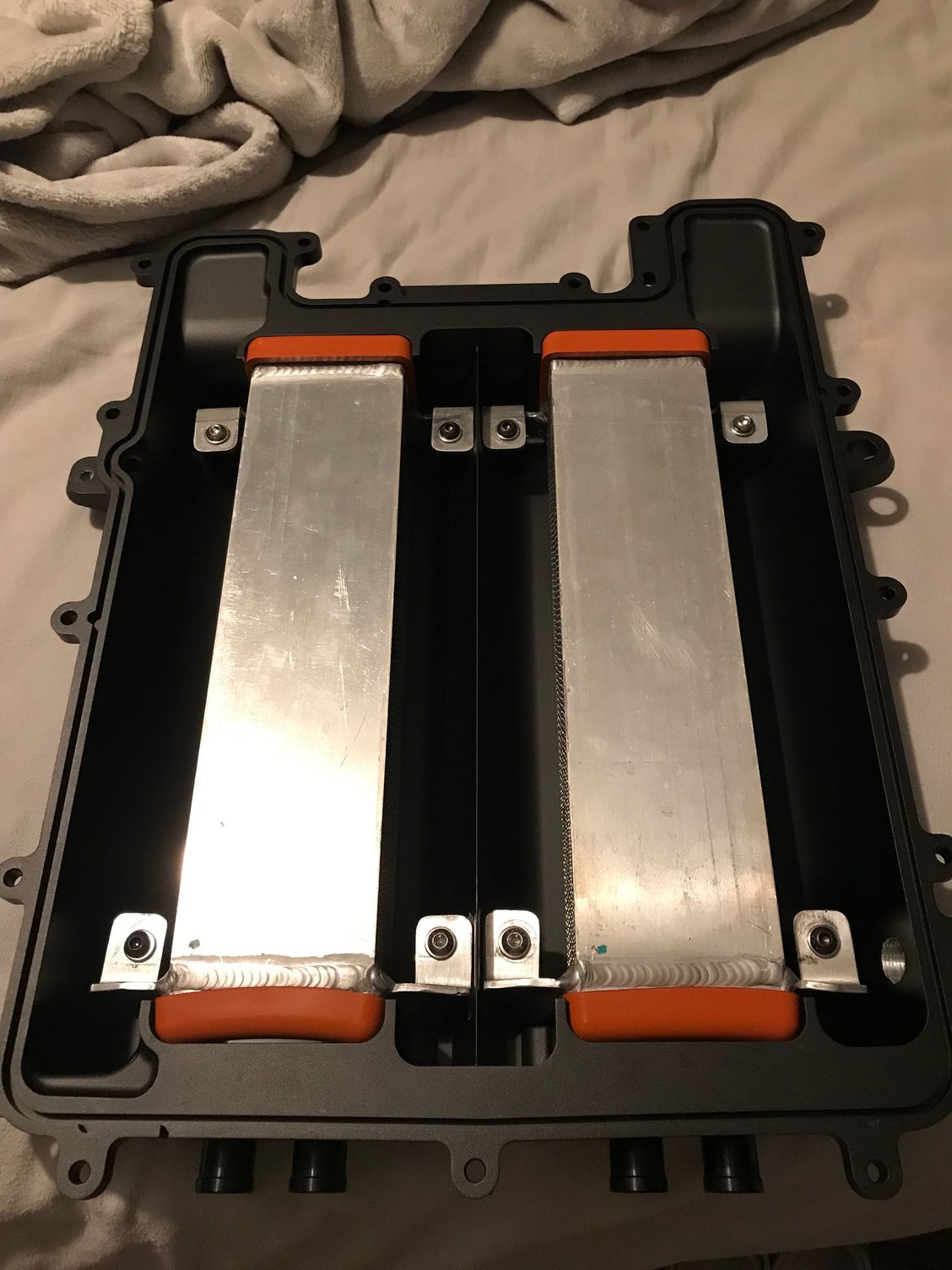

When I started kicking this build around in my head I knew there was going to be a few big money parts that was going to hurt the wallet but so far I got most of them bought and got a decent deal since I creep on several other forms.
Needing a 8 bolt clutch hurt since my moster twin is basically new still and a new 8 bolt goes for $1,200 and up. I scored a Mcloed RXT for $800
Used LSA supercharges go for $1,400 plus. Got mine for $1,000
Supercharger brick $1,100 for the one Im using. Used $650
Supercharger lid around a $1,000 and up but still hunting for this but im going a different direction then most for the lid

Why is your crankshaft purple?

Re: LY6 carnage
That is the "Normal" appearance of the GM Stock (Heat/ Surface Treatment and Stress Relieving) Forged LSA Crankshaft.

Re: LY6 carnage
Yep what vortec said. LS9 LS7 LSA and Im pretty sure the c6 grandsport ls3 with the dry sump got the forged crank as well.

My LS7 crank is dark like that too.

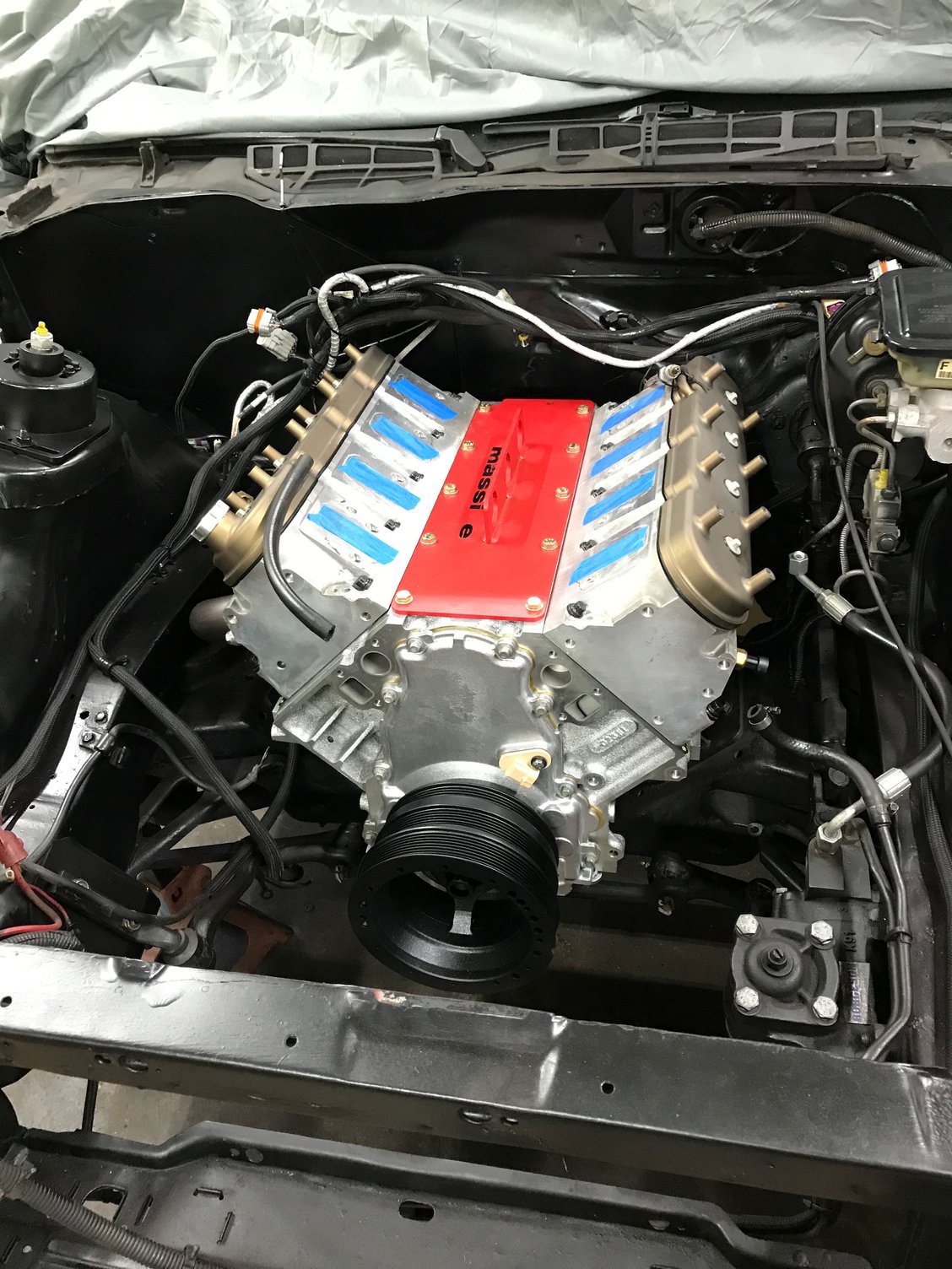

Time to bolt on some heads

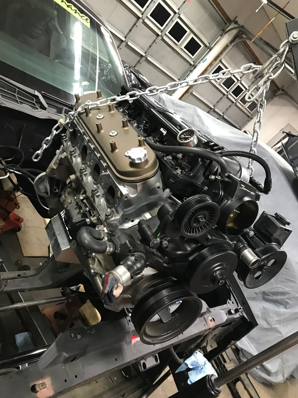

Got the heads bolted down over the weekend. Next up will be small things cam an crank sensor then motor mounts. Then clutch assembly with trans following.
Hope the spal fan is on par with the hype had to go with a 14” cause I’m using the smaller c4 corvette radiator more to come on that later.

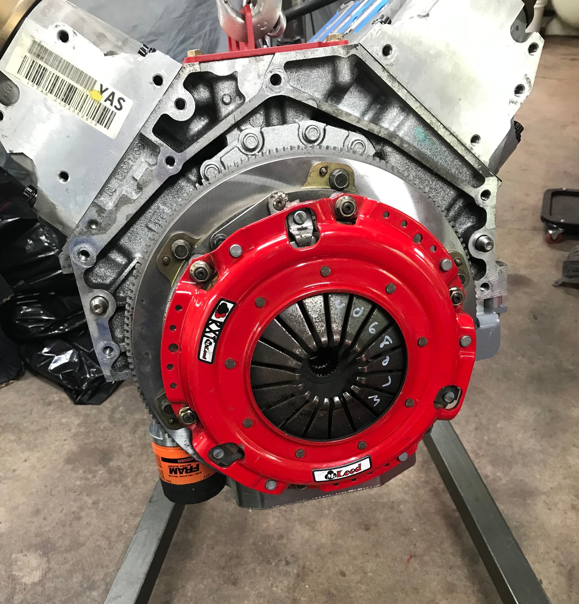

Ran into a big road block with RXT LSA clutch thats setting me back more money and two more weeks. I need a 8 bolt flywheel so that didn't leave me much of a choice so long story short the lsa clutch wont work with the older style T56. Monster is cutting me a 8 bolt flywheel now to go along with there twin disk kevlar kit.

Just for my learning, what was the issue encountered trying to mix those parts?
Old May 24, 2022 | 07:49 PM
  #231
obeymybird's Avatar
Posts: 1,132
Likes: 59
From: PA
Car: 92 camaro RS
Engine: LSA
Re: LY6 carnage
With the Mcleod flywheel and clutch the overall thickness was way to much resulting in so much throwout bearing contact that the T56 wouldn't go into the bellhousing. And im not talking like 1/4 or 1/2" more like two inches lol

Ran into a issue when I went to test fit the G8 alt and PS. Big issue was with the PS bracket it just mounts the pump to low on the head which puts the pulley into the steering box. I got a cts-v bracket coming to see if this can work.
I ordered a racetronix fuel regulator and some fittings from them. Best prices
I have all of the lsa drive installed just need to put the belt on.
