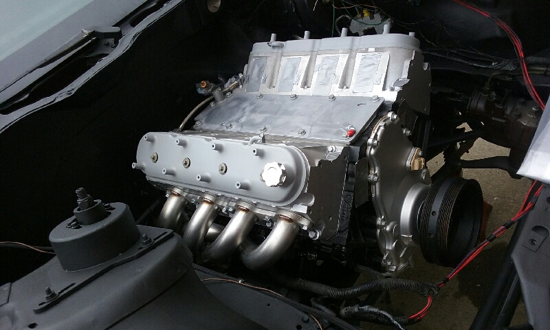

Back from the shop I got a hole pile of parts sitting hope to get started in the next week or two.

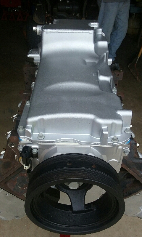

GM muscle car oil pan mod. need to get some paint on this block yet.
Attached Thumbnails LY6 carnage-20160803_111403.jpeg   LY6 carnage-20160803_111416-1-.jpeg

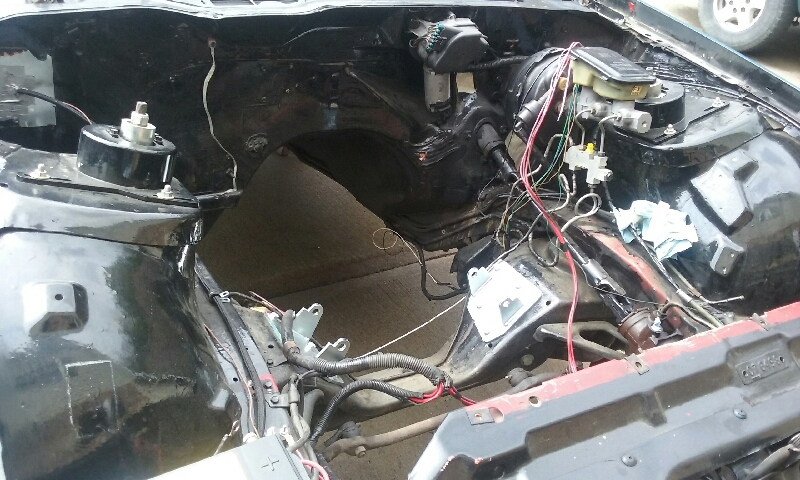

Slow moving build cash is always tight. Picked up LS7 clutch and flywheel bought a LS mid plate and bellhousing and a viper spec input shaft to swap over my lt1 t56 to ls specs.

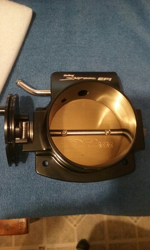

Few more goodies showed up not to happy that the t/b came with a stripped screw for the blade but doubt i will ever touch it anyway. 1 7/8 headers yes please didn't come with gaskets also would have figured the header bolts would have been stainless but o well.

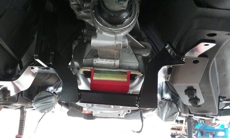

OK had a few small changes since i was going with hooker headers and planned on there trans mount as well i went with there motor mounts and dual exhaust kit. Mounts installed then moved on to weeding out some old wiring that wasn't needed anymore.

Had a small set-back when we tried to mate t56 to motor learned the hard way by installing wrong pilot bearing first one was a LS3 large bearing after some searching i see this happens alot but a LS1 small bearing fixed it right up.

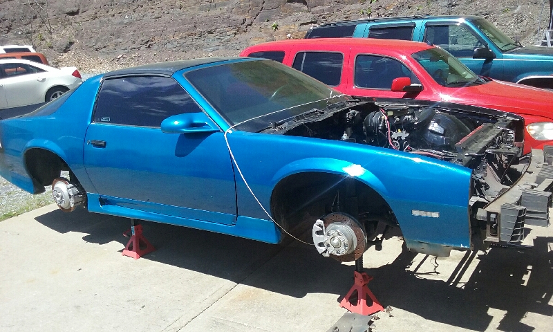

The front fenders are getting replaced so started with the front bumper which makes for a little easier motor install.

Then this happened fits like a glove driver side header went in so fast it was mind blowing lol passenger side was tighter without starter in took a few wiggles and a bump and was good. Starter was tight going past headers and block but still went up in.

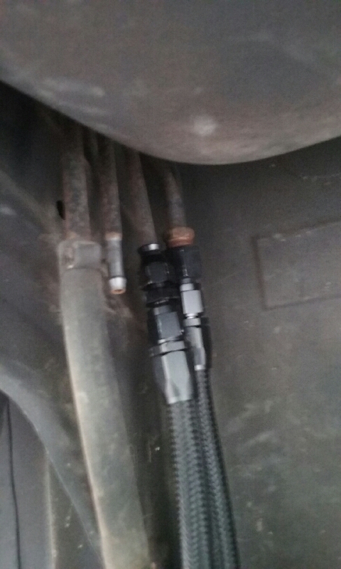

After looking at many LSX swaps this is how i ended up mounting my fuel filter. Nothing real fancy used stock bracket just moved it up higher and turned it to give me a better angle for the lines.
Attached Thumbnails LY6 carnage-20170606_160848.jpeg   LY6 carnage-20170606_160908.jpeg

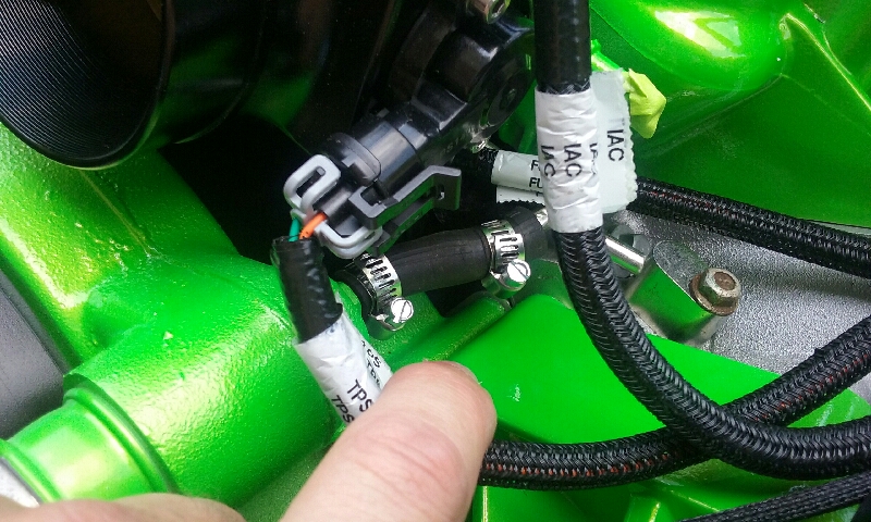

Water pump tapped for steam line hookup.

This is coming together nicely!
I love and hate how you did the steam line mod..... I love it because it is neat and out of sight unless you point it out. Hate it because I didn't think of it! LOL
