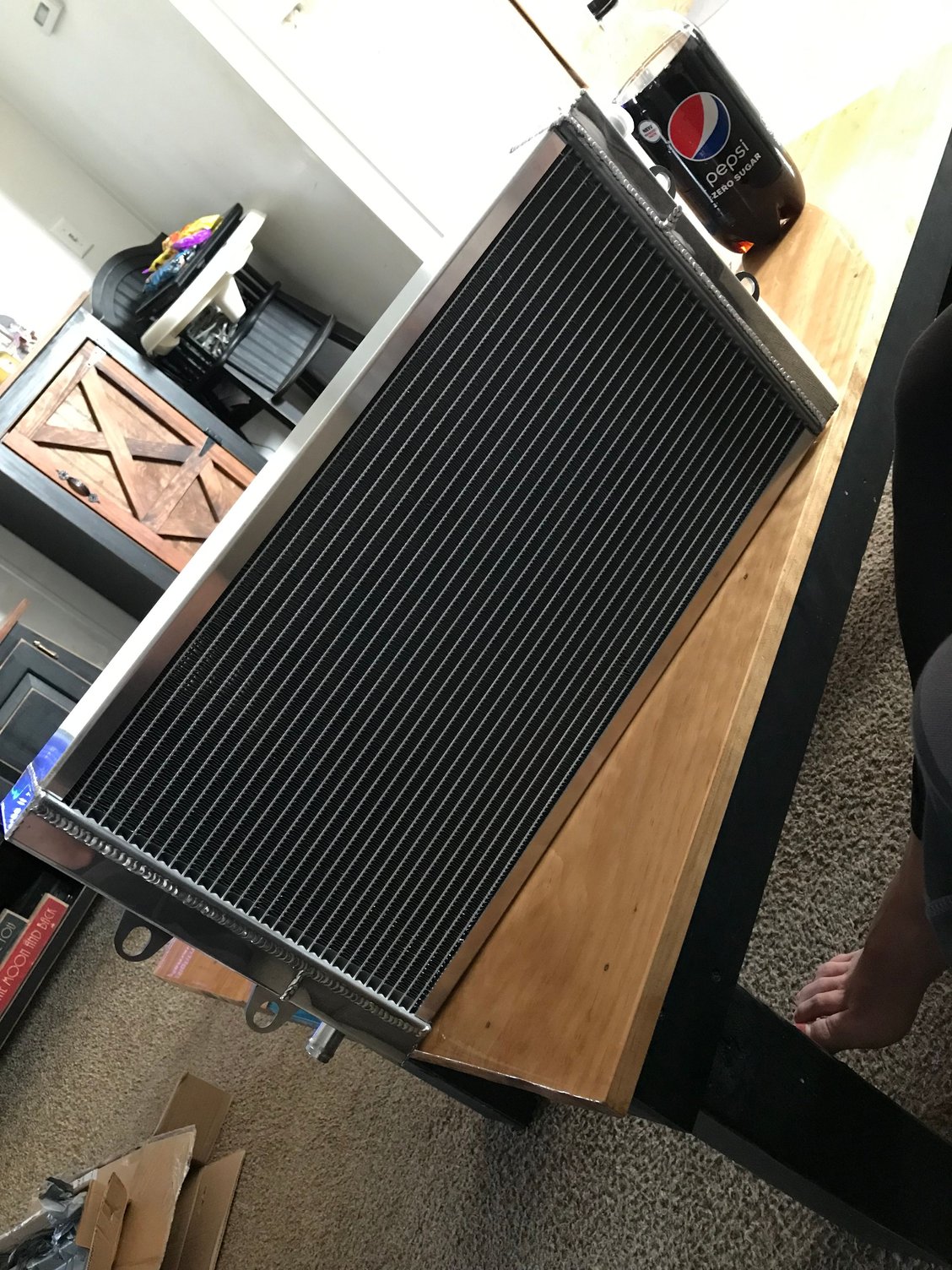

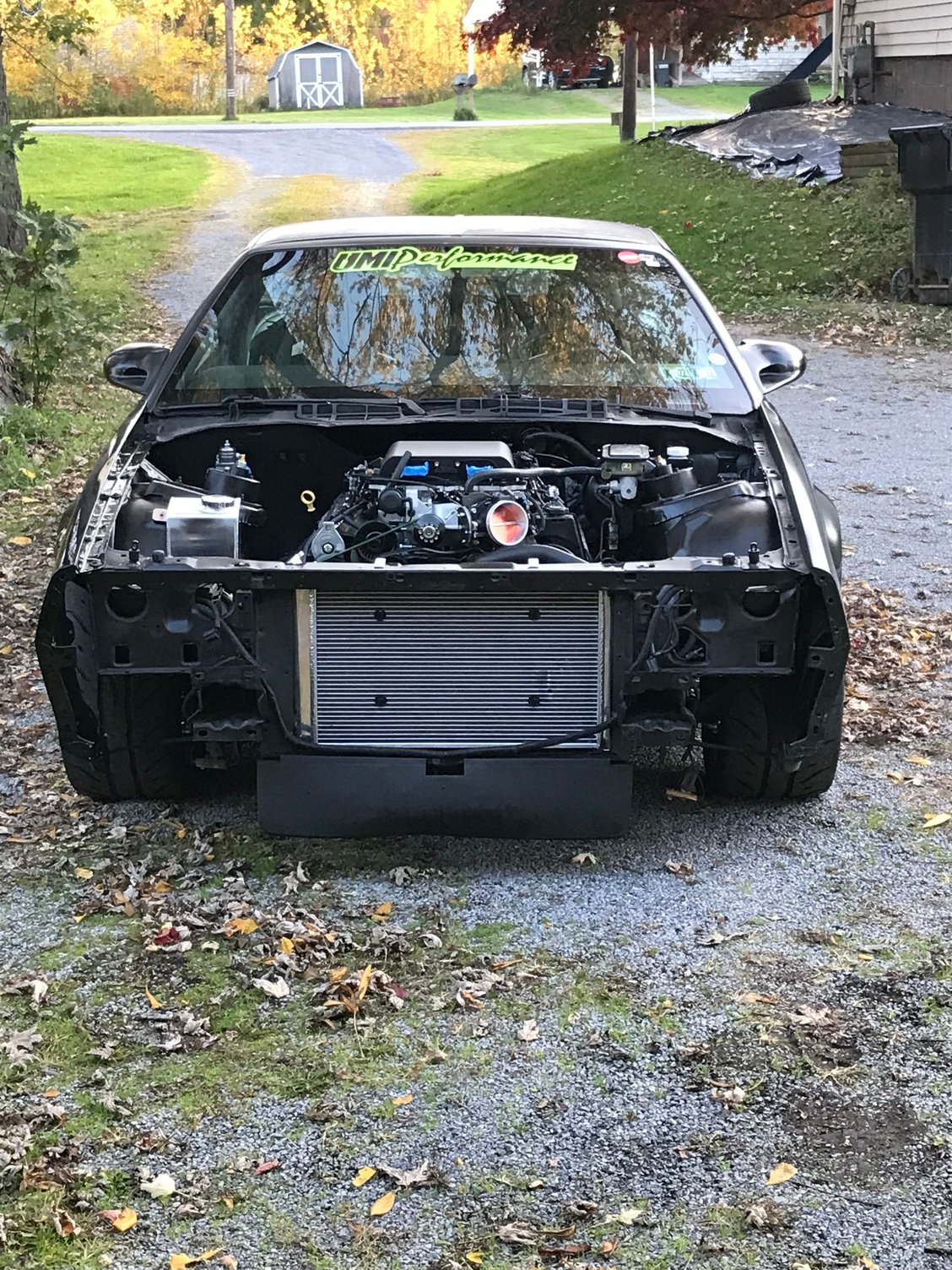

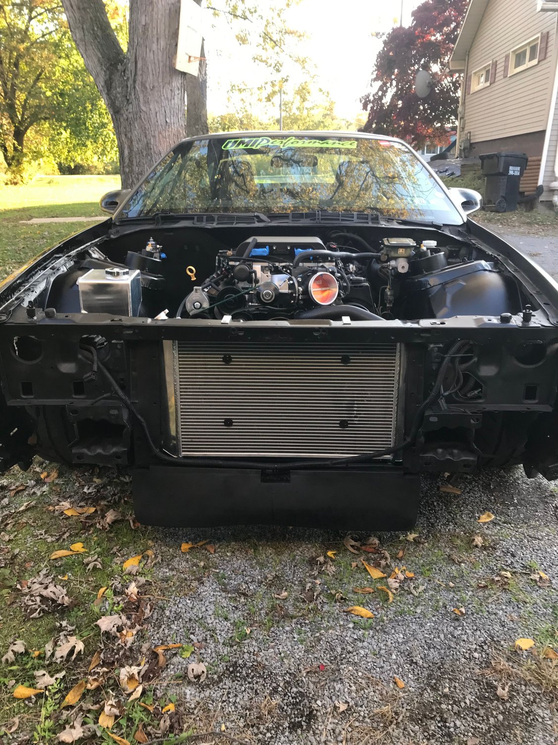

Finally made it out of the garage this year. Here you can see the low profile C4 radiator installed and the main reason for this was to make room for the air intake and filter to pass over top like the newer corvettes since engine bay room is getting tight. New T/B cable installed fits great and tucked neatly.
I definitely want to see the details on this. Always wanted to have a C6 Z06 Halltech intake but never had the skill or gumption to do it.

Re: LY6 carnage
Yes Sir thats what I was thinking to. I was going to buy a used C6 stock setup for test fitting but I want to try to make my own and see how it turns out.

Auto trans has been on my mind a long time too, but now that I have the trans I'm a little shocked how much work it is to change over. We'll see where that goes.
Definitely keep us posted on the forward air ducting project. I am very interested!

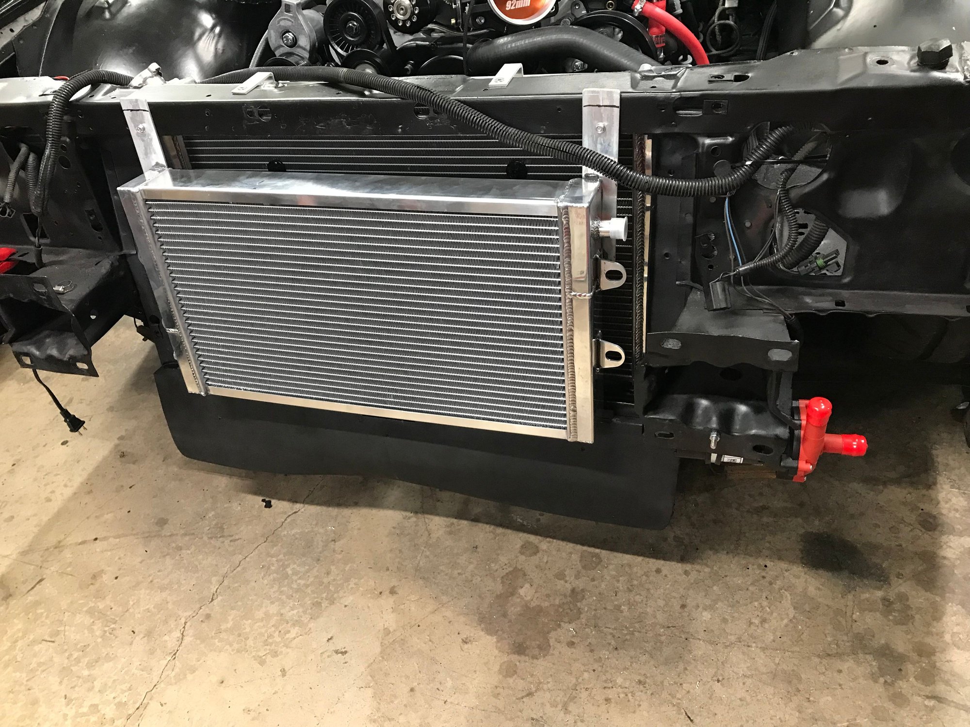

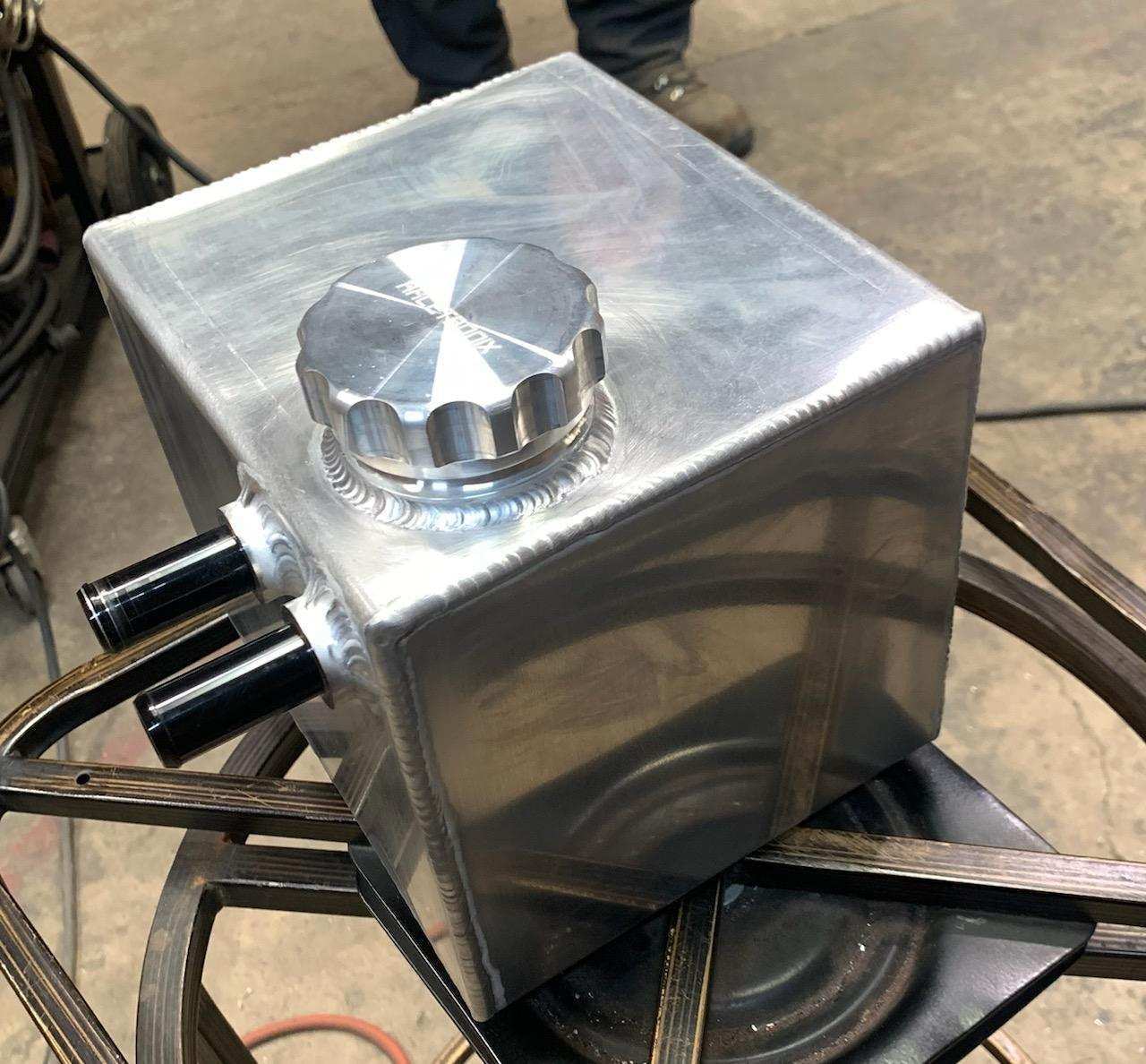

I am not familiar with this Halltech intake...
What is the deal?
Is there significant fabrication work involved... what am I missing?
I have completely moved away from all other types of Inter-Cooling...
And now ONLY build Refrigerant (Air-Conditioning) Inter-Coolers.
Nothing else compares!!!
I think about all the years that I spent removing/ deleting Air-Conditioning Systems from Cars...
To now Install them into more Cars that I can count.
Whats funny...
Is that I don't actually install a complete A.C. System (for People in the Cabin to use)...
I only install the Compressor and the Refrigerant to Water/ Coolant Chiller.
Connect it up to one of these:
Now ready to Rock and Roll!!!

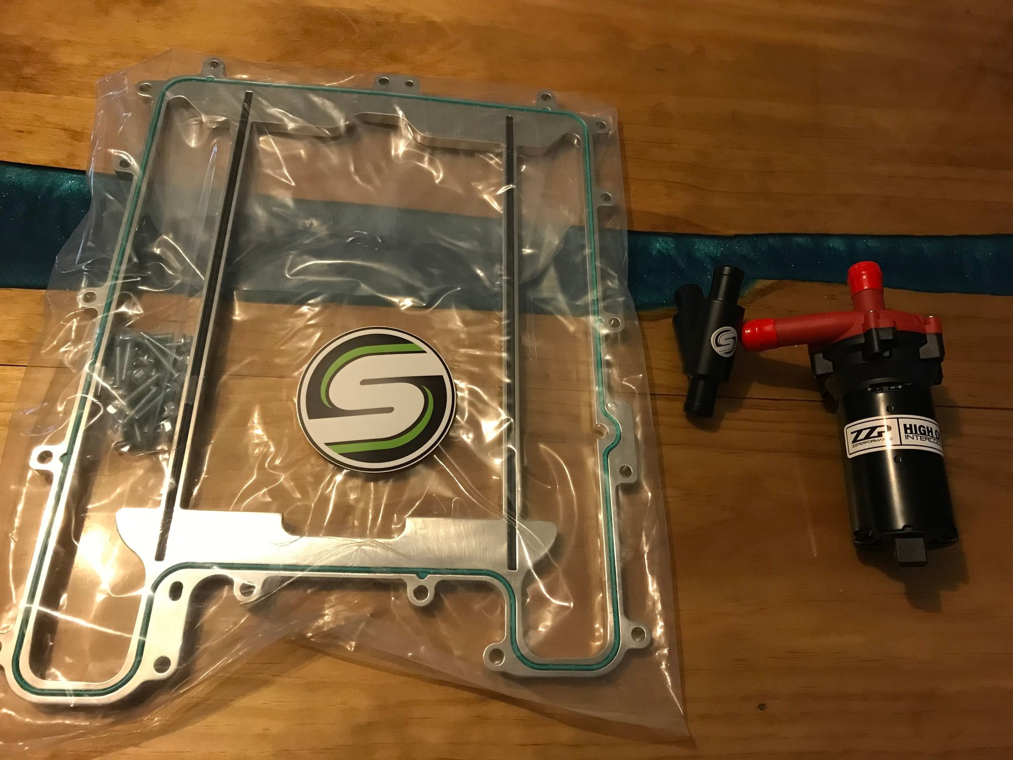

Re: LY6 carnage
Still waiting on my 6th gen ZL1 heat exchanger to come and cts-v power steering pump.
Synergy lid spacer/adapter looks very nice and picked up one of there 3/4” water line splitters to feed the dual bricks. ZZP intercooler pump to keep that water flowing.

Re: LY6 carnage
PLM 6th gen zl1 XL heat exchanger
Old Feb 15, 2023 | 06:17 AM
  #278
obeymybird's Avatar
Posts: 1,125
Likes: 55
From: PA
Car: 92 camaro RS
Engine: LSA
Transmission: Magnum F
Axle/Gears: TNT 8.8 wavetrac 3.31
Re: LY6 carnage
Motionrace works valve covers still need to order a catch can from them yet.

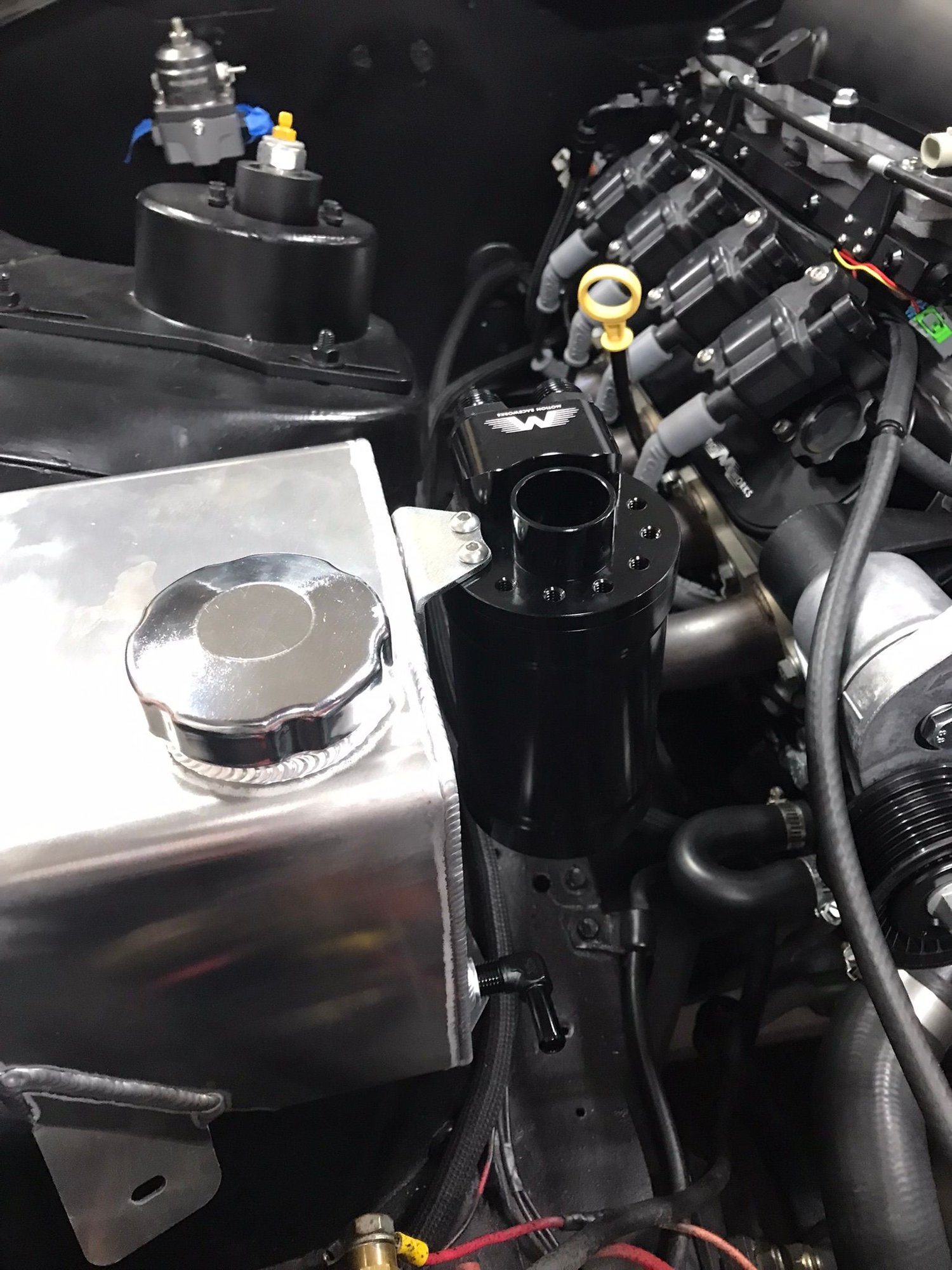

Re: LY6 carnage
Lid spacer installed along with valve covers. From what the warehouse said I got the last GM ctsv power steering pump in the country. Next will be mounting the heat exchanger.
Old Mar 7, 2023 | 10:21 AM
  #289
ShiftyCapone's Avatar
Supporter/Moderator
Posts: 13,753
Likes: 560
From: Cincinnati, OH
Car: '90 RS
Engine: 377 LSX
Transmission: Magnum T56
Re: LY6 carnage
Looking great. Do those valve covers have baffling in them?
Old Mar 7, 2023 | 10:53 AM
  #290
obeymybird's Avatar
Posts: 1,125
Likes: 55
From: PA
Car: 92 camaro RS
Engine: LSA
Re: LY6 carnage
Yes best baffles I have seen.
Old Mar 7, 2023 | 06:06 PM
  #291
vorteciroc's Avatar
Top Answer: 1
Joined: Jul 2006
Posts: 2,863
Likes: 789
From: 212 is up in this Bit@#
Re: LY6 carnage
Looks Great!!!
Try to run your Catch-Can Hoses from the front of the Valve-Covers...
This way most of the Oil will go towards the rear of the Engine under acceleration and drain back down.

Re: LY6 carnage
Quick test fit for the catch can location and I’m liking it. I will be running -10an lines from the covers to can.
Old Mar 16, 2023 | 01:50 PM
  #293
vorteciroc's Avatar
Top Answer: 1
Joined: Jul 2006
Posts: 2,863
Likes: 789
Re: LY6 carnage
I VERY STRONGLY recommend going with at least -12AN Lines if you can.
You really want to have some large Hoses here...
Engines making over 12 - 15 PSIG Boost should have -16AN Hoses.
Old Mar 16, 2023 | 03:23 PM
  #294
obeymybird's Avatar
Posts: 1,125
Likes: 55
From: PA
Car: 92 camaro RS
Engine: LSA
Re: LY6 carnage
All the -10 stuff is on order. Remember this is just a street car 98% of the time

Re: LY6 carnage
Heat exchanger and pump mocked up into place. Expansion tank finished up and ready for powder coating.

Re: LY6 carnage
She moves some water very happy with this setup.
I booked my dyno tune for May 1st with Late Model Performance

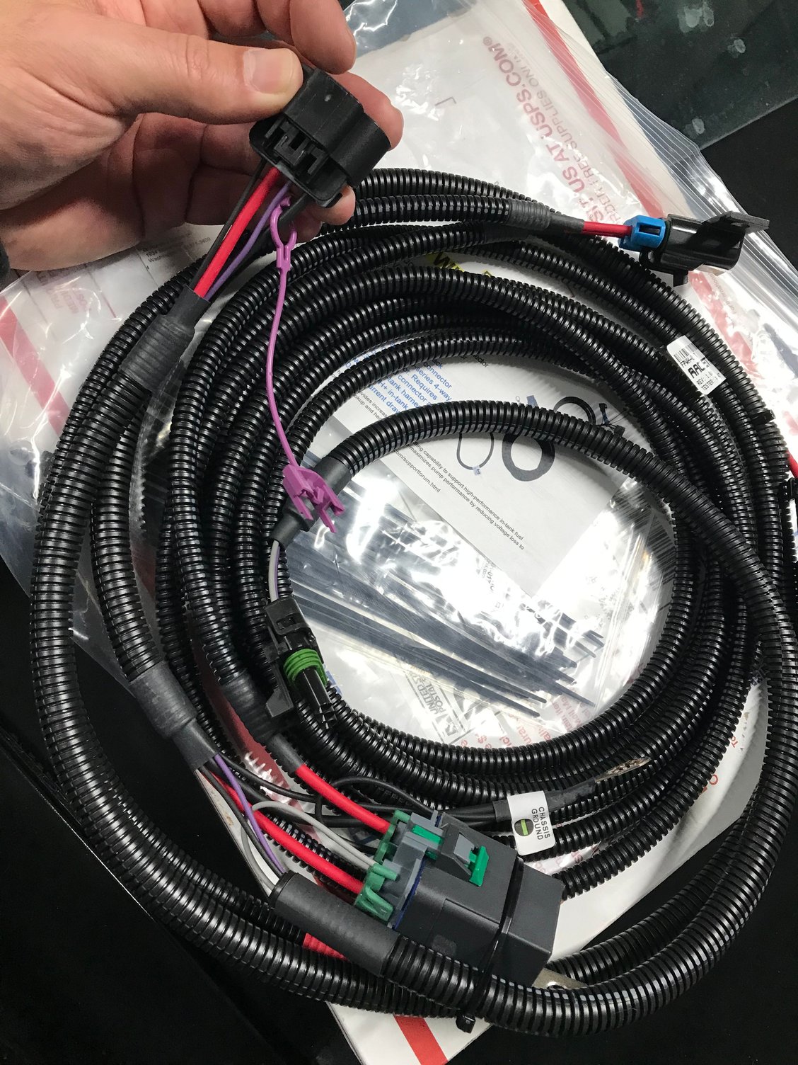

Let me start off with some good before the bad crap kicks in.
QwkTrip hooked me up with a custom fuel pump harness and I couldn’t be happier. It was a true simple plug and play deal and with the addition to some new herko fuel sender parts I know seem to have a working fuel gauge after all these years.
Old Apr 29, 2023 | 10:49 AM
