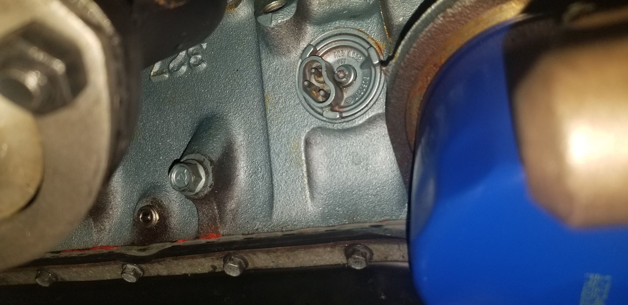

Trying to finally finish my lt1 swap and im stuck. Putting coolant in the car and its leaking from what looks like a sensor in the block above the oil filter. Anyone know what the sensor is and why its leaking coolant?

Its a round plug in the block drivers side, it looks to have 3 prongs in a semi u shape and a square piece the coolant is coming out from, i can put my finger on the square passage and stop the coolant leak

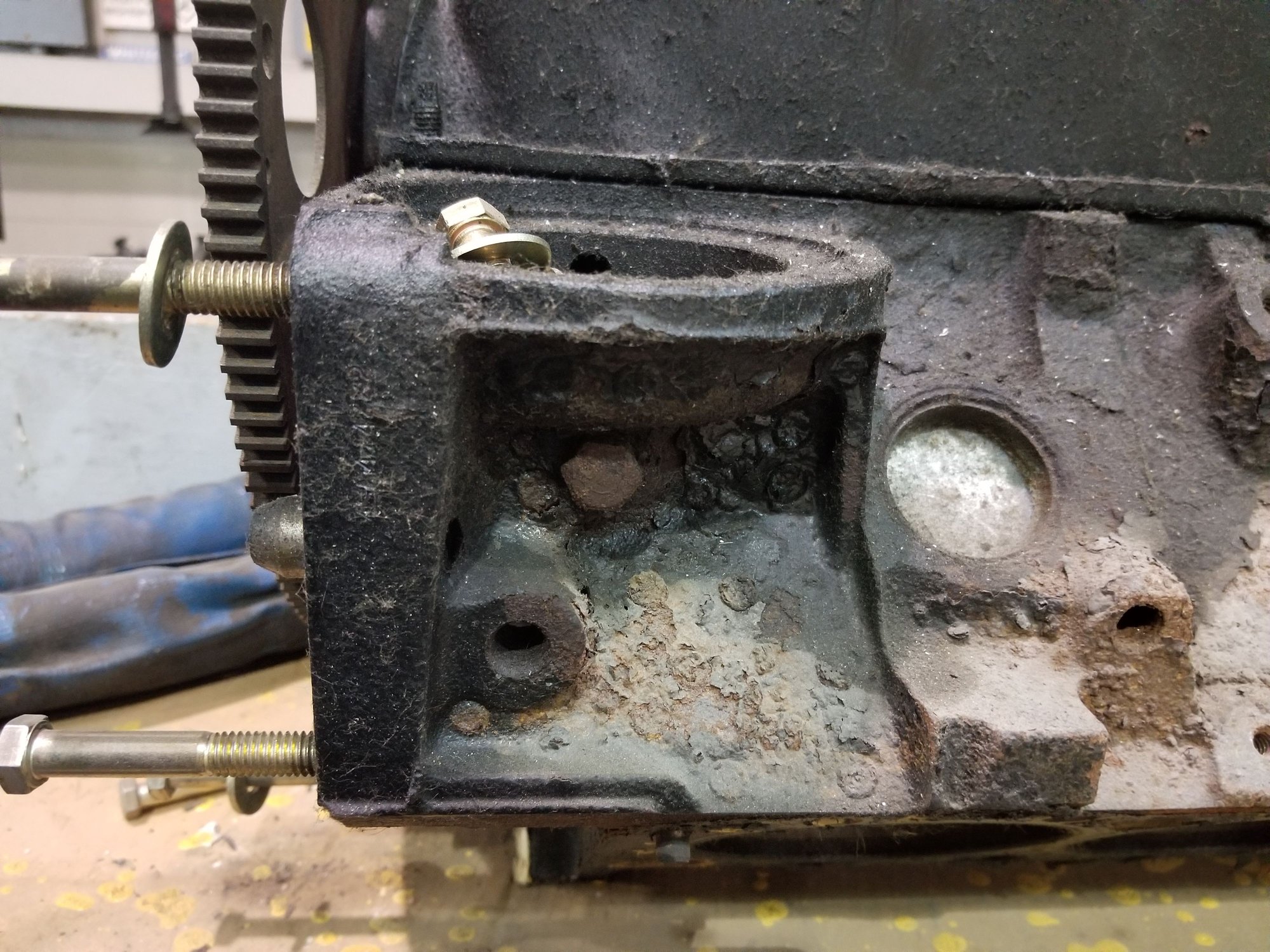

there's only 2 ports above the oil filter. I have a crusty LT1 sitting in front of me. One is an oil port and the other goes straight through to the flywheel.

That should be closed. It should be blind and there shouldn't be a sensor in it. Both LT1's I have sitting are like that. Maybe someone did some rigging at some point? The only thing tapped into coolant on the side of block is the drain that got used for the knock sensor. Can you take a picture? It'll probably help us help you.

Old Jun 2, 2019 | 11:07 AM

Old Jun 2, 2019 | 11:32 AM

Its a block heater, i looked up the number off it and found it online, looking closer at the picture it looks like there is a center screw and its open, i wonder if it just needs closed

I thought you meant the hole near the freeze plug, My mistake. Totally a block heater. Could be loose, could have a bad seal. Not difficult to remove but a pain to install new freeze plug as it sits in the car
