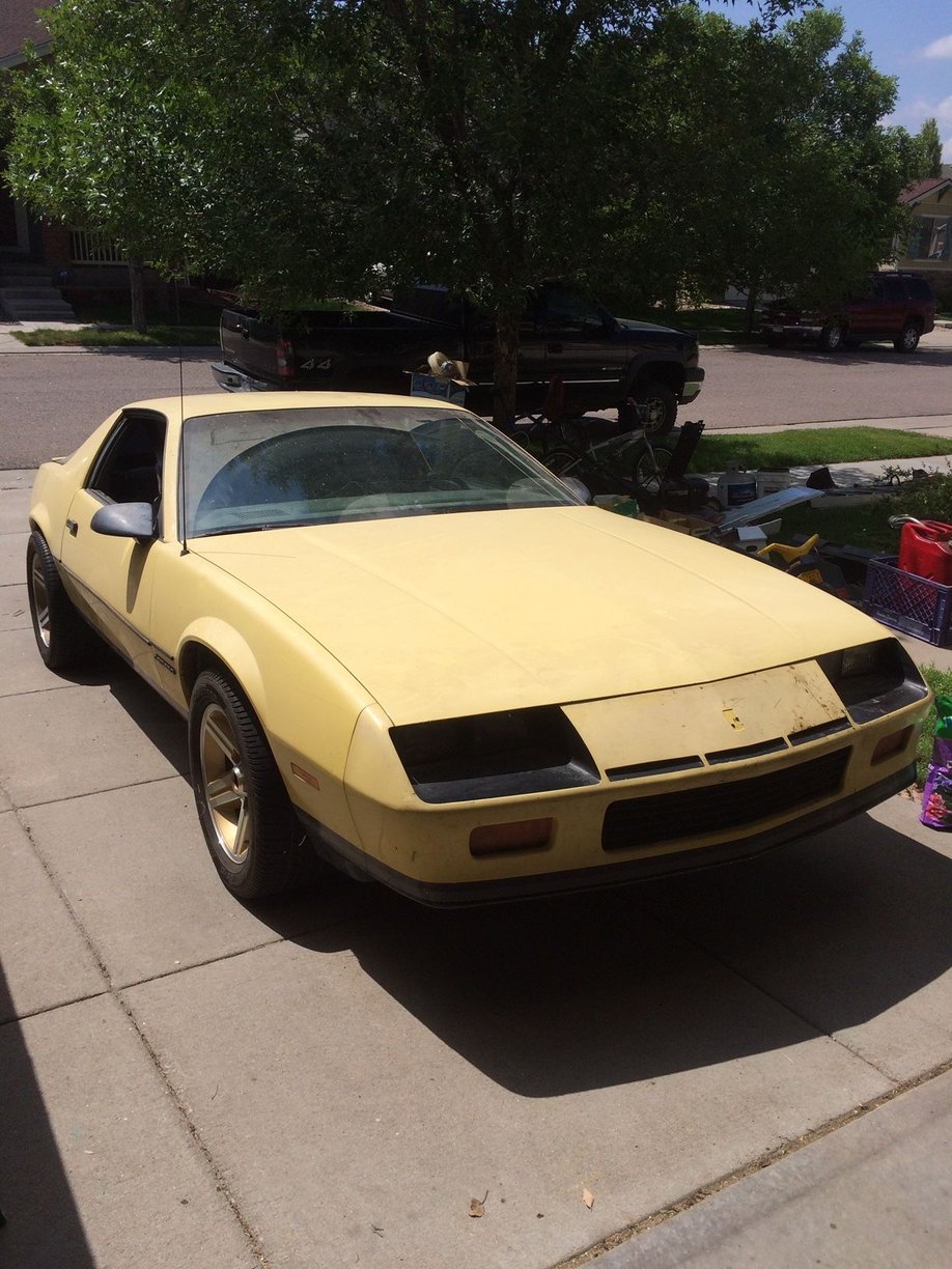

Hola Everyone, maybe I'm missing it in my searches or I'm just dumb, but how are you guys with LS swaps getting around emissions? I'd like to run long tubes, but thinking this wont be an option. Don't want to pay 12k for the LS3 E Rod kit. I live in Colorado where emissions is required and this is my Camaro that I built back in 1995. Currently it has a TPI 5.7 with a Tremec trans. Really wanting to LS it with a T56. Thanks everyone!
