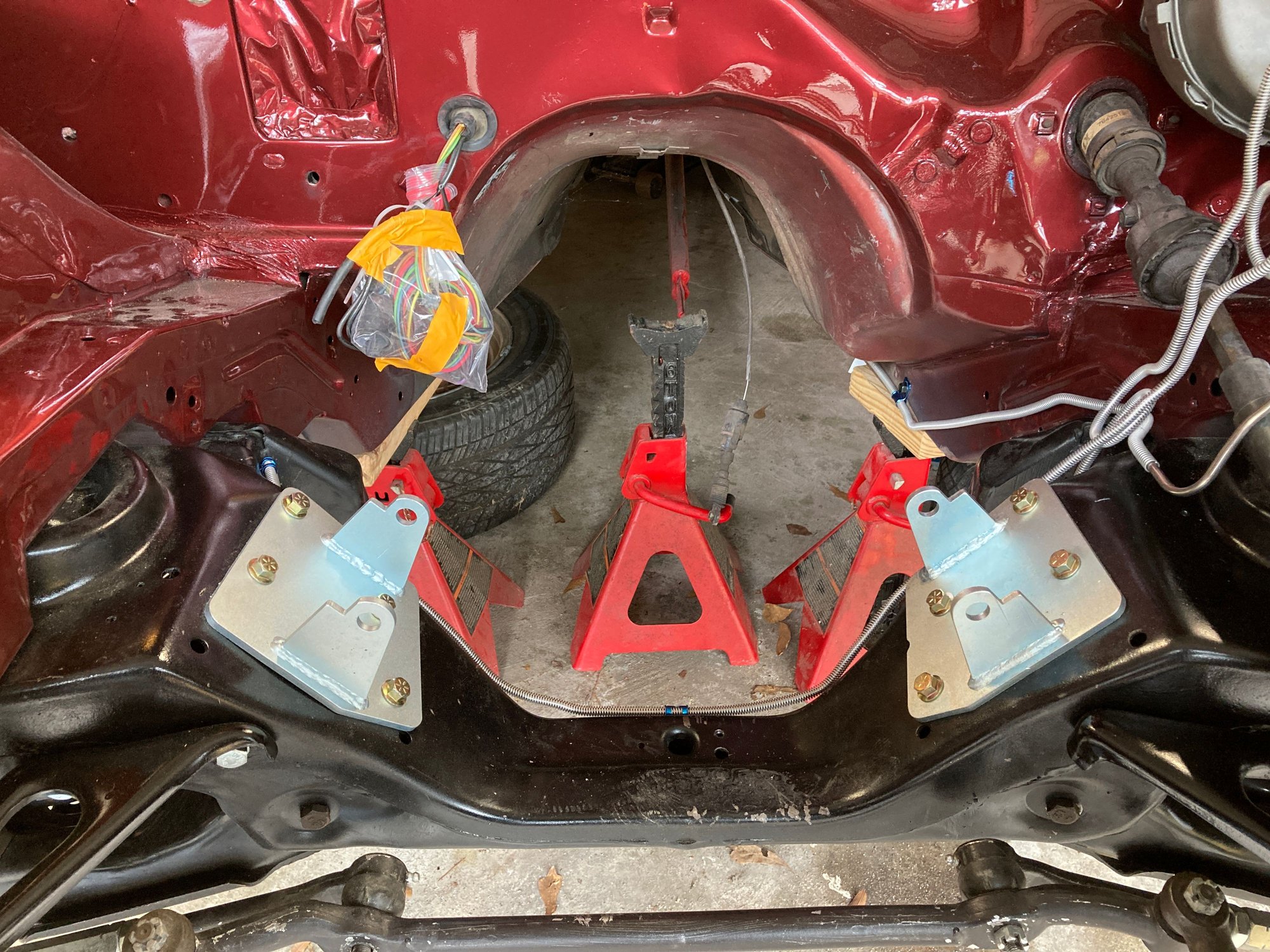

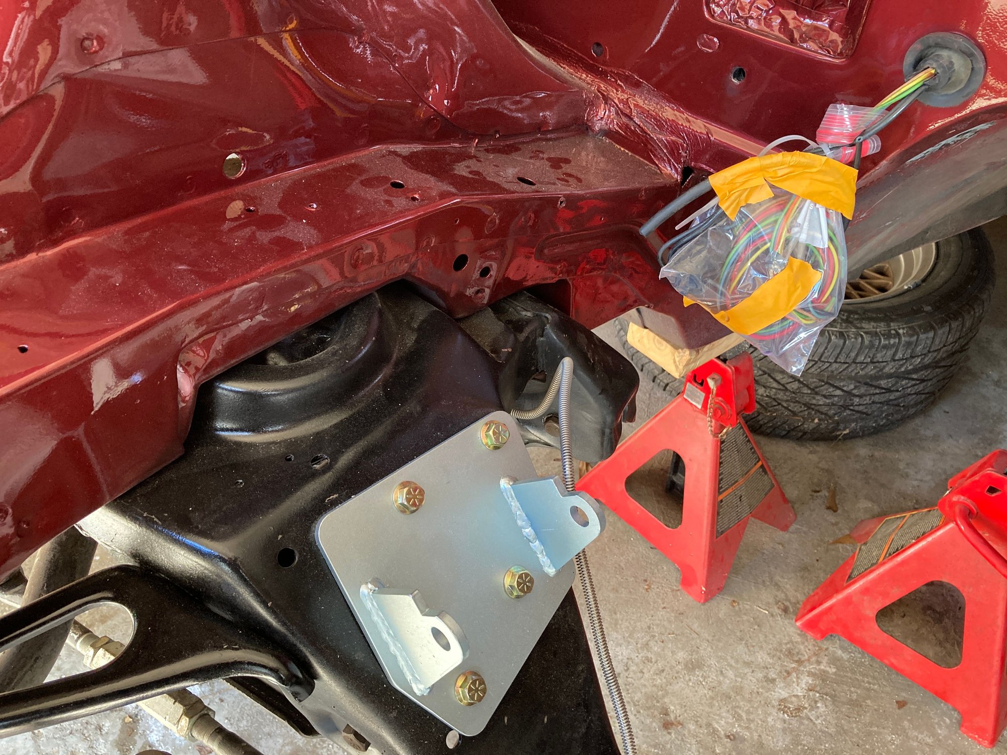

I got my new stainless brake lines installed over the weekend. They don't hug the frame as tightly as I'd like (yet). I pulled out the new Hooker 1 7/8 headers and placed them in the empty bay and it seems like they'll be really close to where the brake lines travel. I'll add some pictures of the current state of mine (didn't get a good shot of the passenger side).
Question for the forum - if you're running headers with your LS, particularly the Hookers, did you do anything special for the brake lines for the front? Re-route? Make sure they're tucked up tight? Pics?

Drivers Side

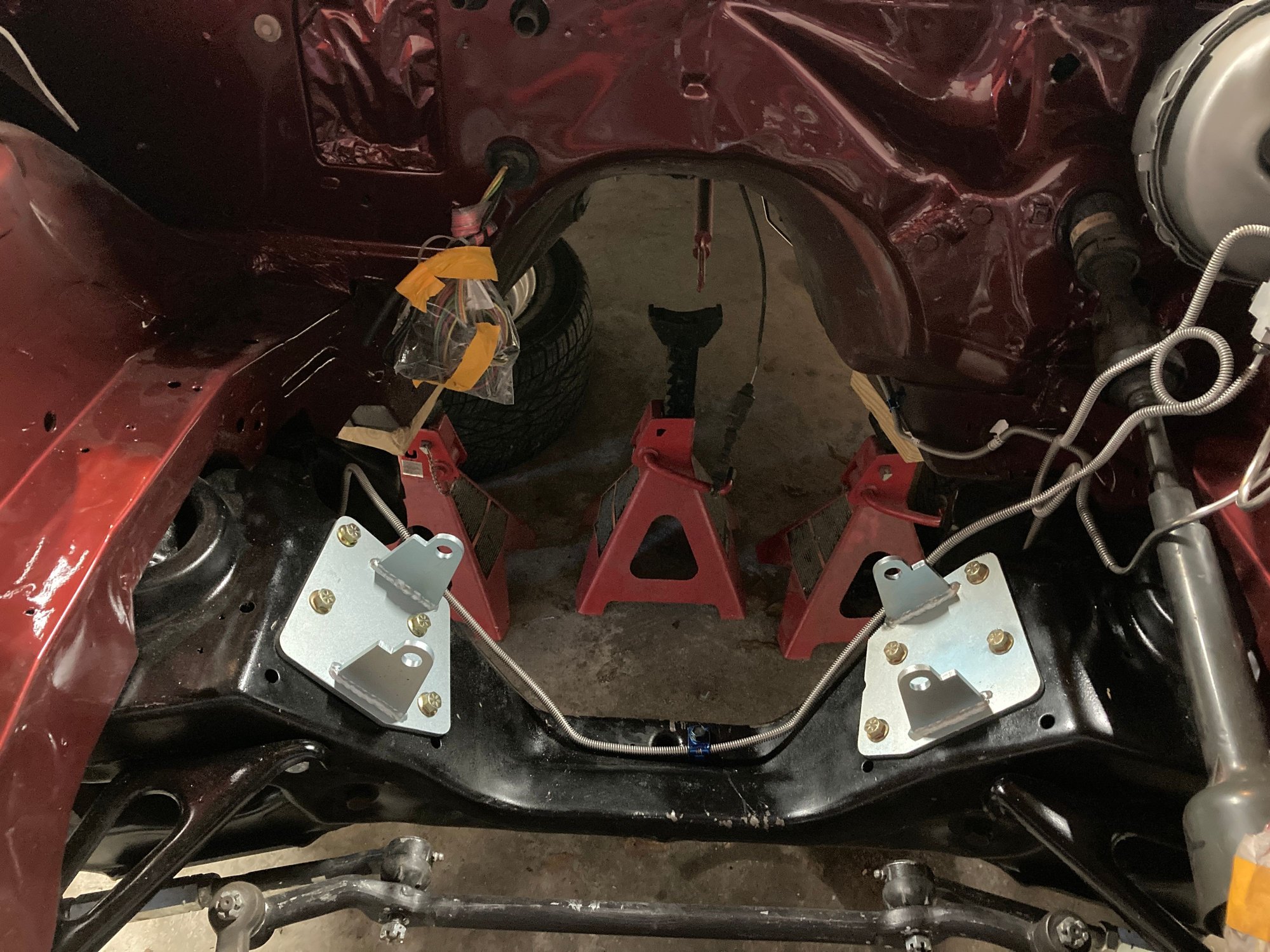

Here is mine with hooker headers and mounts. I don’t remember having to move them around to much but I did already have them moved some from the old sbc with headers. Just take your time should fit great.

Here you go. Lots of room once they are in place but it is a tight fit getting it pushed up in place past the firewall.

Thanks. That gives me some hope. Here's a shot of the rest of my lines. Not much is tight to the body and will need further bending I believe. Somewhat disappointing for prebent lines, but it's probably par for the course. My main concern area is there on the passenger side where the brake line goes down between two parts of the K-member, right where the header travels. Wasn't sure how close the header got there.

Did some tweaking this evening to the lines, and drilled some holes to add clips. I think I got it pretty tight against the K-member, sufficient that I'm willing to move forward. I'll be running the Holley 302-2 pan, so I should have plenty of clearance on the back side of the K-member. Those with F-body pans couldn't run it this way.
It's hard to tell in the pictures, but it's even with the top of the K-member along the length and doesn't come out at all on the passenger side like before.
Front of K-member
Back of K-member
