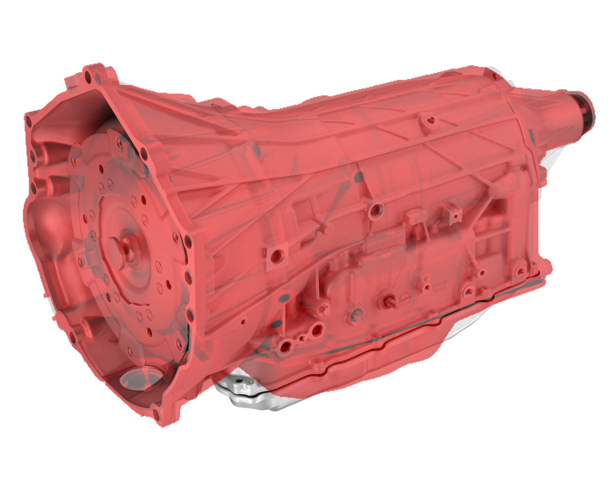

Since I already made one, here is a 10L80, 6L80 comparison. Use at your own risk any future readers. I made both of these in minutes playing fast and loose. Just a scale lock and dragging it as close as I could align it.
Red 6L80 superimposed on Grey 10L80

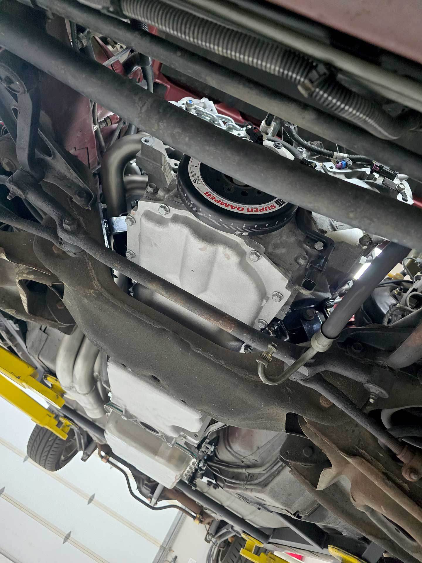

Old Jan 21, 2024 | 09:13 AM
TJQIROC's Avatar
Joined: Aug 2003
Posts: 333
Likes: 20
From: South Jersey
Car: '16 Camaro SS, '88 IROC
Engine: 6.2 Gen V
Transmission: 6 spd TR6060
Re: Gen5 LTx swap looking for mount options
Any updates on this? I put a 2017 LT1 with TR6060 six speed in my 88 camaro. Lots of crap I had to do but it works and works well. I can provide any advice that may help.
Old Jan 22, 2024 | 09:25 AM
NicD's Avatar
Joined: Jul 2023
Posts: 47
Likes: 38
From: Phx, AZ
I need to stop spending money on other stuff. LOL My problem is that I have too many other cars that I'm doing stuff to and just when I think I'm done with it something pops up. I did have to replace the fuel pump this past week in the IROC because the original fuel sock on the pickup just disintegrated and it made it's way into the pump and smoked it. Also ended up replacing the shocks and sway bar bushings and end links because they were original and crusty but it's up and running again.
I did call Hawks and get information on their LTx swap parts and it sounds like it may be the way to go. They said you have to modify the box on the back side of the compartment otherwise the covers, etc hit it but it doesn't sound bad. My game plan is to actually order the parts here in the next couple of weeks to just start collecting things for whenever I can get around to this project.
What did you end up doing with your swap? What mounts, etc did you end up using and what accessory drive did you use?

I know what you mean about being busy doing other things. I did a lot of work on my camaro but ran into vibration issues with the drive train. I had modified the transmission with a previous generation of rear case but that caused vibration. That ended up stopping any work for a few years. I finally started to work on the car again to get it running again. Putting the original rear case back on and modifying the rear case to fit the shifter and motor mount solved the vibration issues.
I used Dirty Dingo Adjustable mounts https://www.dirtydingo.com/shop/index.php?cPath=392_402
I used this crossmember since it has the torque arm attachment: https://www.holley.com/products/engi...ts/71222005HKR
I used this accessory drive: https://www.holley.com/products/engi...s/parts/20-170

Here's the post I did when I was really into working on the car:
https://www.thirdgen.org/forums/ltx-...1-install.html

Well would you look at that, the 10L80 transmission fits! I didn't have to even pound anything to make room, it's a bit tight up top but clears with an inch or two to spare. The trans pan is the lowest point right now but it's not bad, about as low as the torque arm mount that goes to the subframes. Actually, I'm going to start a new thread with a lot more pictures and details here in the next day or two but just wanted to update this one.
You’re a hero NicD! Very nice pictures and insight confirming that it can be done.
Exciting stuff and good work!
