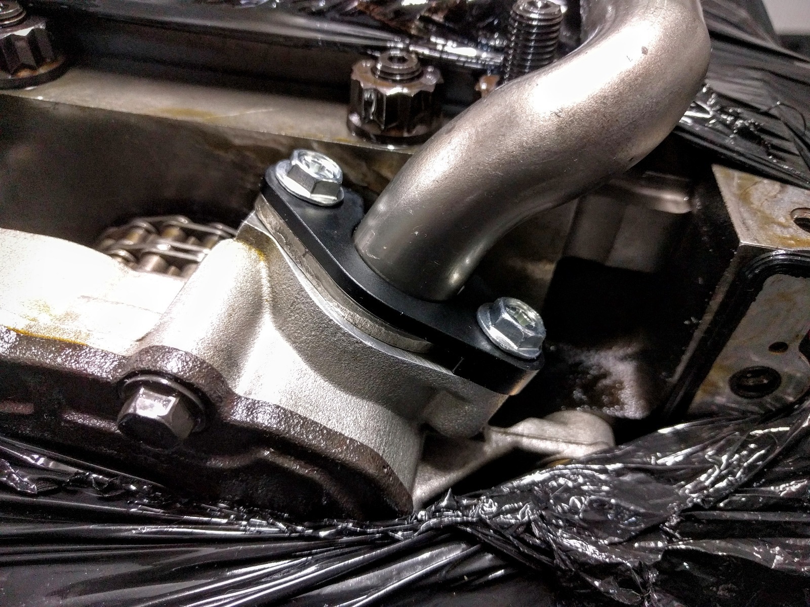

Re: Project Procrastination '91Z LS1/T56/currie 9" w/PICS
Then I ball honed the cylinders:
Measuring EVERYTHING took quite a bit of time
I measured the bores before and after honing, main and rod bearing clearances, ring gaps, thrust, and cam bearing clearances. Everything measured within spec with the exception of the ring gaps.
The top gap service limit is .015" but the ring manufactures all recommend .015" minimum. My stock rings top gap was .013" and the Sealed Power rings I bought measured .022"-.025"
I'm sure those rings would have worked but I sent them back and bought a file fit set from Mahle. I filed the top gap to .016" and the second ring to .023"-.025"

Got the oil pickup girdle installed:
And installed the front and rear covers along with the oil pan.
I aligned the covers by bolting on the oil pan minus its gasket, and aligned the oil pan by bolting on the bellhousing.
