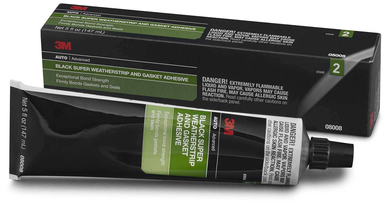

Just ordered The weatherstripping kit from 1A Auto:
https://www.1aauto.com/1982-92-chevy...=255902&y=1992
Also ordered 2 tubes of 3M 8008 weatherstrip adhesive:

Do you think the weatherstripping adhesive is worth it for our cars? We won't be driving them in the rain I presume. I have a tube but go back on fourth on should I shouldn't I?

I plan on driving this car in ALL weather conditions. I built it to not be scared of driving in poor conditions.
Even if it never sees rain the weatherstrip rails that mount to the top of the window channel need a sealant behind them. That's where I plan to use the 3M stuff.
