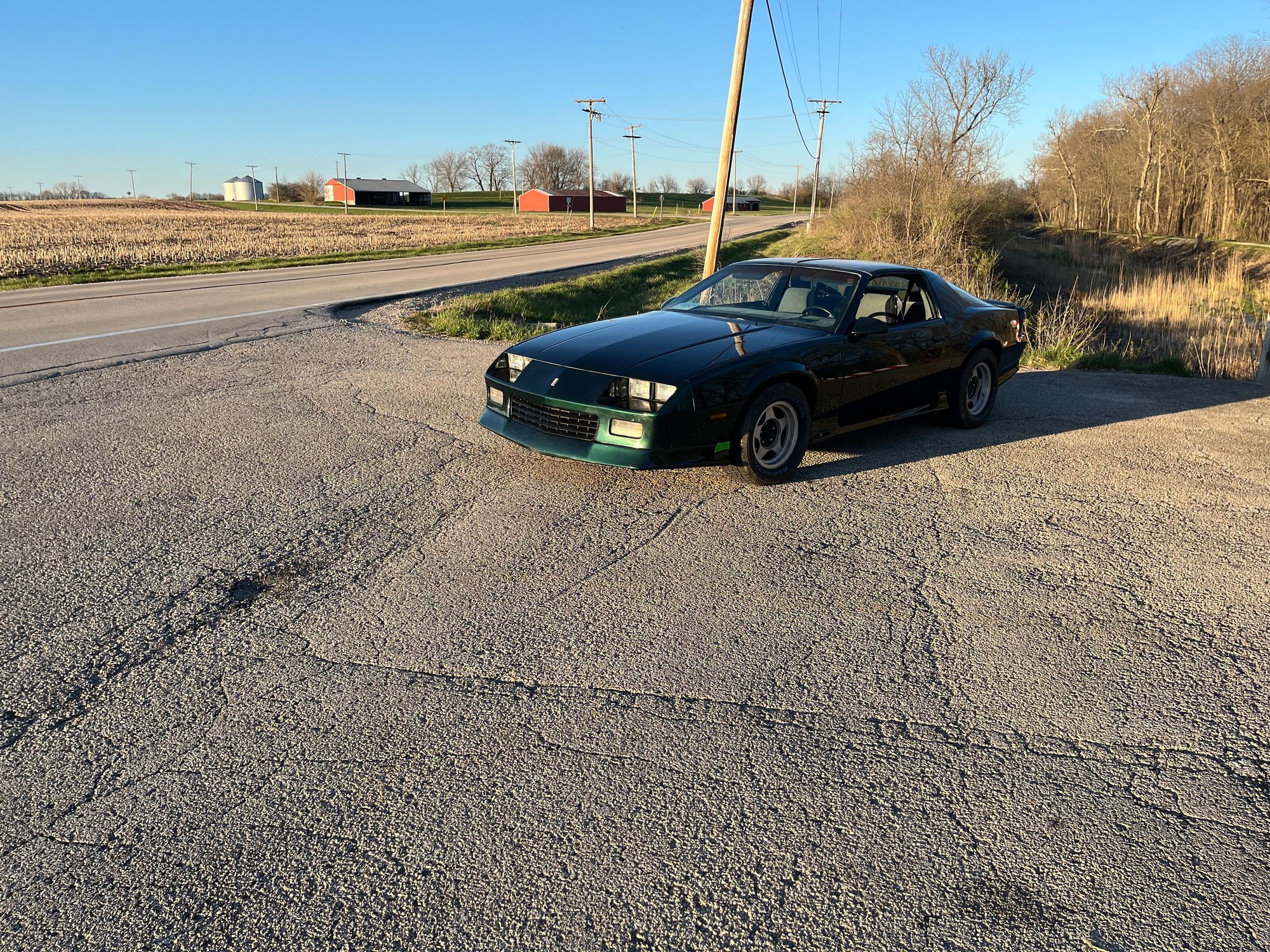

We just recently picked up a 92 RS with a 3.1 in it, this will be my son's first car. He turns 16 in May, so there is time to do some things to it. There are some dents and panels that need to be replaced, it will need a paint job, and some other minor things. The car is pretty solid, not any of the rust issues it could have.
I found a 91 Z28 that has a 305 in it, and it will get the spoiler my son wants, along with a straight door and some other pieces I found broken as we were changing the fender.
From looking on the forums, it seems like the engines could be dropped out the bottom and rolled right across to install on the opposite car. The harness stays, brackets, intake, etc. Will this work between the cars, totally just a bolt in deal?
I understand that the wiring harness and computer needs to transfer, assuming the driveshaft as well. I'm also going to swap the fuel tanks because I think the one in the V6 car has rust in it. I have read the V6 rear end has a more desirable gear ratio.
This seems fairly straightforward. Is there anything to watch for?

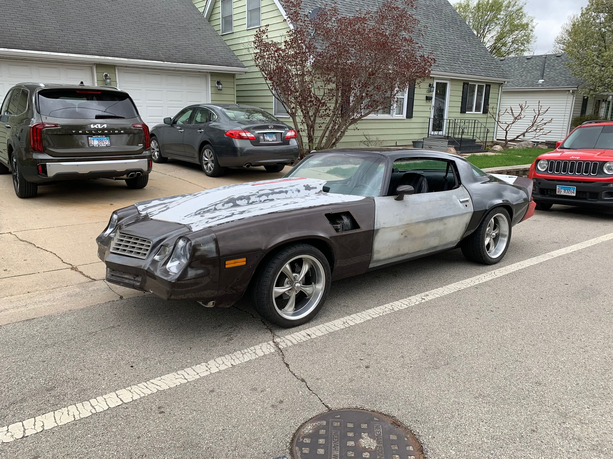

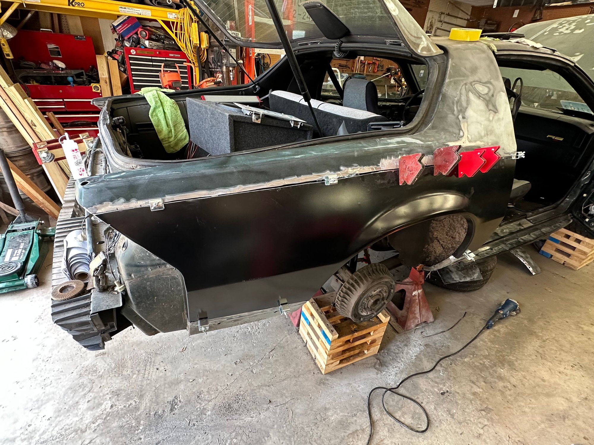

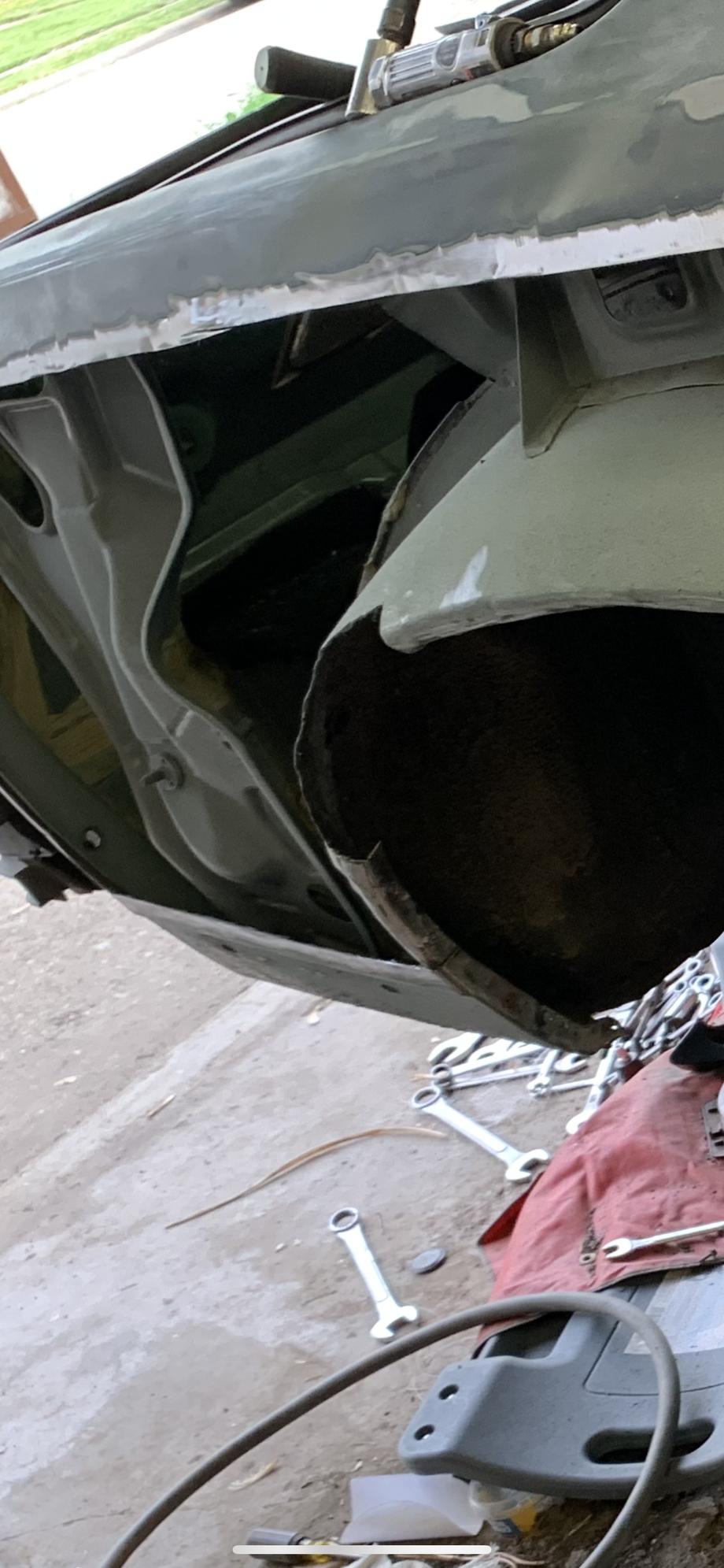

I have a new quarter panel. It doesn’t really wrap around like I would have liked, so it could be spot welded in hidden areas. No matter what it’s going to be a long weld. I’m hoping to have the panel mocked up and at least started to weld in this weekend.
I also have my 79 Camaro I need to look at, it seems to have a degrading U-Joint and has developed a drip in the manual transmission.

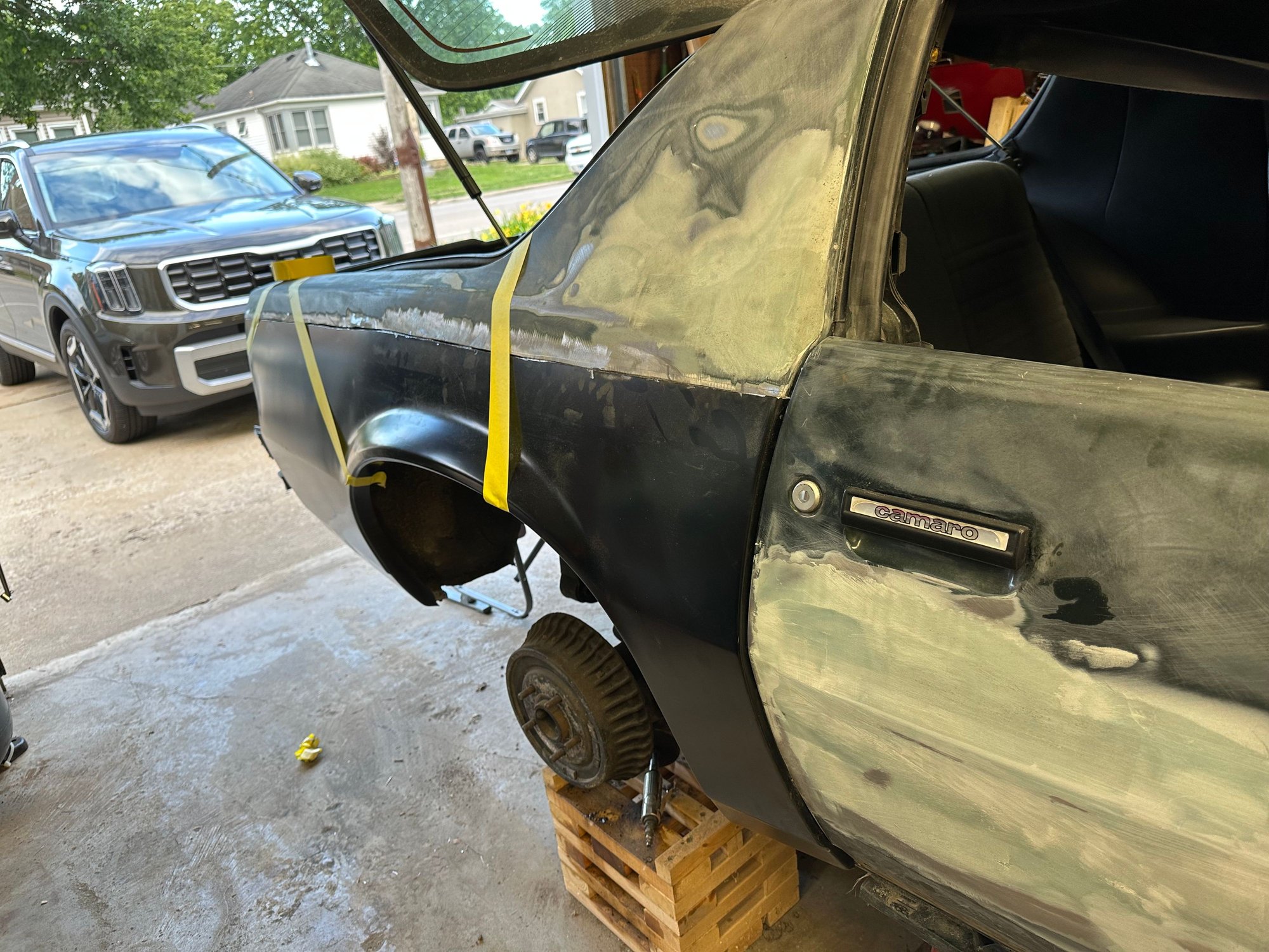

Got the panel cut and fitted, this is moving slower than I hoped. Need to repair the inner part before installing the fender permanently. Going to drill for spot welds along the back and inside of the wheel well.

cutting this and getting everything to be aligned was a lot harder than I thought it would be. I had hoped that the replacement fender would be “complete”, able to wrap around the top into the hatch area and down to the pinch weld. This would have made it easier because they would mostly be spot welds.

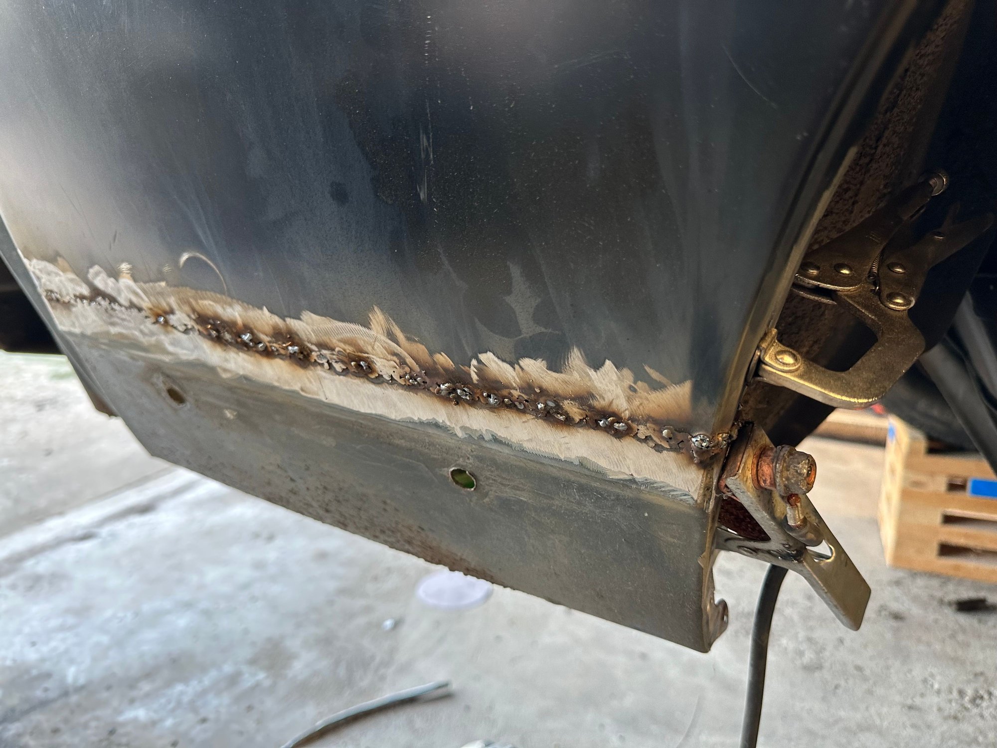

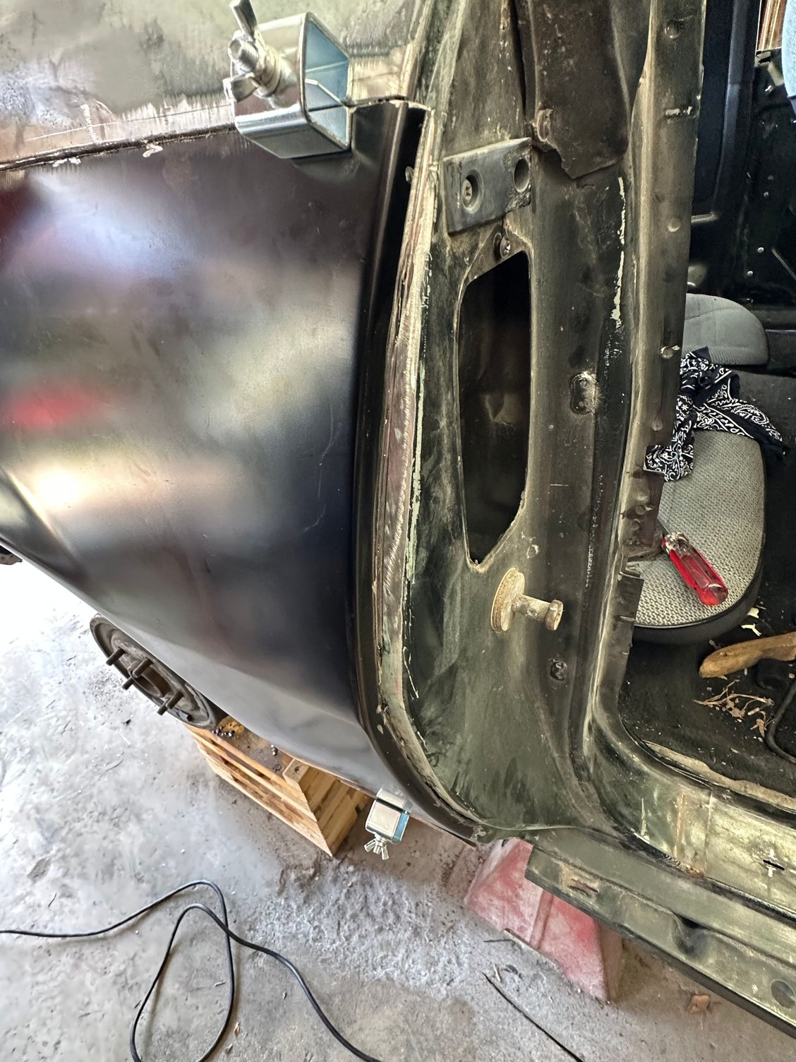

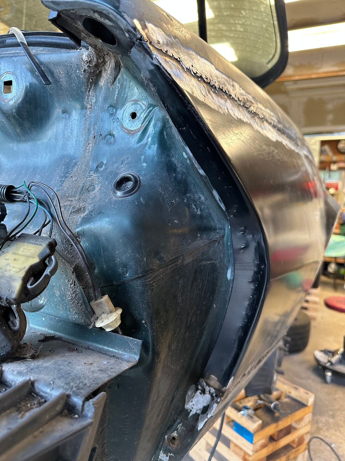

We have made some progress, it’s definitely slow going overall, with little spurts of good production. Even being careful to jump around, we still have some warpage, I don’t know that I will ever go about this with long weld seam’s again. I’d have like a panel that wrapped around so all that was needed was primarily spot welds.

Grinding those welds is going to be a chore for sure. Still so much opportunity to add heat and warp the panels! Hopefully some glazing putty and some large sanding blocks can help mitigate any warpage. Keep us updated!

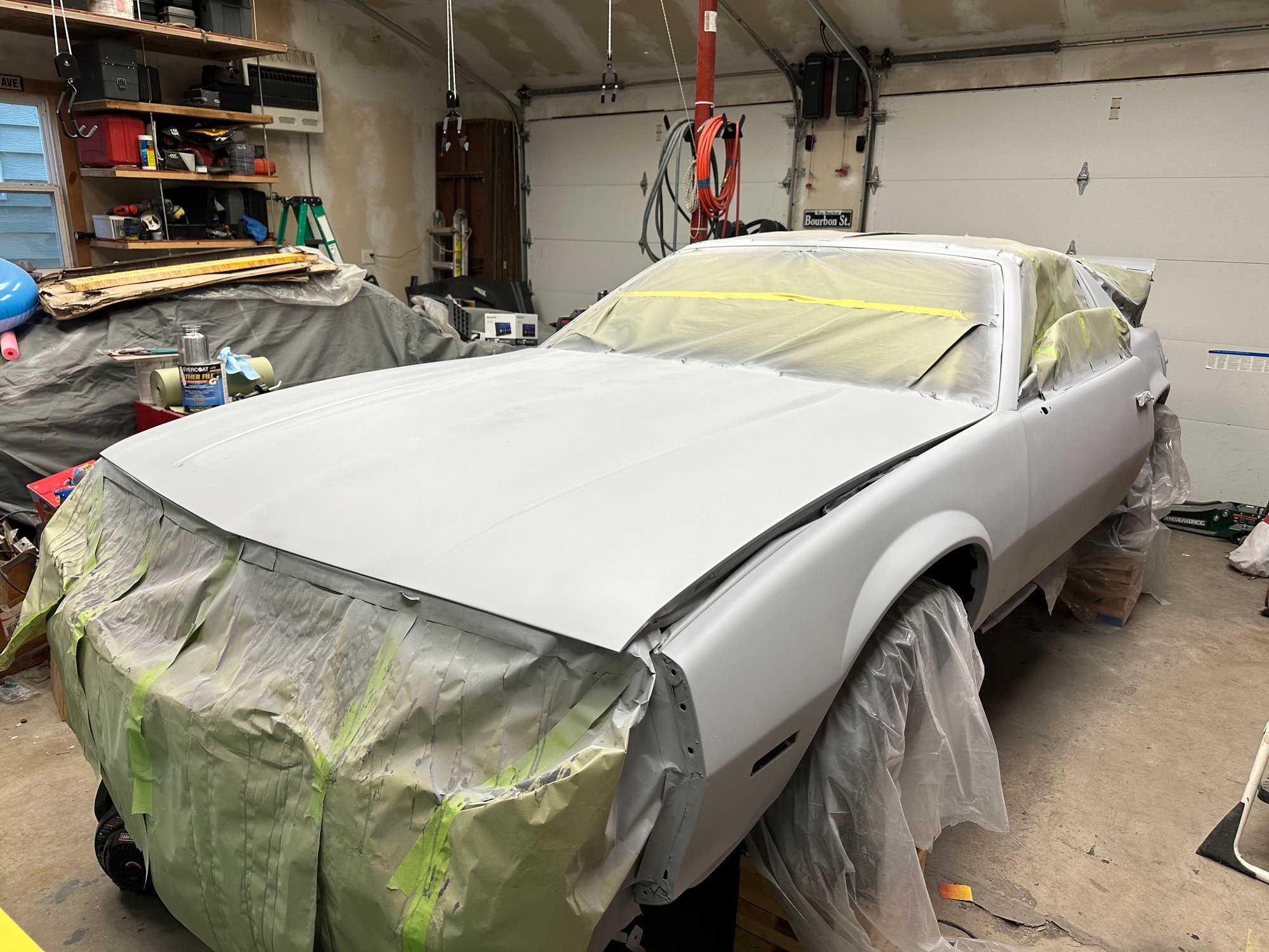

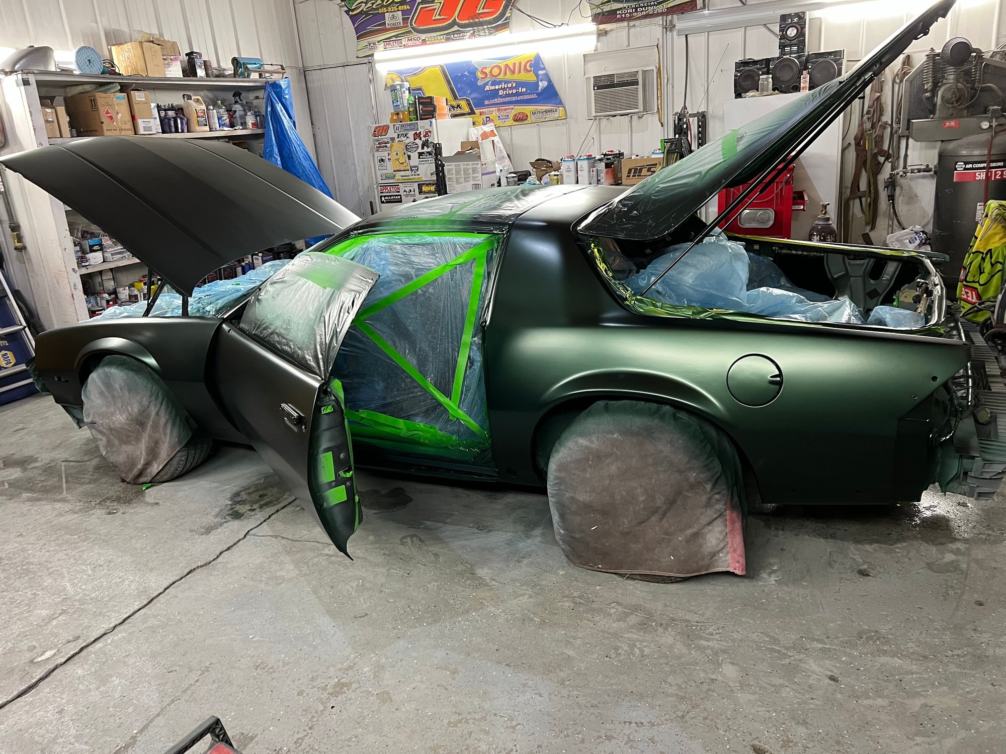

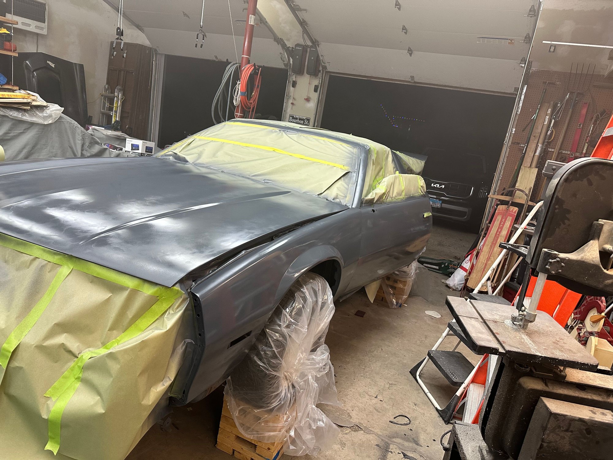

Some progress, we got some primer on tonight. I need to get another quart and hit it again.

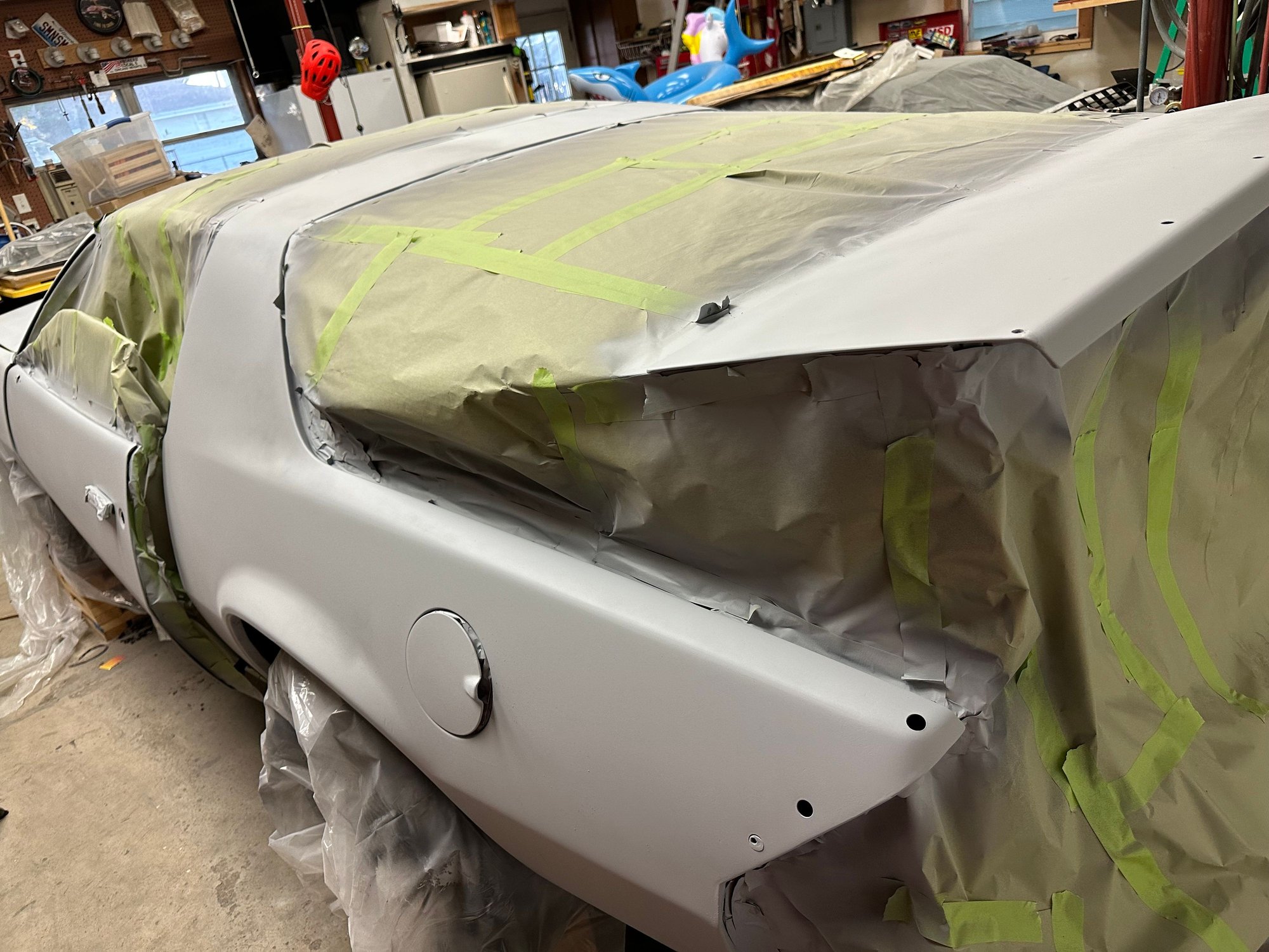

Feather-Fill today.

Impressive work getting that rear corner blended in! I don’t know if it is more noticeable from other angles, but I can’t see the weld line at all!
what did you use to bring it back into flat?
Old Nov 9, 2023 | 05:57 PM
ATM's Avatar
ATM
Joined: Aug 2022
Posts: 0
Likes: 31
Re: Father and Son - First Car
I just pulled it a bit, ground out the weld and skimmed some bondo along it.

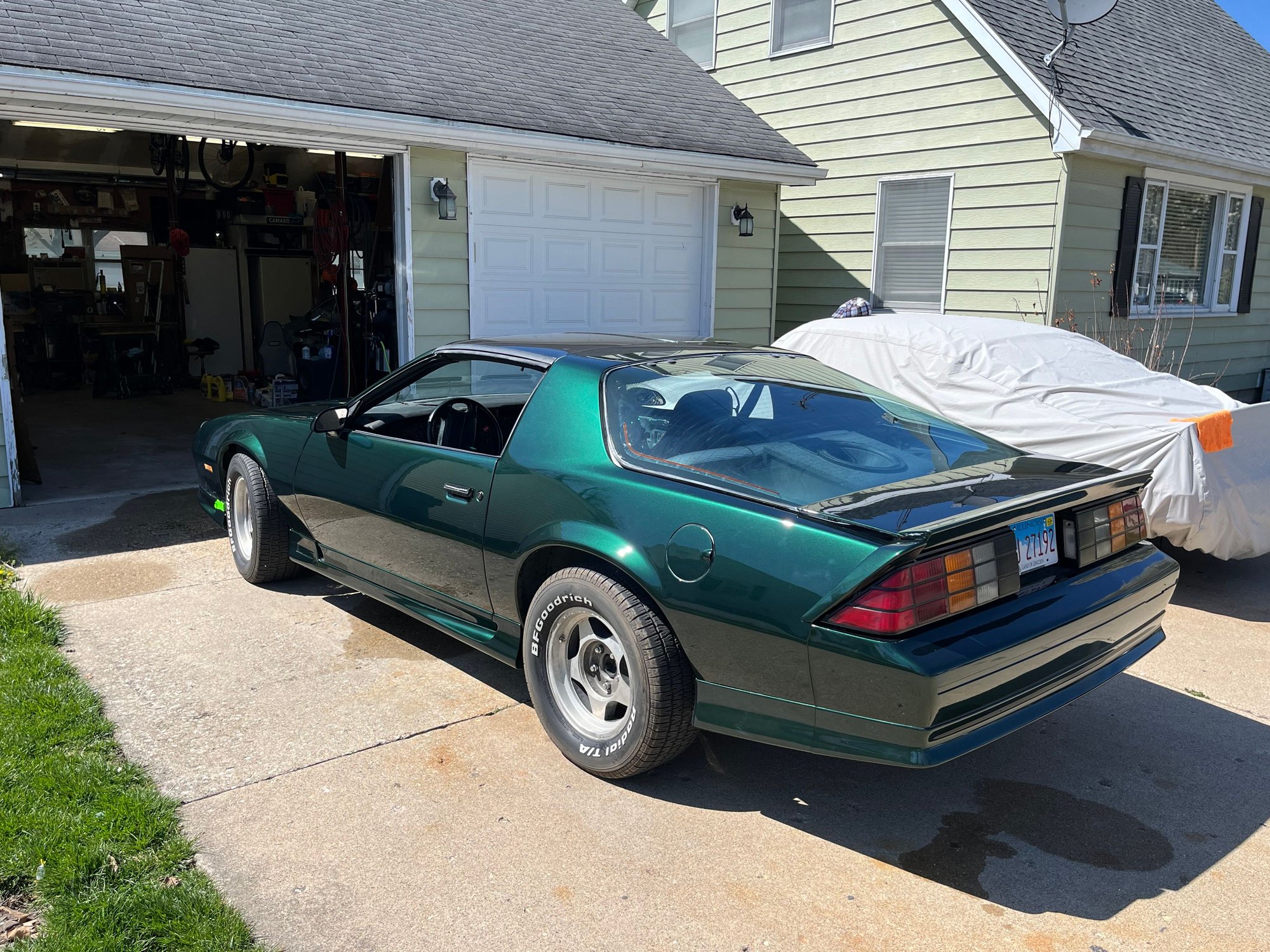

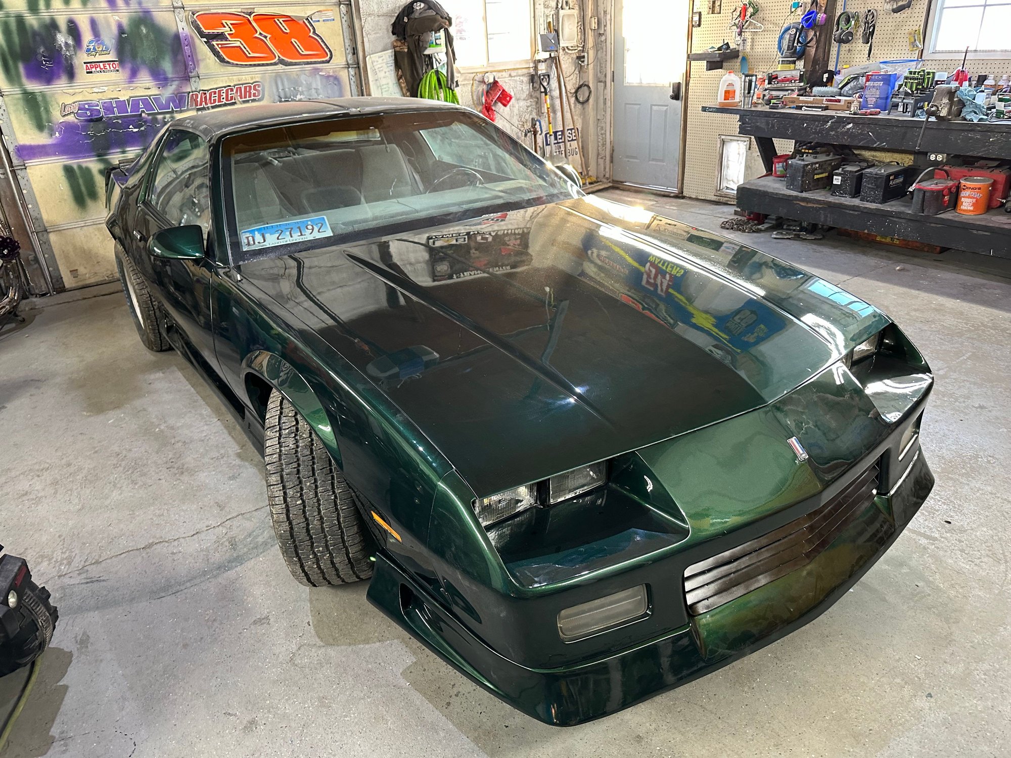

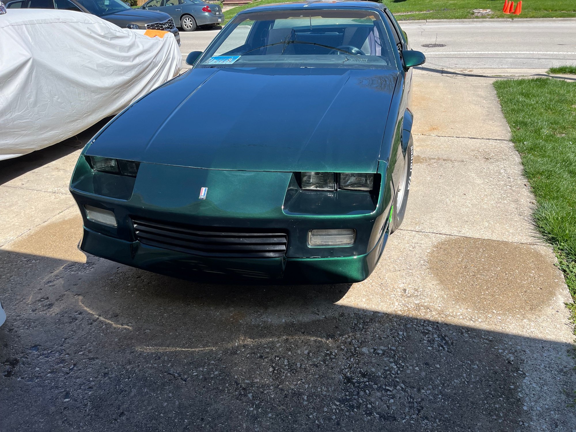

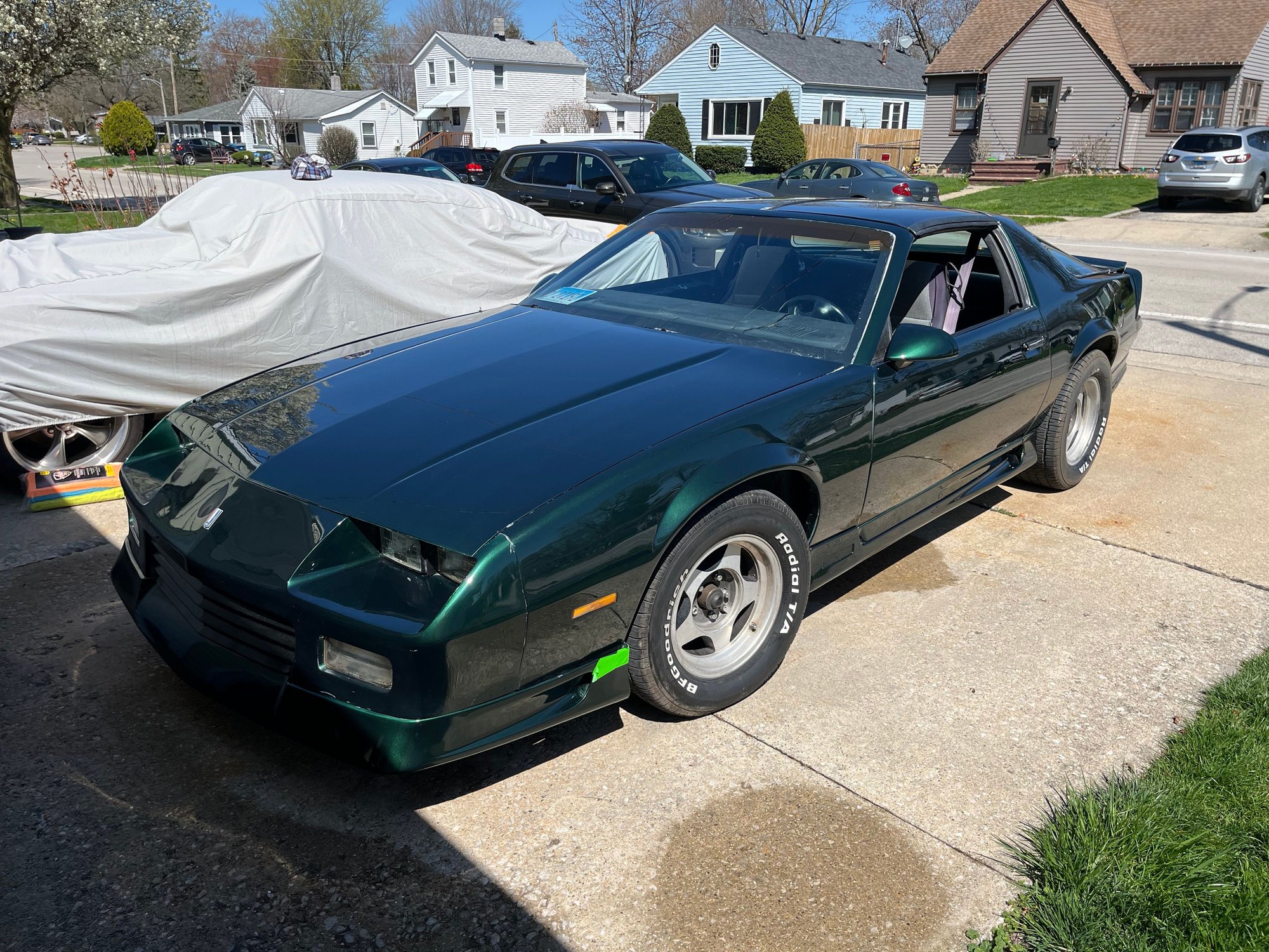

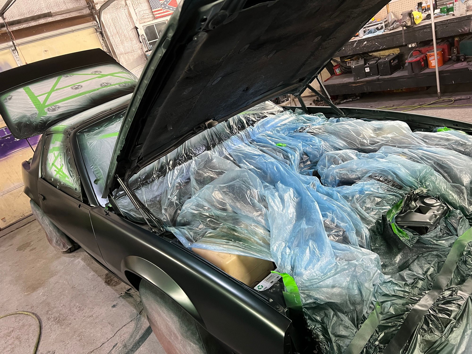

We found a great guy to paint the car! Picked it up on Thursday and this is where it’s at!

I love the color!...

I agree, it is the factory color it came with, Polo Green. It looks really nice when it is shiny, we got it pretty dingy looking.

Nice work. I like the color too. Pretty cool that was original as well.

You made very quick progress on that body and paint work, nice job!! I am not even close to done with my LS swap yet, but already dreading finding the right person/shop to paint it right.

I got most of the bodywork done last fall, getting primer done right as it was getting cold. I heated my garage for most of the winter so I could fine tune some things and hoped to try painting it. My brother in law told me about his friend that paints on the side, thankfully he was willing to help with it.

Old Apr 6, 2024 | 03:38 PM
ATM's Avatar
ATM
Joined: Aug 2022
Posts: 0
Likes: 31
We got it back home, still needs to be cut and buffed, still not completely assembled.

Thanks, I really like this green. He’s very happy.
I had to weld longer bolts on the lower door ground effects, still need to put those on, he took off driving around after before I could get them put on. Also still have to finish the front ground effect at the wheel wells, it’s a new piece, and being very difficult to go in completely.

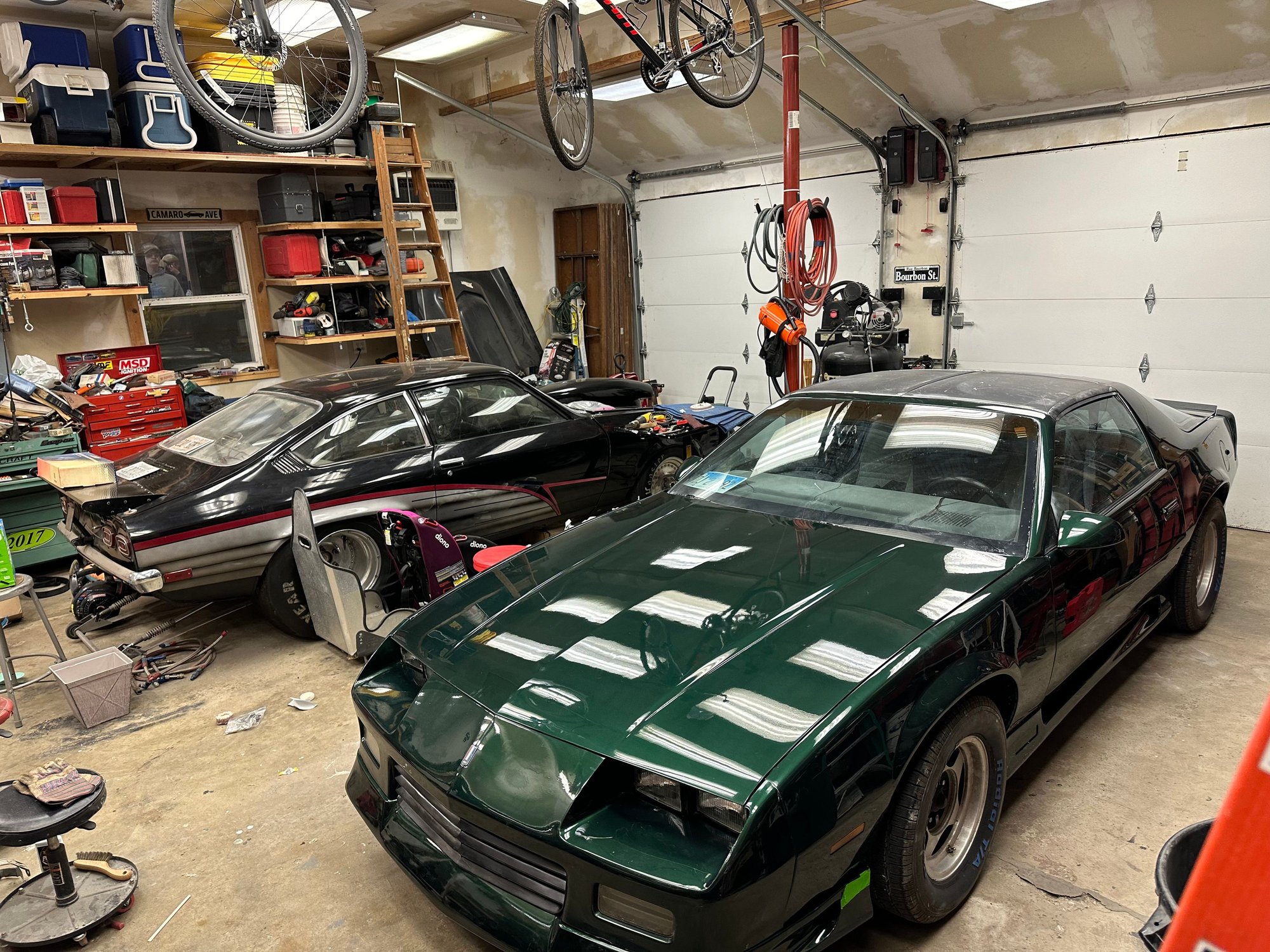

Here’s some of the photos. Been a while, I removed smog system in addition to adding a larger diameter exhaust with a flow master 40 series we pulled off my uncles 3rd gen.
