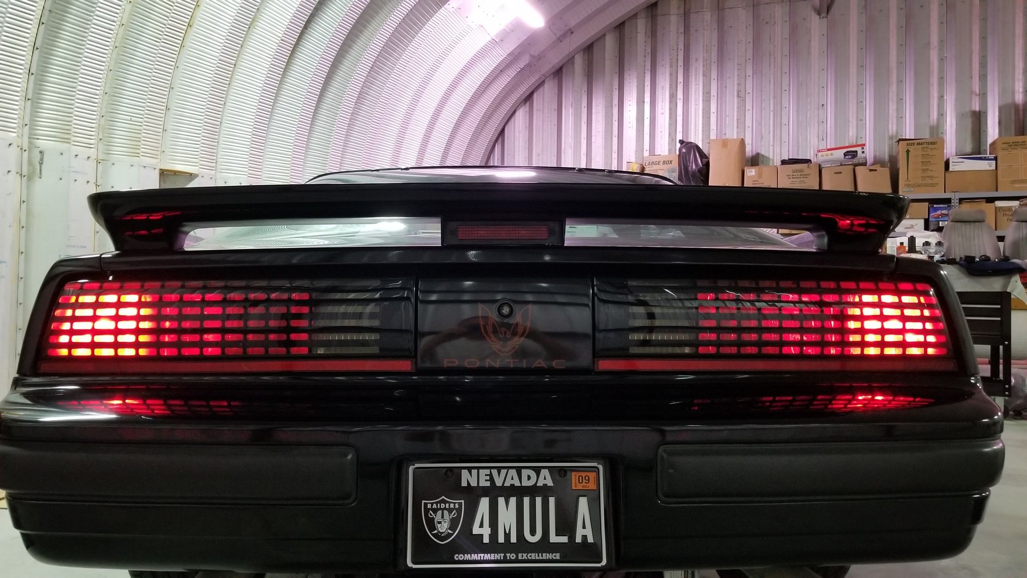

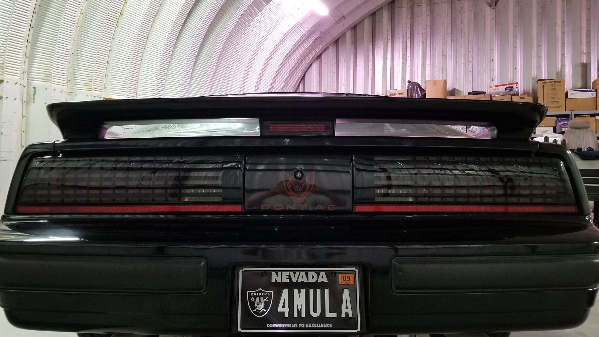

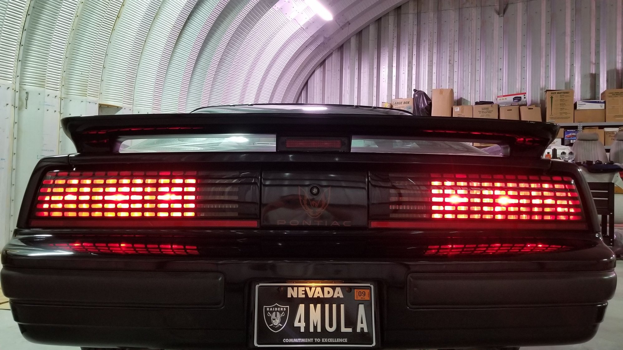

Let there be lights! I modified a base Firebird harness, so functionality isn't exactly like factory-proper TA lights, but it's similar, and there's a flexibility with a base harness that you won't have with a proper TA harness. All three lights function as tails: the outermost is turn/tail, and the two inners are brake/tail. Red 1157 LEDs, white 1156 LEDs for reverse. Modification of the harness is described further down, because it was originally done for a different project, and then was further modified for this project.
Turn/tail, above(lights not on, hazards flashing).
Brake/tails, above(tails on, brakes not applied, but brakes are the two inner lights on each side). The incandescent 194 license plate bulb has since been replaced with a cool white 194 LED, so the plate glows more nicely now than in this pic.

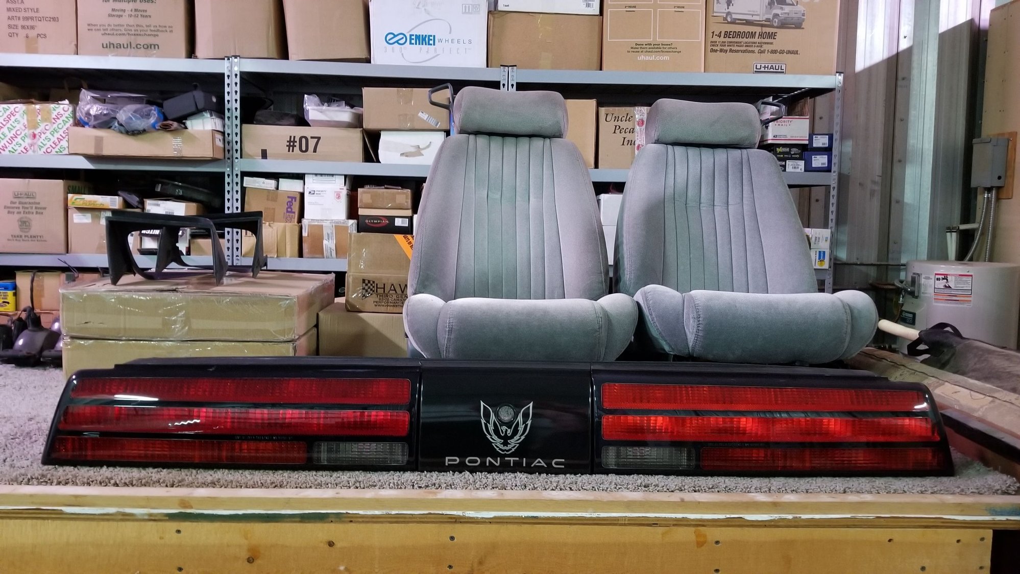

Below are the base lights after removing them and installing the TA lights, with my car's original silver bird center section, which I love, but felt it was too dominant to use with the dark TA lights, so I went with the salvaged red bird center section, which I think is a more appropriate fit with the TA lights. I wasn't going to replace these, but the TA lights turned out so nicely, that I couldn't resist. How could I now?
These were A LOT of work, all by hand, and they turned out beautifully, super smooth and glossy, so it was worth it. But once was enough, so I used a buffer on the TA lights. BTW, your eyes aren't deceiving you on the base taillights above. The amber lenses have been converted to red. Then the housings were polished out to look new and natural, very successfully, I might add, as they're really beautiful. But as I said, it was A LOT of work, all by hand! Never doing that again lol.
The silver bird has a better finish than the red, because as my own for its entire life, the silver bird has always been in beautiful condition, whereas the red bird was salvaged and had to be brought back to life.
As for not having the TA center section with its continuous reflector, I like how the red PONTIAC plays between the red reflectors on the TA lights. Besides, a TTA center section says TURBO, so why not PONTIAC? Below is a pic with the side door of the hangar open and daylight shining in. The red bird and script pops.
Now for the black wax gimmick, it really does add a (barely) noticeable touch of tint, which made the TA lights and red bird section look even nicer. I had no idea what might happen, but I went for it anyway, and I was pleasantly surprised. If you use a cleaning product on them, the result will be a black rag. So if people want to "tint" their lenses, but don't want to have them sprayed, or risk any legal issues, then get some black polish and black wax. It won't be much, barely noticeable, if at all, maybe, but it will add a "something" to the finish, leaving someone to wonder if they might be slightly tinted.

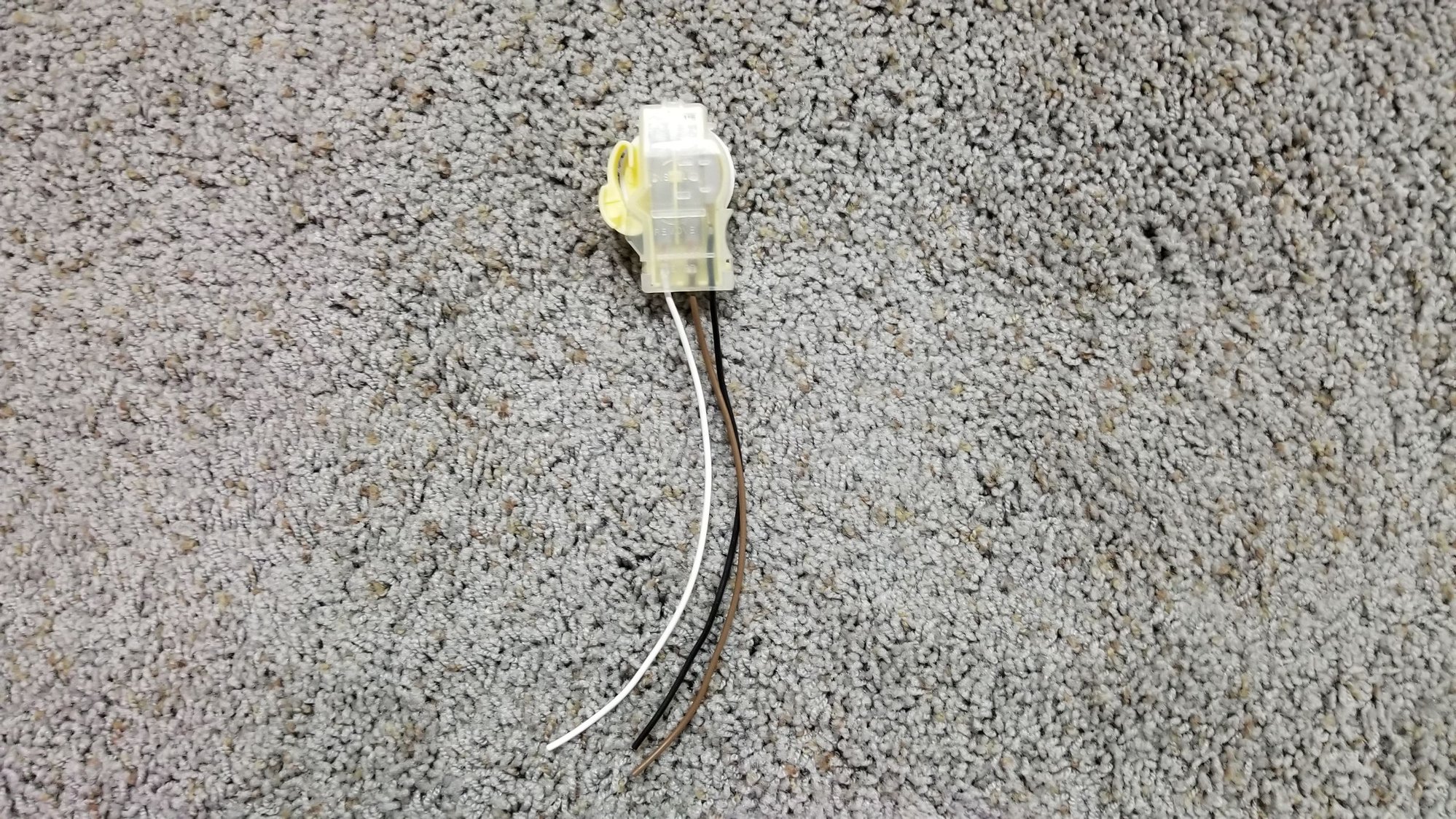

Brown = parking/side marker/tail, Black = ground, Blue = brake, Yellow and Green = turns (colors are side-specific).
IIRC, the brown and black wires for the four 194 taillight sockets are Teed into the main brown and black wires, so those sockets can simply be cut off at the main brown and black wires, making sure to keep those main brown and black wires intact so they can continue across the back of the car.
The thing about making cuts is, whatever you cut, you have to make sure the wires can keep carrying current to their next stop, so-to-speak. So some splicing might be necessary to keep some wires moving on.
Here is a 3-wire pigtail. Use one for each turn signal. Cut-off the existing 2-wire turn signal sockets, keeping as much wire length as you can, then connect the white wire to the hot wire (yellow or green), the black wire to the black wire, and tap the brown wire into the harness' brown wire that runs across to the other sockets. You want to keep as much length of each color wire as you can, so the wires are long enough to locate the new 3-wire sockets into the positions of your choice in the new housings. Tapping into that brown wire is what converts your turn signals into turn/tail lights, and now they'll light-up with the brake/tail lights, and all six reds will be illuminated across the back when activated.
Your two existing 3-wire brake/tail sockets on each side can be moved into locations in the new housings that their existing wires will reach. And reverse is reverse, obviously.
Again, just remember that whatever cuts you make in the harness, you have to make sure that wire is still able to continue carrying current onward. So if you finish, and the tails on the right side aren't working, then you've cut the brown wire somewhere in such a way that's preventing it from carrying current to the right side.
From left end to right end, mine are turn/tail, brake/tail, brake/tail; brake/tail, brake/tail, turn/tail. But if wire lengths permit, you can arrange the six reds in any sequence you want, such as brake/tail, turn/tail, brake/tail on each side.
Not much else to it. In a nutshell, all you'll have done is cut-out the four 194 tail sockets, and converted your 2-wire turn sockets into 3-wire turn/tail sockets. While that's not exactly the way Trans Am's lights function, it works, looks good, and it's close enough, so most people aren't likely to notice a difference. No reason for anyone to try to make it more complicated.
Edit: One other thing, if the 2-wire turn signal sockets that you removed used 1156 bulbs (single terminal on the bottom of the bulb), then you'll need to change to their dual-filament counterparts, 1157/2057 bulbs, for the new 3-wire sockets.
