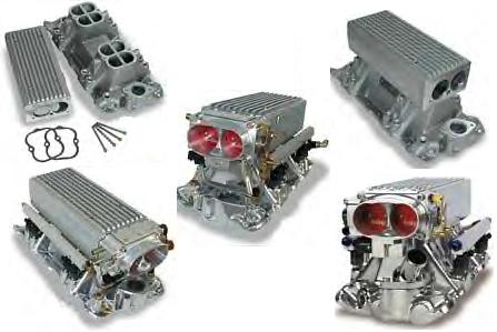

I bought a super ram upper and an edelbrock lower, but I have two cars I am putting that on one and for the blower car I am getting the new stealth ram intake. it is cheaper, pretty nice, and has NO emmision provision though. see here more info https://www.thirdgen.org/techbb2/sho...hreadid=114308

omg guess what? now i'm going to HAVE to buy one =D
my tires (what's left of them) and i can definitely handle my car losing some low-end power and gaing lots of horsies up high.
i'm left wondering though - the stealthram likes cams with LOTS of lift, and right now i have crane 1.6 rollers in there. and i love them. but wouldn't a supercharger like a cam with more moderate lift and would this aggravate the stealthram ? i'll def be putting on at least a 58mm TB.

i personally see no need to upgrade the intake if your going to run a supercharger,if you are on a tight buget.obviously it cant hurt but your money is better spent on good heads and free flowing exaust.and before you flame me with the fact that i'v ipgraded my intake the intake mods were before the sc and i'd bet that with the sc they wouldent be cost effictive.
