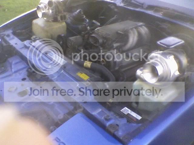

That was such a nice '92 Firebird too, the township was complaining about the cars though, so I had to let it go. I really wish the '91 Formula would have worked out to tell you the truth....;

Originally Posted by project89
lol i might have to change his wastegate spring to a 3 psi spring....
Dave, you wanna take a ride to the shop tomorrow? I want to modify the fuel rail a little, as I'm planning to plumb it on the opposite side. I'm going to use the cold start injector area as the supply line, and cut the return right by the regulator and re-route to follow along side of it. You'll just have to weld the front of the passenger side fuel rail shut. Here's the concept....;
....might be better off waiting till its on the car to do it
.... too late lol, I went at it with a hacksaw. Was going to simply turn the regulator housing around, but it won't seat right, so I'm going to do it the same exact way in the pics. Going to run braided line all the way back to the sending unit in the tank and tuck them completely away from the exhaust, by the way, do you have a flare gun? I misplaced mine lol.

The fuel rail is almost done. In the first picture, you can see where Dave welded the fuel inlet in the front of the rail completely shut. The new location will be on the back where the cold start injector line was plumbed. Also, I didn't trust the return line coming from the regulator, a little too loose for my taste. Tomorrow I'm going to tap the hole and put in the proper fitting. Don't mind the pics, the weld will be smoothed, and the rail will be polished...;
Originally Posted by TPl383
Thanks Chris, that's exactly what I'm looking to do. How is that regulator w/boost....?
