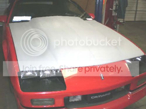

Consider what I told you in the other thread Dave. If you make 45-degree flange adapters to sandwich between the turbo flange and header flange, to clock the turbo's more towards the center, just a little bit, not directly over the carb, then you can drop the crossmember down a 1/4 of an inch, then go with a Sunoco/Jongbloed Hood. You should be good to go as far as clearance in concerned....
Thats the same hood I thought of when I saw the pic of the red TT firebird.

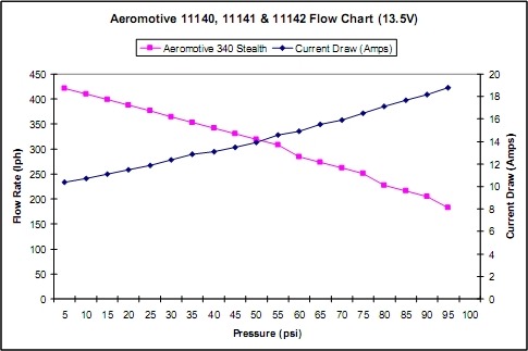

now when they did the carb conversion they left the intank tpi pump and just used an external regulator so what im goin to do is either install dual walboro 255's or a single intank 340lph pump and just upgrade the fpr
there is no such thing as a 340lph pump... 340 is the model number of a 255lph pump
yes there is
169$'s
http://aeromotiveinc.com/products-pa...-center-inlet/

re: 89 Iroc Sbc400 TPI Megasquirt Single GT45 5-600 rwhp build
and at carb presure levels it flows in upwards of 400lph
Attached Thumbnails 89 Iroc Sbc400 TPI Megasquirt Single GT45 5-600 rwhp build-340_flow_chart..jpg
