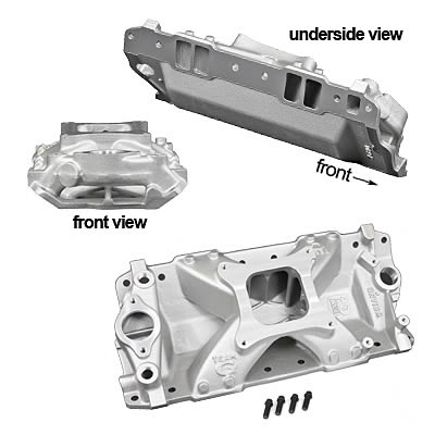

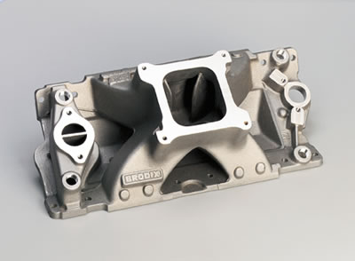

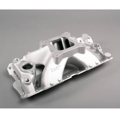

A few others besides the Edelbrock's....;
Weiand Team G
Dart Single Plane
Brodix Single Plane
Holley Strip Dominator

You want the straightest path possible in blow-thru applications, as the less curve area in the runners the better in terms of one area possibly running leaner than another. Dual planes can be made to work, but at high RPM it's literally a house of cards waiting to come down....
