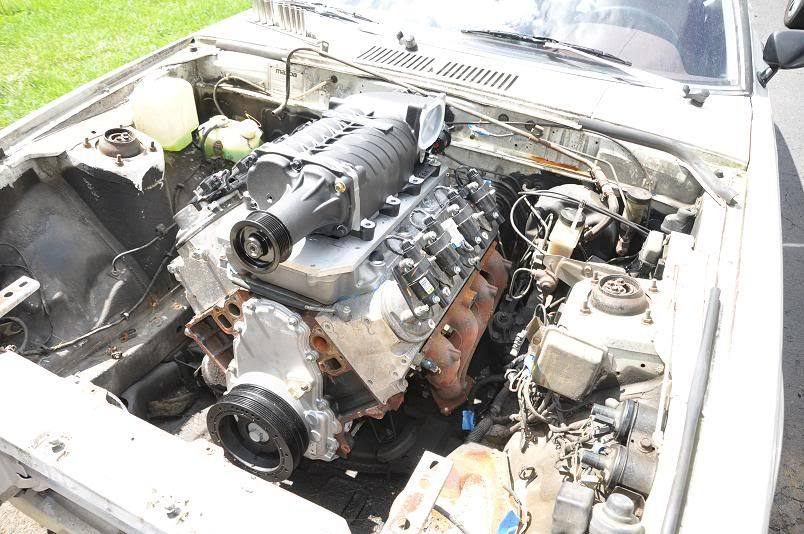

Though, I think in practice making the m90 with an adapter fit under the hood of most vehicles might be quite difficult.
Here is a M122 on an LS with a mock up of what could be an adapter:

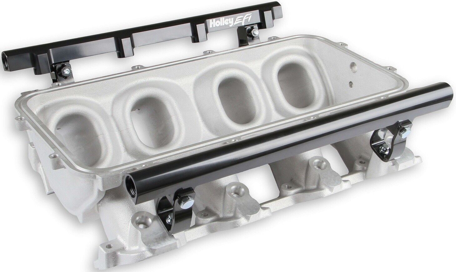

I'd probably use something like this holley base, and make a "lid" tha tbolts to the blower:
But I suspect it would still be absurdly tall.
