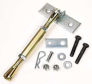

Heres one CE makes for the 79-93 Mustang, i've been thinking of buying one and adapting it... PN 247-4010 from Jegs.
Attached Thumbnails Has anyone ever built or seen an engine brace?-enginelink.jpeg

I've seen people just use a good heavyduty turnbuckle, inexpensive and works well.

I heard that a engine brace such as the one in the pic will cause you ride to be ruffer, and shorten the life of you car??? I might get one but are these tings TRUE / FALSE????

i had one on my RX-7, worked very very well...when you would drop gears you would feel a huge difference instead of the engine turning it would put the power to the ground...its like having a broken trans mount then fixing it...the difference, other then the clunking on the floorpan...

I would only worry about how the frame would fare over time since the motor would now be playing tug of war on the "wanna be" unibody frame rail if you install a turnbuckle attaching the motor to the frame.
If it is engine movement that you want to eliminate then solid or urethane mounts on the motor and trans would be the way to go in my book.
