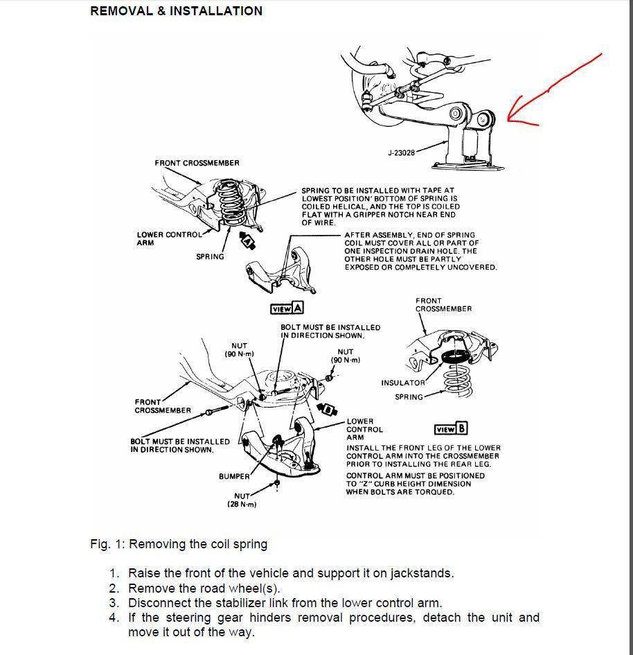

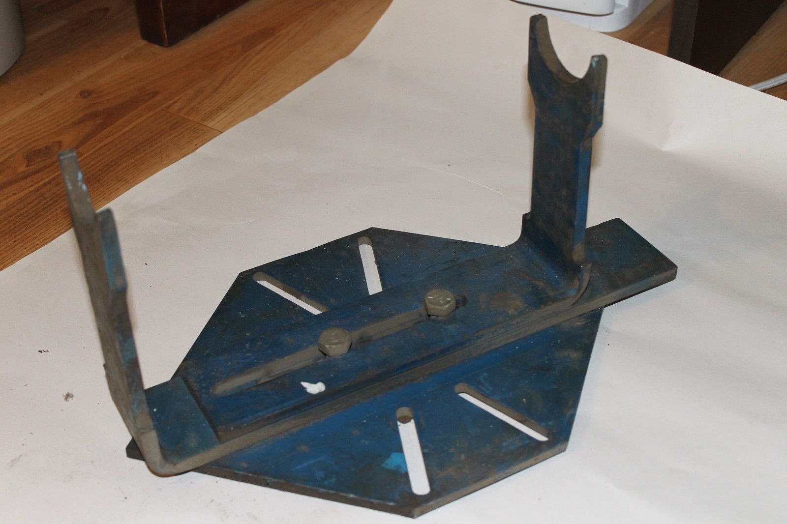

Here is the tool Chilton is calling out. It appears this is set on floor jack, and the upper part rests on the a-arm pivot joints??
http://www.v8s10.org/forum/viewtopic.php?f=18&t=19329
From one of the ebay descriptions "You are bidding on a Kent Moore Coil Spring Compressor Remover Installer adapter J-23028-16. Tool is in good condition. Same some $ here and thanks for looking!
Info: C/K TRUCK
C/K Truck Previously essential J-23028-01 is used with a trans jack to support the lower control arm to facilitate control arm retaining bolts removal. 1999 C/K truck control arms do not have sufficient clearance under the control bushings to use the support arms of J 23028-01. This adapter connects to the bottom side of the control arm to provide a lifting surface for J-23028-01. The tool is adjustable to fit the control arms of both the C1500 & C2500 which have different dimensions. "

This is the style coil spring compressor I have. Mine is a Branick which was purchased from Snapon. I've owned it about 35 years. it has been used on a lot of coil spring installations and makes it easier. It clamps the spring to the lower control arm allowing you to install the spring and then release the pressure. I have also done many without a compressor, sometimes it's quicker and easier. I've done my Camaro numerous times and done it from both ends of the A arm and as I said the ball joint is easier. I've done my Camaro with V-6 springs to lower it with no spring compressor. I've done it with Moroso trick springs and my Snapon spring compressor and most wouldn't want to be standing there when I compressed that spring enough to get it in place.
Use some sense and take your time. Find someone who knows what they are doing to show you or assist you.
That blue tool you show a picture of is a Kent moore GM tool. I've used that on a trans jack to do coil springs while on a lift when I was a GM line tech.
