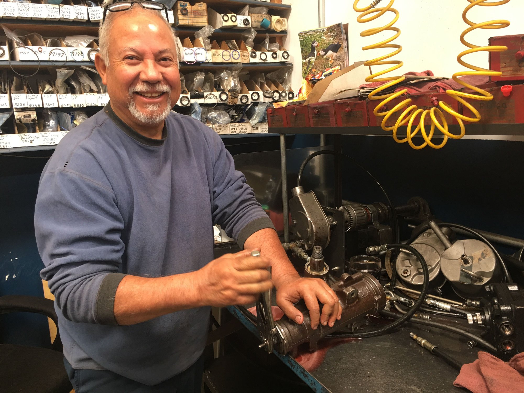

Had to post up a fantastic experience I had last Friday. Saw an episode of Wheeler Dealers where they did a 65 Pontiac GTO. Mike, one of the hosts, took his Saginaw 800 steering box (essentially same as ours) to a shop in Oxnard, CA called Express Parts Exchange. Mike got to be in the shop and watch as their expert rebuilt the entire box from memory.
I decided to go there myself. They said I could be in the shop and watch and I did. I met David, the guy who does the rebuilds. He is a master in every sense of the word. Did my original steering box in 45 mins including a full operation and full pressure test on the bench to prove it works properly and no leaks.
And for only $175.
I had bought an O-ring kit and was ready to tackle the rebuild myself but my spider senses were tingling and decided I better play it safe and let someone else do it. And I was right.
David did have to fish for a seal in other kits, something that would have tripped me up. He finally got the exact correct size and finished the assembly.
He had drifts, punches and pry bars that had been used for 25 years doing the same thing. I would have spent hours figuring out how to remove various parts. He had the whole box disassembled in about 3 minutes.
Assembly was done from memory and watching him set the proper preloads and tolerance was very cool. He just rolled through it.
Best part was the test bench. Hooked it up to a real pump, fired it up and read 500psi to 1,000 psi as he worked it. No leaks, no noise, 100% verified.
Awesome.
http://www.rebuildingfactory.com/
David at the test bench with my original steering box.
