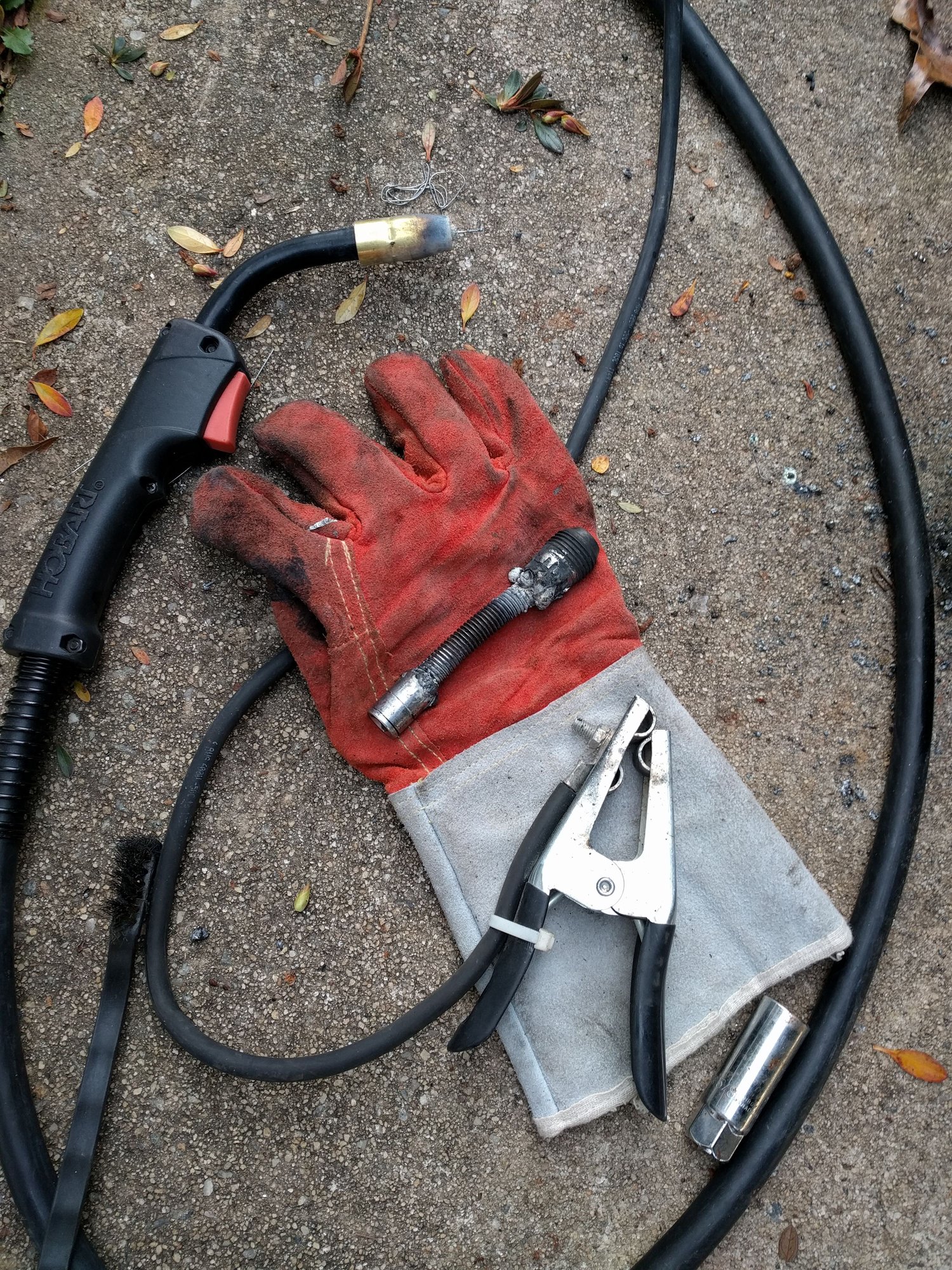

It took me longer than it should of yesterday to get the wheel locks off the donor car ... 2 came off real easy with hammering old undersized sockets on them.. one wheel didn't have one... The other one I had to weld a bolt to the lug... The bolt shaft started to twist before it came loose... Kinkof surprised I didn't break the stud.
