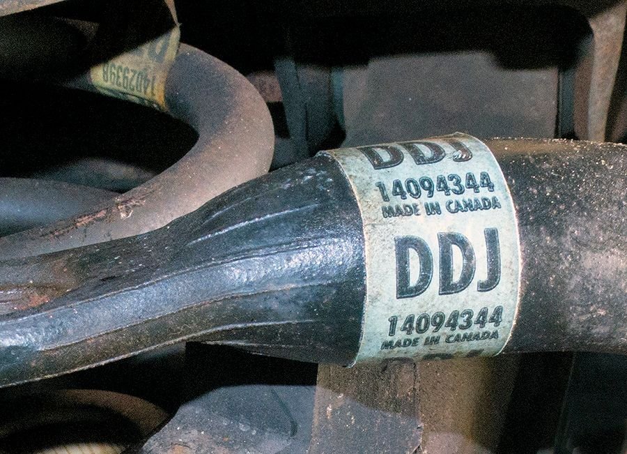

Hello, I want to change my front sway bar bushings and am confused on the size of the W6 swaybar. Does anyone have the dimensions in Millimeters?
Car is 1987 Firebird with W6 suspension.

The bar is … exactly, whatever size it is. Measure it. Take open-end wrenches to it and see which is the smallest that fits. Or, use a Crescent, and measure it.
These bars are spec'ed in mm; yours is likely either 34 or 36mm, but no guarantees. Bushings are mostly spec'ed in inches. Use a SLIGHTLY smaller bushing than your measurement, so it fits tight. Maybe the next 1/16" smaller than whatever you measure. Otherwise it will soon start making a weird banging noise when you go over bumps on only one side of the car, due to the bar being loose in the bushing.

i checked my year and parts catalog along with measuring. HOWEVER. WHERE EXACTLY DOES ONE MEASURE? never seen a post specify this

Measure at the bushing, since that's the part of it you'd be particularly concerned with in this matter. Right next to it is usually OK also, as long as there's no bend or anything right there.

Are all 36mm bars hollow? How do you tell if it is hollow? I tapped on it with a screw driver but that didn't really any clues.

The bushing size needs to match the place the bushings go. Doesn't matter if the rest of the bar is 55mm; if the place where the bushings go is 24mm, then you need 24mm bushings. The rest of it is irrelevant.
For measurement, there's almost always a little bit on one side or the other of each bushing, where the bar rides in the bushing part of the time; you can look for the shiny spot and measure that, without taking anything apart.
The hollow bars have little weep holes on each side.
AFAIK there aren't any 36mm solid bars for our cars, stock; but as always, I could eeeeeeeezily be wrong. (and not only wrong, but mistaken in this particular point) A 36mm solid bar would be HEAVY. Like, piece of railroad track heavy. You wouldn't really want it anyway.
