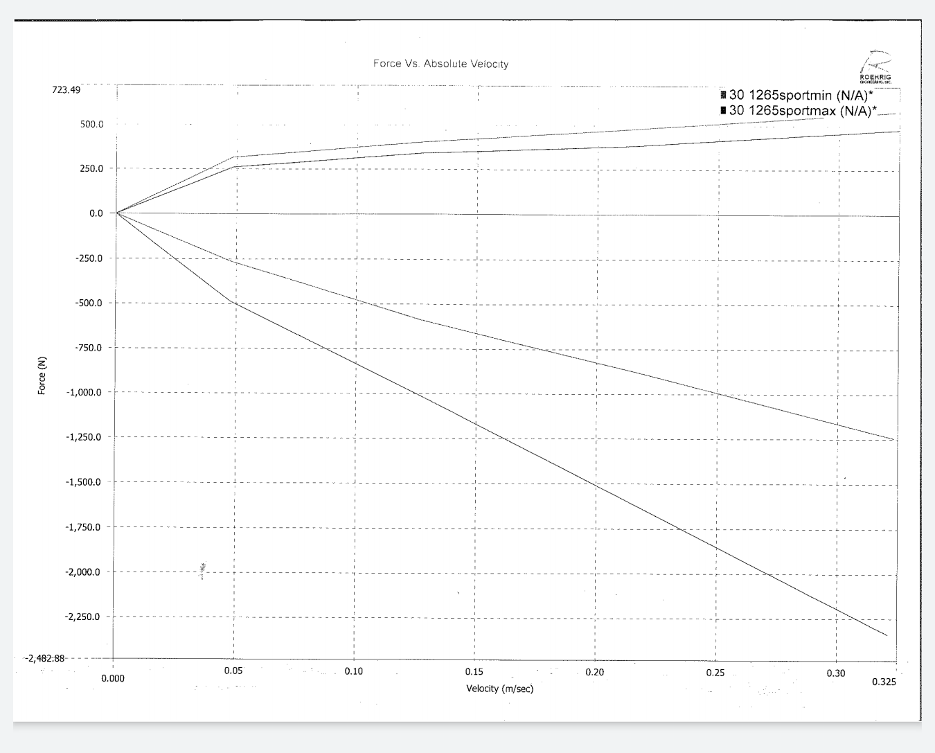

This is honestly why I never Recommend KYB Shocks or struts.
they don't have enough rebound or compression forces for even Stock rate springs for even the V6 cars.
Quality shocks ride pretty well, even if you run insane spring rates like me.(1200lb front, 400lb rear)
Pic is a shock dyno Plot of the 3rd gen rear Koni Yellow.
