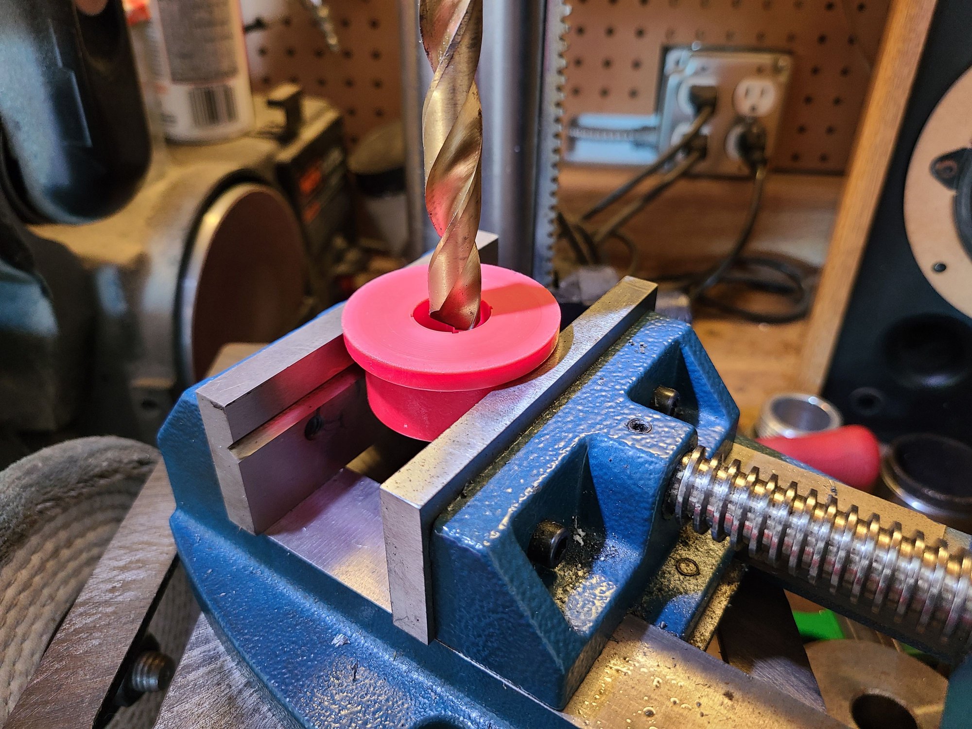

So I currently I have Lakewood square tube rear LCAs with poly bushings. I have been doing autox this season, and have noticing the rear of the car not moving as it should on hard turning, and I suspect this is from the stiff poly/poly bushings.
My thought is this, what if you took out the bushings, and drilled an oversized hole about a third of the way down the ID bore of the bushing from the outside flanged end, so that the inside steel sleeve only contacts the bushing for the inner 2/3 of each bushing? This removed area would be where the greatest forces were previously, and now those forces would be redirected closer to the rotational axis, so the the remaining poly should flex more in twisting. Hopefully this would not result in too mush negative effect and flex in straight line acceleration.
Thoughts? Anyone ever heard of doing anything like this? If I were to try it I would maybe only do it on the rear two bushings first, then if I felt like I needed more do it on the fronts later.

I have a spare set of panhard rod poly bushings I was going to try experimenting on. Not sure if they are the same size as the LCA bushings, but are at least designed similarly. Problem is the ID is about 3/4 inch, so to drill them oversized I'd need a 7/8" or 13/16" bit, which I unfortunately do not have on hand...
My thought was something like this, but of course with a larger sized bit...

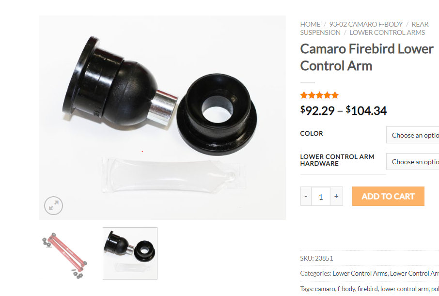

Why not save time and money with these:
I've had these on my car for 5-6 years with excellent results. The spherical poly bushing works well for getting rid of bind when going to a tubular arm. I used the supplied grease when I installed them new, and they have yet to show any signs of squeaking.
"Our Poly-Joint bushing combination incorporates a very hard inner polyurethane ball which is surrounded by soft outer socket cups"
What are the outer socket cups made of? If they're a "softer" poly they still wont allow for full articulation like a rubber or a rod end. If they are poly then it's defeating the purpose, it's just poly bushings with extra steps. This is a good idea but only if the outer cups are rubber.

I am in complete agreement that articulation of the LCA's is critical for a free moving and well handling rear end. I can feel the need for it as I have been getting started in AutoX. I bought these LCA's 15 years ago when I knew nothing... I think it may have gotten lost in the discussion, but I am looking for a temporary solution to allow more articulation to my LCA's, trying to keep the costs to a minimum. I have a much better solution in the pipeline, but it may be a few of months before it becomes available to me.
So far I like two ideas:
This is my favorite solution so far and it's free and easy. I can start with an array of smaller holes, make them larger as necessary. I can also experiment with putting holes at the bushings just at one end vs both ends. Anyone have input on the size and number of holes, or whether it would be best at one end or both? I also wonder how much life this will take out of the bushing, I would hope it would still hold up a few months, maybe a season or two?
Camaro Firebird Lower Control Arm (foundersperformance.com)
This is my second best option. It does seem like a very inexpensive solution, but I still feel stupid buying a whole new set of arms for just a few months. If I could get just the bushings and could confirm they would fit my current arms, that may be a different story depending on the price, thought the price for the whole pair of arms at $92 is not terrible to digest... Can anyone confirm the OD and effective with of these bushings, or the mating tube so I can find out if they fit?
You could call Founders and they may give up that info, or they may not, wouldn't hurt to try
As for how many and how big the distance between the ID and OD is going to dictate that, start with holes at 12, 3, 6 and 9 o'clock then use your best judgment on how big and how many more, start small and work your way up, a large drill bits gonna tear them up, go to big or to many and they will fail.

Tried drilling out my sample peice. Started with 8 - 1/8" holes. I only drilled 5/8" deep from the outside, not through, so the greasing functionality will still work.
Just squeezing it by hand it seems like it may be a little more compliant... holes seem really small though, think I may go up one size more before first test, or should I not?
First set of 1/8" holes, again dont drill through or all your grease will come out...
Drew up this little thing in cad so i could use it as a template, then center punched each hole before moving to the drill press.

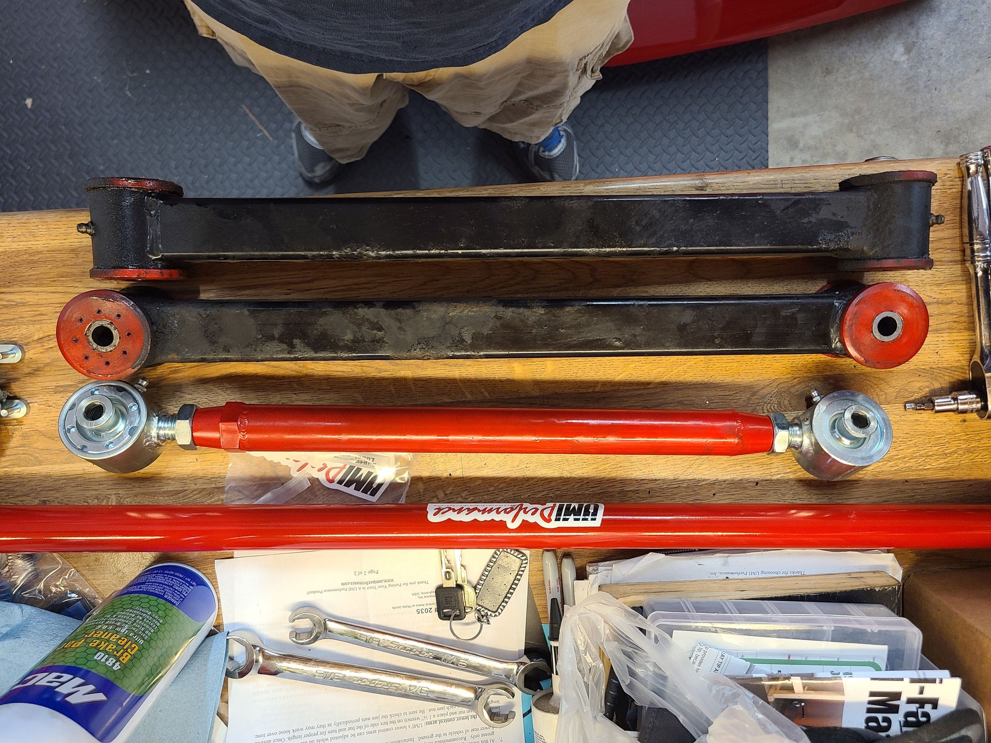

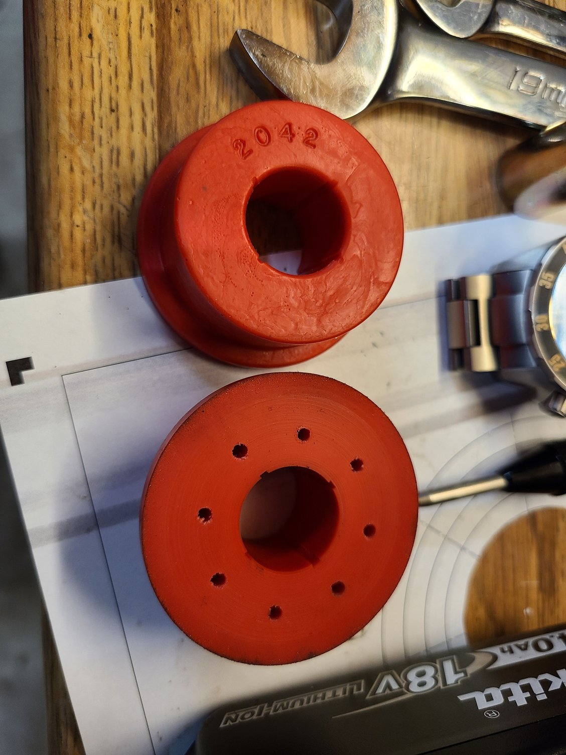

I got started tonight modifying the actual bushings. It turns out the LCA bushings at least in my Lakewood arms, are not the same dimensions as the extra ones I had for my panhard rod. The ID is the same but all other dims are all slightly larger. I'll have to post all the actual dimensions in another post.
I still used my experimental piece as a template. I drilled through it into the actual LCA bushing.
For now I only didn't the rear bushings on the one side. I did go up one size to 9/64" in 8 places equally spaced. I went about 3/4 of the way into the bushing from the outside to keep the grease in place.
I'm a little worried because the portion of the bushing exposed to the elements is starting to get a little crumbly, but the central part seems better... hopefully these hold up...
I'd say, even if this works, it's enough effort that maybe it would have been worth it to just buy something instead of modifying what I have... We'll see...

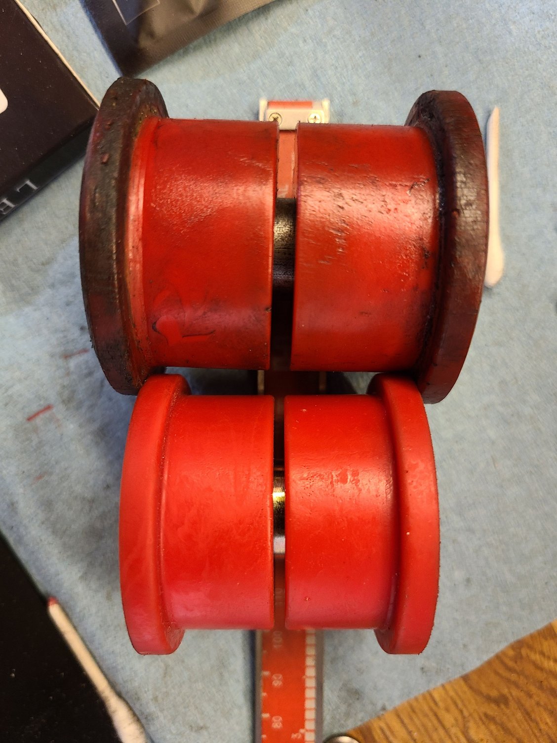

Here are the dimensions of the bushing I removed. I still wonder if they are standardized across aftermarket brands.... I doubt each company is having custom bushings made, and I would love to be able to buy a replacement set as mine have been in the car for over 15 years...

Well what do you know??? They do sell the replacement bearings...
Lakewood 20538 Lakewood Traction Bar Bushings - Red Polyurethane (holley.com)
Problem is they're $40 for 4 and you need 8 for both arms... If its $80 to replace the just the poly bushings and 99 for whole new rust free arms and bushings, I don't think It makes sense to replace bushings... I may see if I can figure out the actual bushing and see if I can buy it elsewhere for cheaper...
And they even give you the detail drawing!
The picture shows bushings that say 2142 on them, but I need to confirm the that is really what they are, or if they're using a generic picture...
UMI actually sells the 2142 bushings for much cheaper, but they do not confirm the dimensions...
Control Arm Bushing 2142 - UMI Performance Inc.

Well I got everything back together. Based on some moderate around town driving, it seems there could be some minor improvement. I have an AutoX race Sunday, so we'll see how it feels when pushed to the max, and I'll report back.
I'll also say, the small amount of grease that was in there was disgusting and brown, I cleaned all that out and lubed everything up with Superlube silicone grease which is translucent white and supposed to be good for poly, then gave it the 2 prescribed pumps once mounted up.
