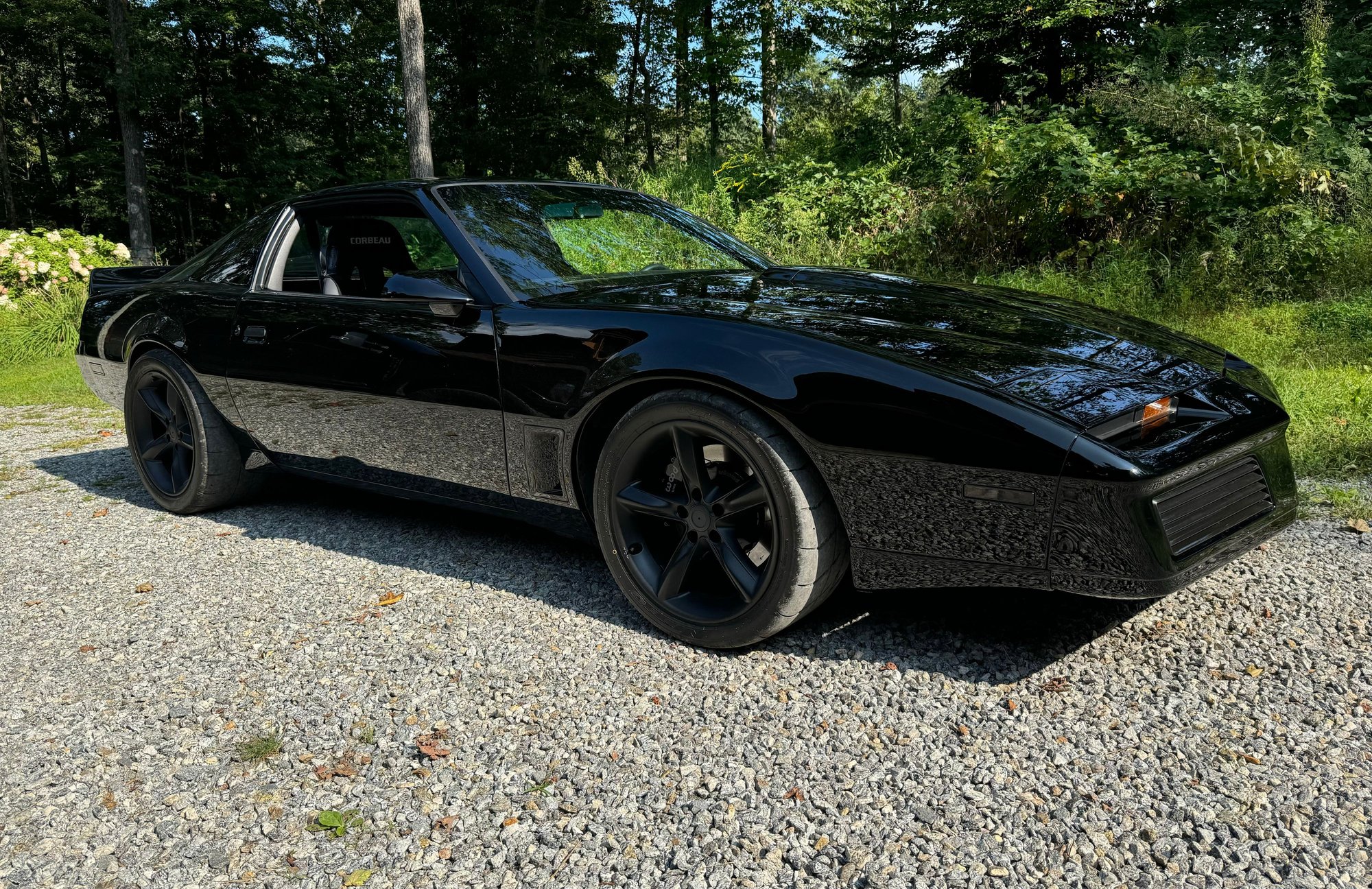

This is how mine sits. The rear weight jacks are as low as possible. The front I'm on the fence w going up 1/2 inch to have a little more travel. I feel like my only complaint is I sometimes am hitting the bump stops up front and the car is pretty low. Like speed bumps are an issue. It drives awesome and handles awesome but needs pretty smooth roads. Yours looks about the same hight as mine. 19s aren't helping but like you said, it was an issue w the stock setup also. What kind of road conditions are you feeling the issue?
that's a really clean 83, very cool.

moi-maxim's Avatar
Joined: May 2011
Posts: 12
Re: weight jack
poor road in quebec
im lowest rear and maybe half front
