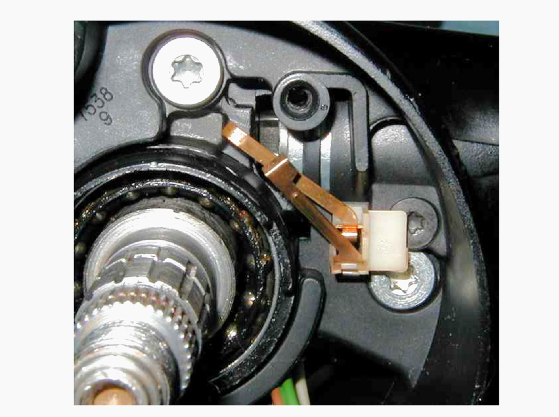

The bearing in the first post looks different than the OE piece. Maybe its just a generic pic.

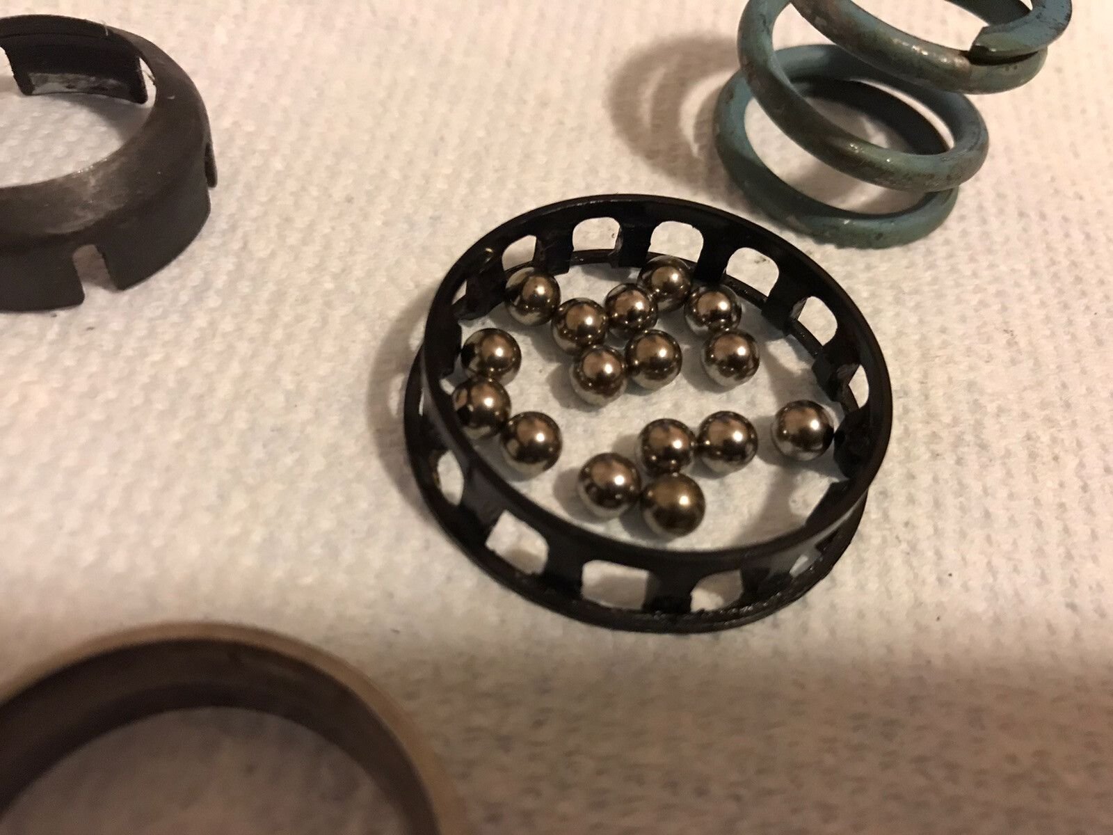

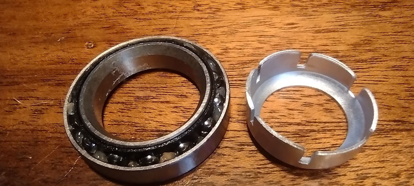

what gets bent is not the actual bearing but the part on the right, it has to fit perfectly in the taper in side the bearing housing(second picture), if it doesn't when you tighten it down it will bend the arms on this part. and then wont allow you to tighten it down to put it in the needed geometry. Can anyone answer my question on what is needed to take the whole bearing off of the steering shaft.The inner bearing comes out(part with the roller bearings in it that is house in the rubber. ) but the outer part is the part I'm concerned about getting out. Do you need a special tool or does it just pop out.
so it will work.

I assure you, "over-tightening" the steering wheel nut did not cause any damage. If anything is out of place, you've got to take up the spring compression before anything will bottom. You can tighten the steering wheel nut enough to strip the threads (people have done it) and the steering wheel will not go on any further. Some ham-fisted mechanic trying to reinstall the lock plate without a compresion tool, sure, that can tear stuff up.
At any rate, there's no reason to replace the outer bearing race... it ain't doing 2500 rpm down the interstate. Just replace the bearing, install the inner race, then install the collar, then the spring, then the lock plate. Then compress the lock plate and install the snap ring. Then remove the lock plate compressor.

Can anyone answer my question on what is needed to take the whole bearing off of the steering shaft.The inner bearing comes out(part with the roller bearings in it that is house in the rubber. ) but the outer part is the part I'm concerned about getting out. Do you need a special tool or does it just pop out. so it will work.
If your asking about the bearing in your pic. It just comes out, maybe with some needle nose plies, but no special tool required. As for the "roller bearing housed in the rubber", not sure what you're talking about there.

I'm assuming the carrier for the ball bearings. Which is some form of nylon, not rubber.

Thanks for the response , I was checking in case I needed a special tool to put the top bearing on the steering shaft . Here is the bearing in the rubber housing

Don't think I've ever seen the nylon type. Only the steel carrier version.

*Sigh*
It's not rubber, lol
