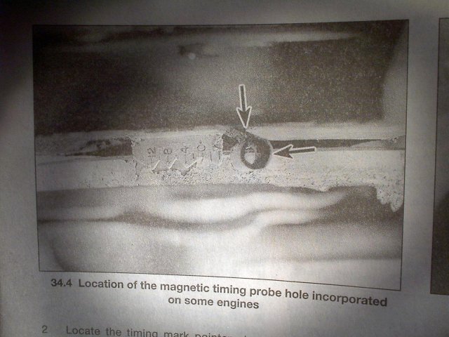

Here's a pic I took from the Hayne's manual, it's the not the best but you can make it out:

Do you turn the distributor while the engine is running?

Yes. I've found it best to loosen the hold down bolt most of the way while the motor is off, then with it on loosen it just enough to let your rotate the distributor. You don't have to turn it very much, just about 1/2 inch either way to get the adjustment right.
I'd recomend buying a Hayne's manual for your car. It's a great tool for finding out how to do little adjustments here and there. General repairs, and such.

Stupid question.....but what is that "magnetic timing probe hole" in the pic..

If I knew I'd probably use it, all of our cars have them, but I have no idea what the hell it does :lala:
There's a "scope" that a mechanic (or technician if you want to be politically correct) uses to check everything as far as the ignition system is concerned. It has a magnetic pick-up that it uses to scan the timing with.
"Insert here"

From the picture above, mine points to 8* is that advance or retard?

ignore it, its not even used unless u have the equipment to use the probe it points wehre it points check ur timing with a light ignore the lil "hole thingy" or the magnetic probe holder whichevre you want to call it.
