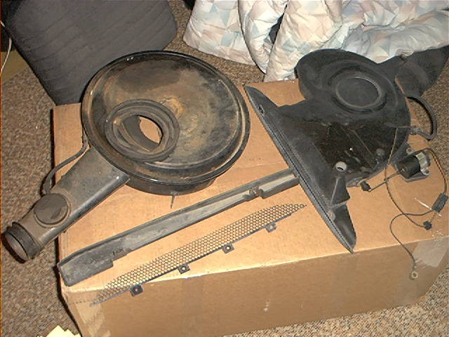

Does the air assembly on an 84 HO T/A have the same dimensions as my 89 Formula? In other words can I just get his lid and use on my assembly to save money on shipping? Also could I put this lid on a shorter element and still use my open element and get the best of both worlds? Any opinions? Im def. getting this set up because even if it doesnt produce much more hp, It'll be cool knowing my hood actually works

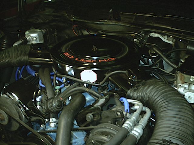

i think i have what your talking about led..i have a 90 formula i bought a cowl set up off of a 84 t/a.i have the cowl set up on my power bulge hood and a single snorkle going into my fender well.i'm not sure which one is getting more air the cowl or the single going to the fender.but i definately see a difference from the open element i had on it

how about some pics of the snorkel going into the fenderwell?Originally posted by FBody90Formula
i haven't taken any pics yet.but i'm planning on it in the next couple days .as soon as i do i'll post them
I have also a question about it, because I don't really understand why the Dual Snorkle setup and the stock cowl induction setup would not work together. I'm talking bout this type of cowlinduction to use with the stock formula hood:
And just instead of using the bottom part with only one Snorkle line, use one like this with the 2:
I mean when the Trans AM had it with the LG4 engine it always had one snorkle to the front, so a second one shouldn't really do any harm.
Or am I wrong? I have a 89 Formula myself and am thinknig about that.
