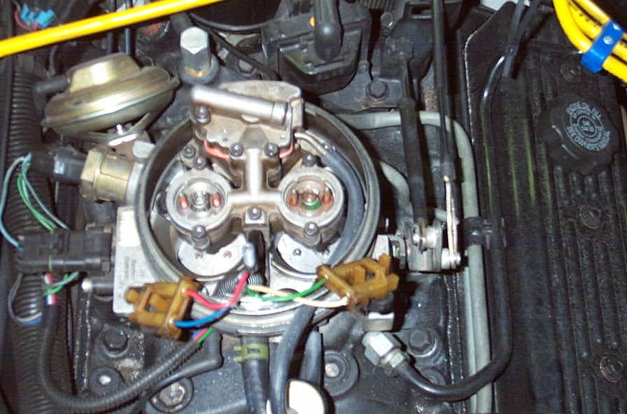

Originally posted by 92rsbowtie
i ordered the whole kit from top down, its coming on wednesday, where did you hook the vacuum line to, and do i need a fp gauge to adjust it?
Adjusting it is "trial and error." Lon will provide you with a refference instructions that state every 2.5 turns from flush if roughly 1 psi. He will tell you how to set it. Here is how I run mine. I plugged the vaccum line to where I capped off the therman device.

is it nessecary to run the line through the tbi unit, is that how im gonna have to run it?
Ha I knew that was going to be your next question. I take a lot of heat from others because of my precise routing It is not as easy as you think to route it out of the way. The vacuun line is stiff and is not easy to work with. Also, you have to contend with the open element, spacer ring (if equiped), and the long vacuum main comming out of the regulator (I alread bent it to better accomodate). I have been too lazy to redirect it in another mannor.

how can i bend the main without crimping it
This is something you have to be very carefull with. If you go to much you will kink the wall of the regulator before the line bends. So, remember that the wall is the week link here. Use a pair of pliars and go really slow. You may want to heat it up as you goto make it a little more plyable. You do not have to move it far. It also helps to cut some of the length down.

I used a straight piece of slightly larger diameter tubing over the end of the tube to be bent, kind of like a mini "cheater-bar". As SC mentions be carefull. I held the short straight portion with a long nose plier as I un-bent the fitting.
Some people just cut the fitting shorter beyond the bend. I routed my vac line as shown. I drileld a hole and used a 1/4" drive socket and handle to bend the hole in the spacer so the vac line conforms to the wall as flush as possible.
