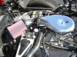

Will the 4" tall plenum fit under a stock camaro hood?

Looks like it will easily. Now, I need to plumb a duct from the plenum to the tpi air box and relocate the IAT sensor.

New pictures
I do not have any vehicle results yet, but I show later this week after I fabricate my new belt tensioner.

Well, I wanted to use tubing that would match well with the tpi box, so I chose 3". With these adapters, the path of the air looks to be relatively smooth as their is not many changes in diameter.
I remember reading somewhere on this site, that the tpi air box did not show to be a restriction until 320 - 350 hp. However, if anyone could put any flow data on it, that would be appreciated.
This picture is clearer and shows the modified belt tensioner.
