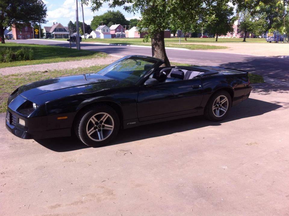

Pic of the car. I put my iroc wheels from my other car on it. I felt funny bolting drag radials to a bone stock 305....

Looks like a nice ride Grover!
