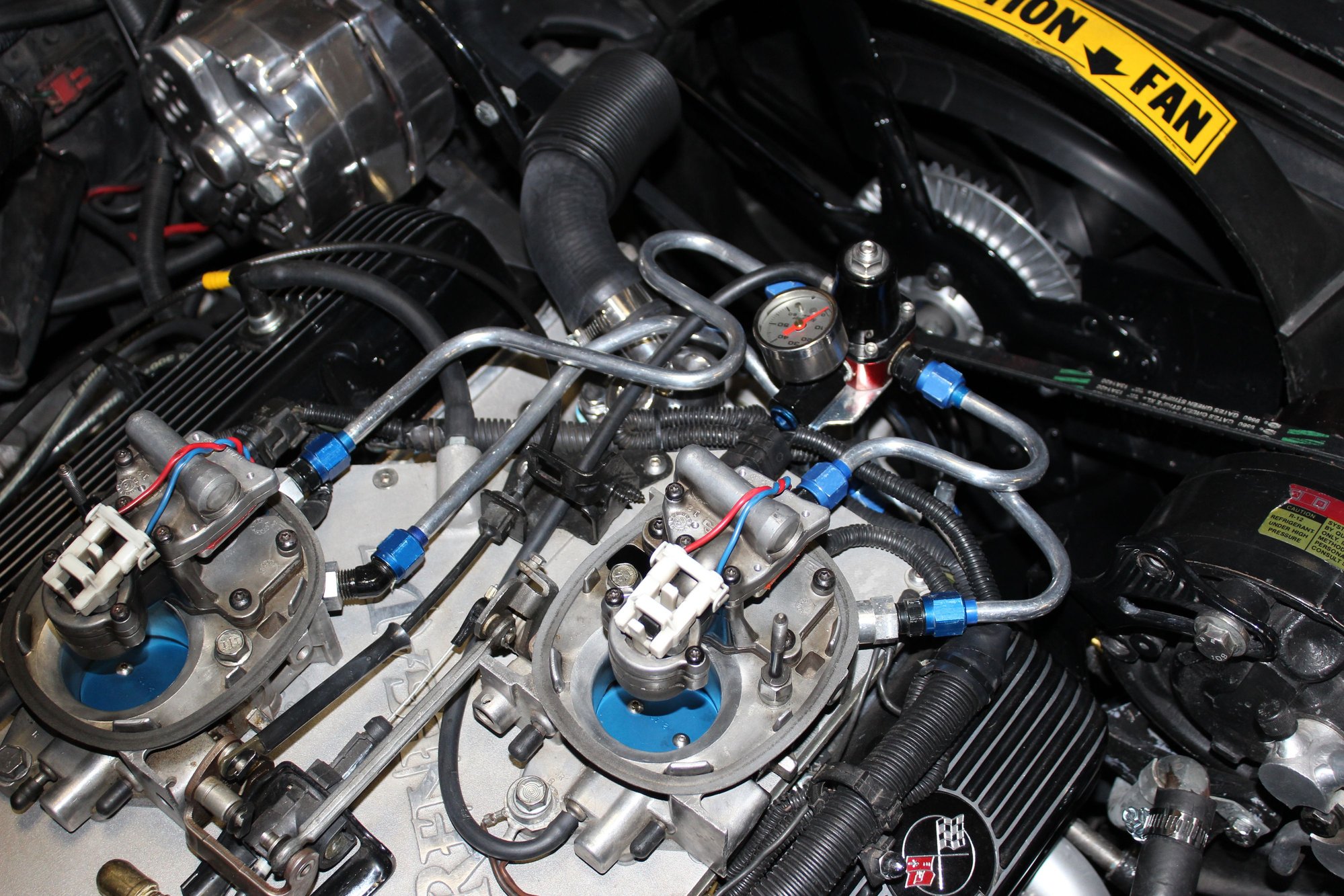

I personally have already started a project for my motor going to an EFI setup while still using the Renegade as a manifold which will benefit the guys that don't want CFI anymore and still improve the drive-ability of a big motor car. As far as fuel lines go, on my 383 motor. I use custom TB fittings that my machinist made for me which still allows me to run 3/8 AN -6 fittings on everything vs. the sometimes problematic TB 45* flare nuts. The return line is 3/8 as well, but necked down the inside diameter coming out of TB to what a stock return line would be while still allowing me to run a 3/8 -6 at the output tube side. It works just fine for my motor, not so sure this would work for a 427 though, but maybe just going straight 3/8 would be better. I plan on offering these fittings on my site at some time soon just in-case anybody is interested.
My whole idea on what we have done was to make as many mods as possible to my motor to make it perform the way I wanted it to and still have everything fit under the stock hood and air cleaner for a neat stock looking package, both 82 and 84 corvette and any 3rd Gen. I think we have succeeded in that area, both in fitment and performance. I totally get your desire to have that "stock" look and that was my goal as well.
Here is a pic of what I did for the fittings... Enjoy!

Thanks for picture of your engine. CLEAN! no clutter. It is interesting how you did the fuel fittings and fuel line bends. I'll save the pict for future reference. Thanks.
