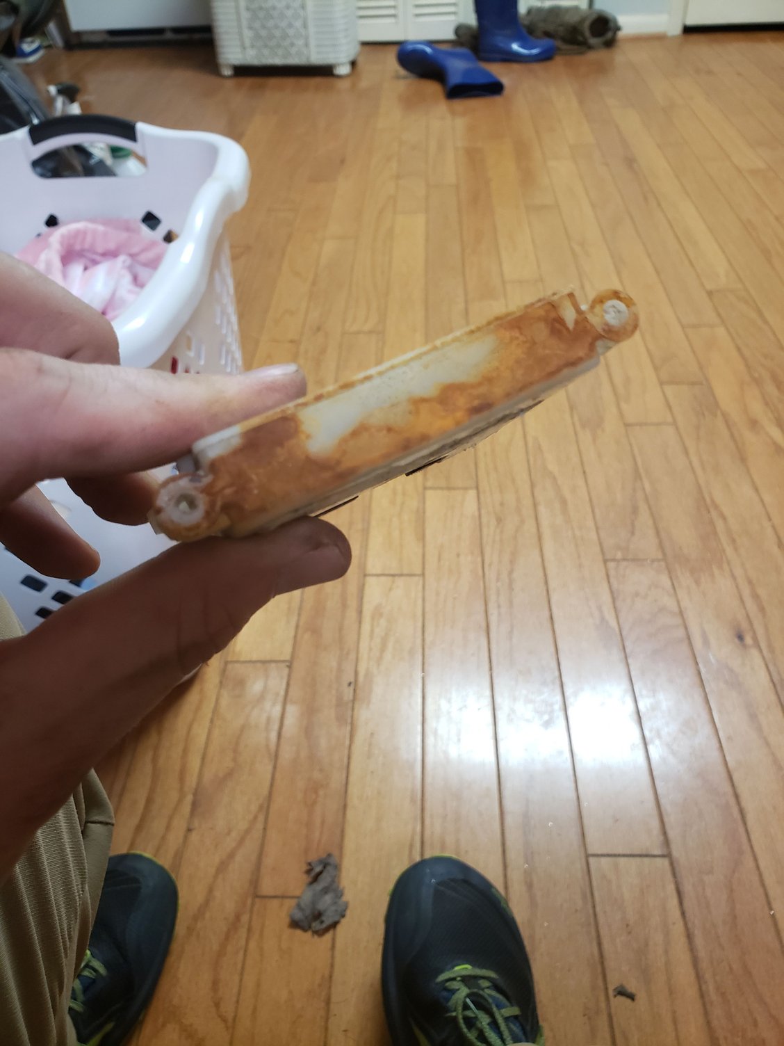

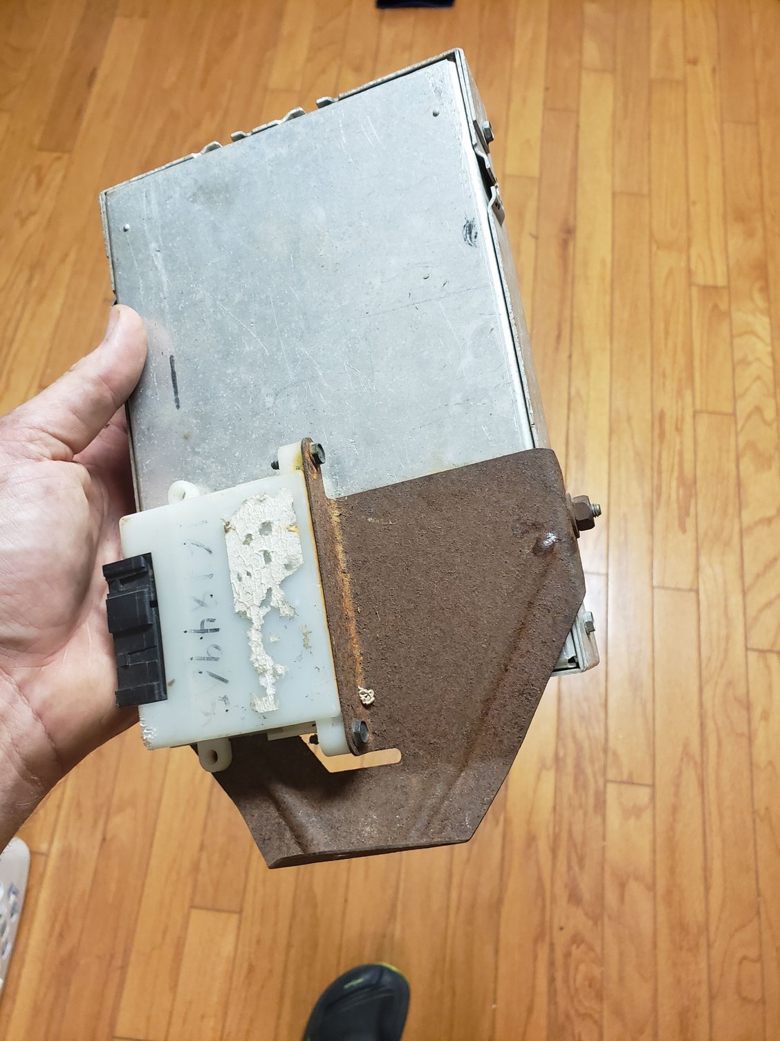

Hey everyon . I chasing a gremlin on a 92 RS V8 car. It's not wanting to idle and throwing a code 15. Its exhibits all the standard behavior of a code 15. Wont idle, runs rough etc. Well while chasing it the car decided it didnt want to throttle up. When you push the throttle it chokes and struggles to rev up. That's a new problem. So I've changed both the sensor and the plug itself. I've chased the wires and I cant find anything. I've checked grounds for the ECM, they look fine too. So now I'm curious if my ecm is bad. So I pulled it out and looked at it while checking the wires there. And it looks rough. I hate to just toss parts but I dont have a datalogging cabl . Here is some pictures, it clearly has gotten wet. If you look at the speedometer board on the outside of the ecm, its clearly gotten wet. What does the community think? Extra info, the speedometer doesnt work but the output shaft inside the transmission that interacts with the VSS at the transmission is MIA. I'll have to get into that at another time. Right now I'm trying to get her running right.
Outside of the wee devil. The bracket is awful rusty
Inside the ECM. Lots of crud around the ports.
One side of the speedometer boards casing.
Other side.

Interesting. Check the ECM harness connector pins. See if any, including the CTS input (pin C10) is corroded. It may also be a bad terminal in the harness connector (C10, yellow).
As for the ECM, not even close to being correct for a '92 RS. That ECM is an '8062 truck ECM with a DRAC attached to it.
A '92 RS should have a '8746 ECM in a slide mount, and no DRAC. With a separate 4-out buffer box mounted under the dash.

. So the mystery continues. I know the car has had an engine swap . I checked the numbers on the block, it's a chevy 305 tbi engine. I assume the wiring harness is the one the car came with, but now I have no idea. Would all the plugs be the same, I know chevy put alot of the same parts in different vehicles. I guess first thing is check those pins and get the proper ecm. Thanks for the info.
